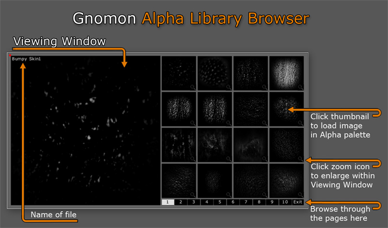

Using The Gnomon Alpha Library Browser
:large_orange_diamond: In the ZScript palette press Load. Navigate to where the ZScript is and press enter.
If everything was executed properly, a new Gnomon Alpha Library button will be added to the ZPlugin palette.
:large_orange_diamond: Open the ZPlug-in palette and press the button named Gnomon Alpha Library.
:large_orange_diamond: Click the thumbnail to load the alpha into your Alpha palette
:large_orange_diamond: Click the zoom icon to view the alpha in the Viewer Window.
:large_orange_diamond: Use the page numbers to see the rest of the alpha library! :slight_smile:

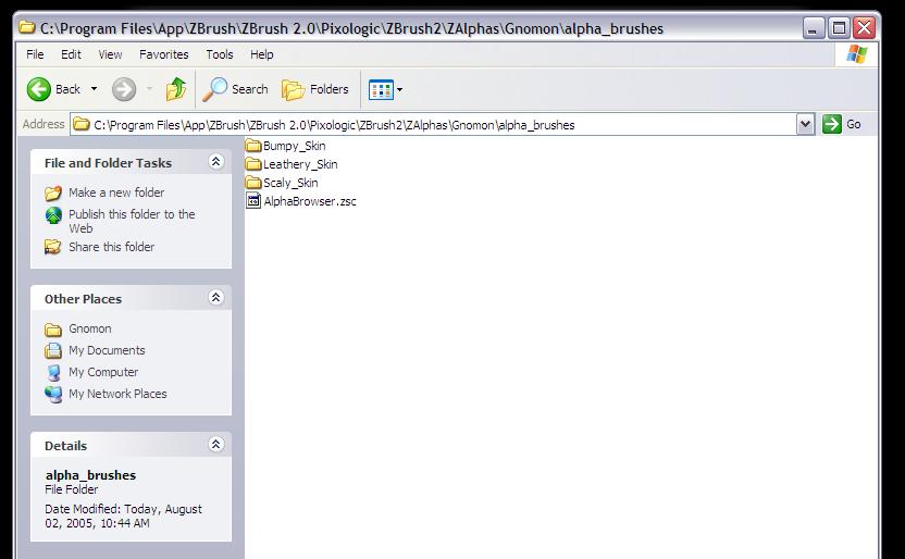

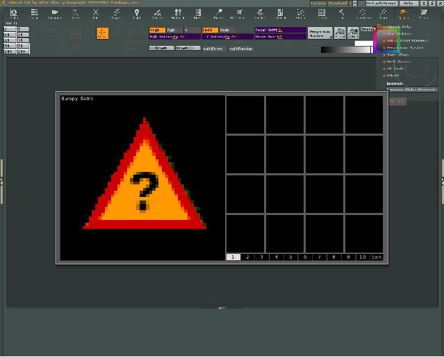

Ok. Not sure what is wrong. I followed the instructions (simple enough) but when I try to run the script and plugin I get this:
It is not autoloading the alphas (is it supposed to?) and when I click on the button to do it manually it gives me an error (can’t find the item).

Your folders shouldn’t have the underscore. Just name them ‘Bumpy Skin’ etc. with a space. Likewise, the file names, except for the Scaly Skin ones which SHOULD have the underscore before the number thus: Scaly Skin_1.psd .

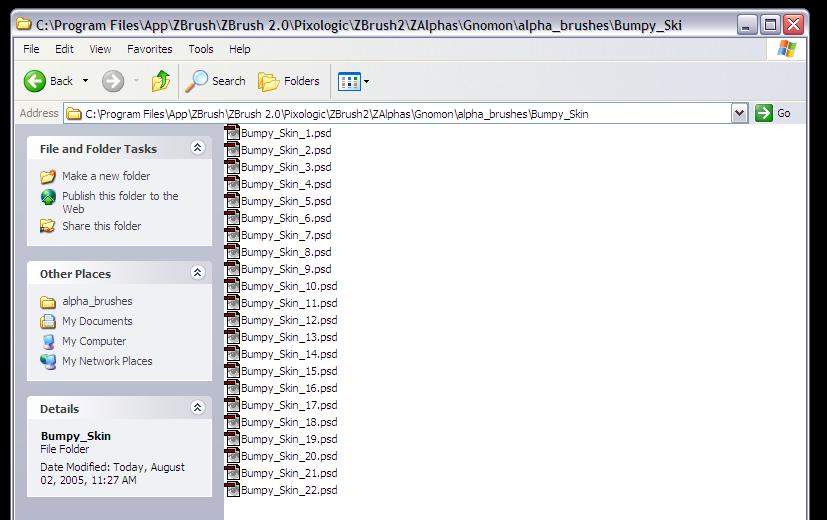

I copied the files directly from the Gnomon DVD. They ALL have underscores. I am not going to manually rename them just to get them to work with this thing. There are 157 alpha files in those folders!!! It would have been nice had there been a clearer explanation of what had to be done beforehand to get this to actually work.
Let me explain once again:
I copied the Gnomon alpha folder from the Gnomon DVD to my alpah folder in my ZB directory. I followed the steps outlined by the script installation instructions. It doesn’t work. All the alphas have underscores. All three folders have underscores. That is the way they were on the DVD.
Mentat, he said the .psd’s should have the underscores. It’s only the 3 file folders you need to rename I believe.
And if I am wrong there is a Zscript somewhere in here that batch renames files all in one stroke. So it’s not going to be that big of a deal no matter what the case turns out to be. Good luck.
But really I think all you need to do is remove the underscore from the 3 folders.
Ah, I misunderstood. I thought you were trying out the script as per my instructions. If you’ve done as per Ryan’s instructions then it looks as though the script doesn’t work as it should. :frowning:
Try renaming the folders. The Scaly Skin alphas will work at least.
