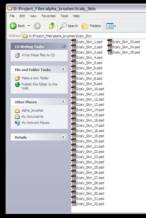

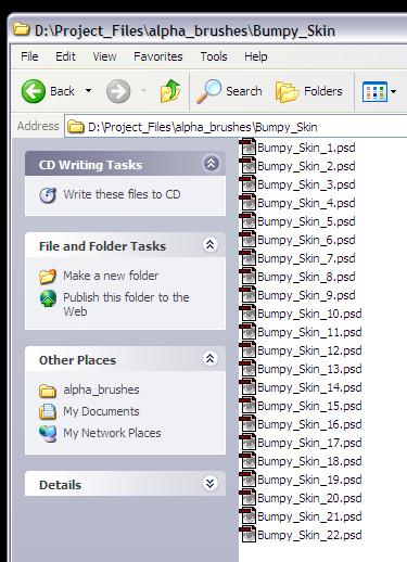

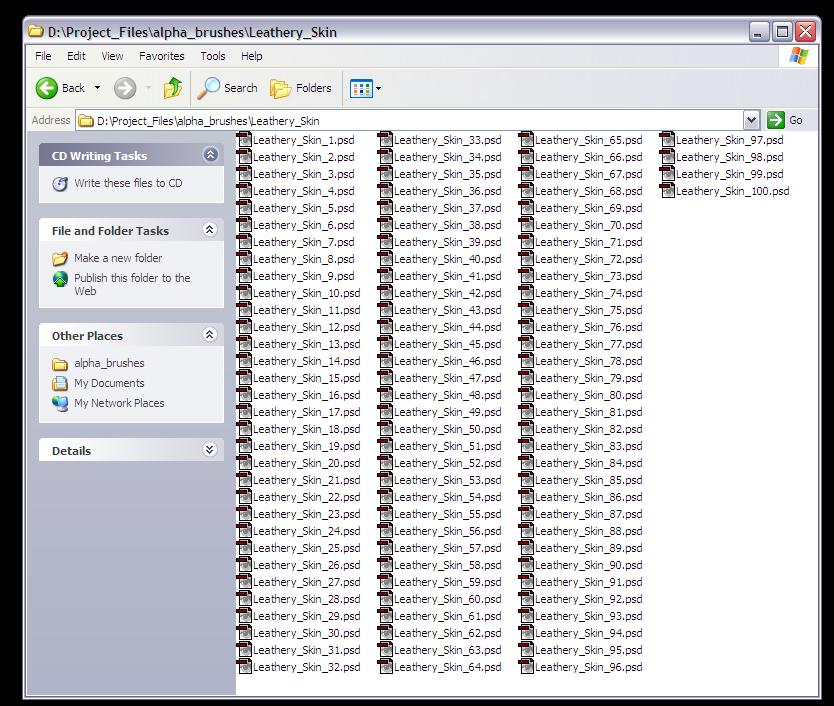

Here are pics of all the file names/directories:
Note that this is directly off the DVD and this is how they appear on my hard drive. I renamed the folders per your instructions on my HD.

Thanks for the pics. :slight_smile: OK, I see the problem. I’ve updated the script and posted the update in my post above. Follow the instructions and all should be well.

I also renamed all the files as described here and it also worked for me - except for the ‘Scaly Skin’ directory. Any idea why the other 2 directories will load without a problem while the ‘scaly skin’ files will not? Exactly the same re-naming prodedure was performed on all the files.
I should have highlighted it in my earlier post but the Scaly Skin files need an underscore before the number, thus:
Scaly Skin_1.psd
Scaly Skin_2.psd
etc.

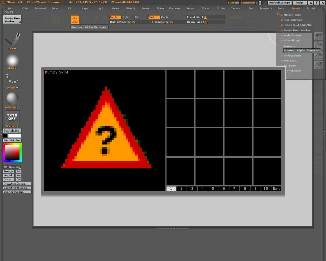

But… I am getting the same image as Mentat did on page 1. No thumbnails or zoom icon and that :warning: sign in the viewer. Funny thing is only Bumpy Skin1 will work but I have to reload everytime I re-start zbrush. I did dowload & installed your update.

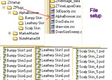

I’ve included a small pic so that you can see the file setup and hopefully give me pointers as to what is going wrong? I would love to use this plug-in!
wenna,
You shouldn’t have the folder named ‘AlphaBrowser’ if you’re using the browser as a plugin. Your ZPlugs folder should look like this:
AlphaBrowser.zsc
Bumpy Skin (folder)
Leathery Skin (folder)
Scaly Skin (folder)
That should work!

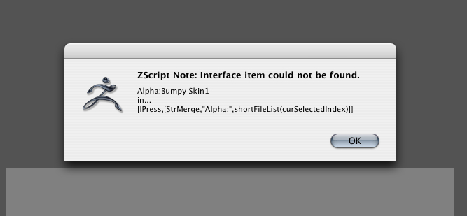

i havent been able to get the library to load, i just get the big yellow triangle.
I tried renaming a file, but i just get 1 alpha in my alpha palette. Not in the gnomon alpha browers. Havnet figured out how to get the alpha converter to work, and rename, any infantly basic instructions?, im missing somthing.
Also is there a way to have the alpha browser always load? saving the congif didnt do it. -ken
