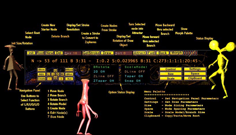

While we wait for the new Zbrush and the opening of the holy Zscript Grail hopefully you will find some use for the new Zif Click Beta.
[Showantell.JPG]
Zif Click, will let you Point and click new zsphere nodes, or draw them with a brush. It will also enable you to copy part of your model and then replicate it anywhere else, even onto another separate model. Zif Click will allow you to work with Branches of the Zsphere Tree, which means the node that you have selected and any associated Children of that node. You can Copy, Move, Rotate, Delete, Transverse or Scale that Branch independently of the rest of the model. Zif Click will also let you change the Root Node of your object. Control the Membrane, Twist and XYZ Resolution of nodes or Branches of nodes with a click of a buton or menu.
       You will be able to precisely Scale,            Space, Rotate and Move individual Nodes or Branches of nodes. This is            very difficult to achieve with precision when creating Zsphere models            by hand.

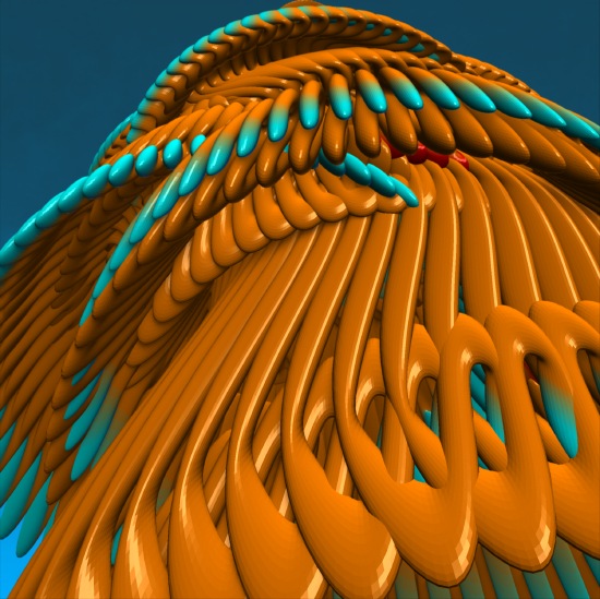

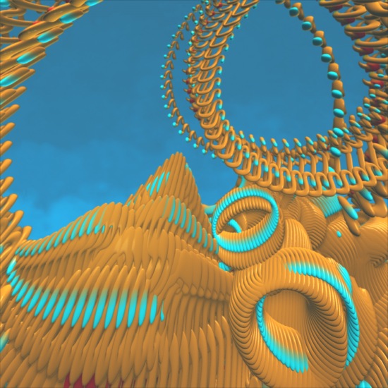

:+1: :+1: :+1: squared. i just wanted to let you know that its smooth runnings for zifclckbeta on the mac-osx + Z2, except the odd occurance here and there - nothing as severe like switching into demo-mode as it has happened frequently back with zbrush 1.55 and pre-X-os, mind you. thats what happens nowadays: the script is peacefully quitting, usually when files get huge only. some dialogue is asking for the .txt-version. no prob to save the tool and start reworking in an overall new session, though. plus: i couldnt manage to succesfully make the script one of the startup-plugins. i assume its a zipping issue, like the one that occured for some users with the ZTimeLapse-script for mac, which was resolved by uploading a .sit instead of a .zip-file containing the script and folder.
so, zifclicking for me is muchissimo fun, even more so as its more comfortable than ever. nevertheless, after all those zifclickless months, i had to start from nihil, so first results arent elaborate at all (more accid- than experim-ents :slight_smile: ):
[attach=6975]1a.jpg[/attach] [attach=6979]1bkl.jpg[/attach] [attach=7015]spiraltreeakl.jpg[/attach]

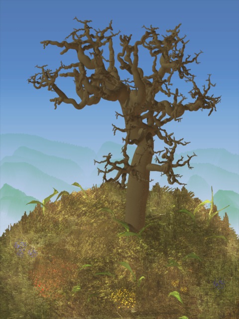

and as it happens a silly tree with too fat roots instead of branches:
[attach=6978]mountaintreekl.jpg[/attach]
more coming asap :slight_smile:
