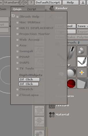

Something weird is happening for me with the plug-in… not sure if it’s me or the script. Here’s what I get after launching ZifClick using the Zplugs button: a second, shorter button appears in the Zplugs menu.

Hi Sven, ah! The second button is made by the script, I will have to fix that, thanks for the heads up.

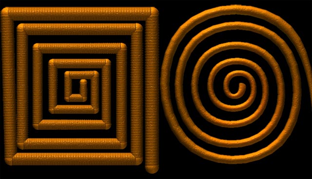

I have attached a easy method of doing a flat spiral, by clicking new nodes in an every enlarging box.
Use this method with ZTaper set on and the script will increase or decrease the Z value automatically giving you more of a Cone type spiral. Play with different values of the ZIncr setting in the “Settings” Menu to increase or decrease the effect.

  1. Start off, press “NEW” to create a root sphere on the canvas
  2. hover the mouse close to where your sphere is and press “Shift d” to create a new child node on the canvas where your mouse is at.
By Default and unless you change the settings Zif Click has a Snap to Grid feature that will make every new node align itself with the nearest Grid intersection. The default value is 10 pixels. This will help you create straight rows.
  1. Keep “Shift d” [color=DimGray]ing new spheres going around and around your start sphere. If you need to adjust or fine tune the placement of the nodes you can select the “Move” setting and use the Arrow buttons to adjust them.

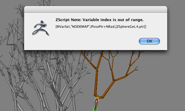

Tried ZifClick! It’s a great script!! But half way the branches it stops (see my post before). So the other branches I had to do without copy and pasting. Is there a limit?javascript:zb_insimg(‘7129’,‘ZifClickTree.jpg’,1,0)
thats one wonderful zspheretree, Bas! :+1: :+1: :+1: of how many zspheres does it consist?
as for your limitation question: i dont know :smiley: in the past i have created zifclicktools of at least 800+ zspheres without a problem. but after reading these considerations by Bonecradle and sshark i gave it a quick try by storing a twisted stroke and setting the number of zspheres to be drawn to a single rootsphere to 250. this seemed to work (well, i didnt count the zspheres manuallly). when i tried to apply the same stroke with 300+ zspheres, zifclick quit (and, if i remeber correctly, even the almighty stable Z2 got a bit confused). this, of course might be due to me being too optimistic to be able to assign that many zspheres to the stroke i had done. however, in the thread in question Bonecradle comes up with a possible workaround by assigning a different "root"sphere, so this might help you to complete your tree in another session.

Thanks Bas for the feedback. Zif Click should work with a model of 1024 nodes but currently a single branch of nodes can only have 50 children. This might be your problem perhaps. I will do some tests, I think I have an idea that will eliminate that limitation, stay tuned.
