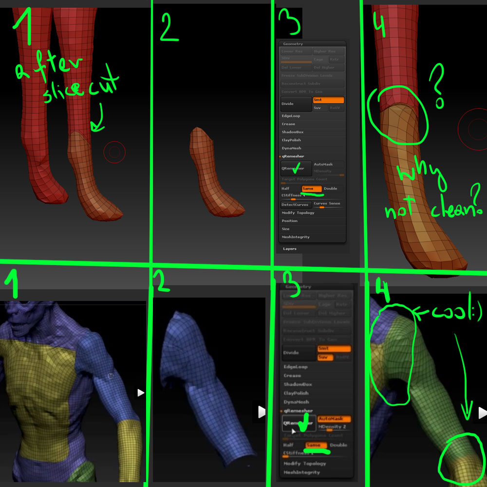

hi Michael,
I watched that tutorial and it’s great. The tools you show are exectly what I need, but I have problem with clear connections after using qremesher. In my tests on dog tool when I cut leg slicecut and setup “same” for the same numbers of polygons and just hit qremesher, there show conncetion. But that connection is thin and like extrude into model.
Anybody know where is the problem? I add here some pic, I know I don’t select automask, but even with that there are still that problems.
