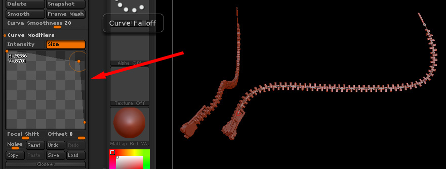

I need to build a decorative bead around a piece of armor. I have made the bead but I would like to keep the string of beads the same size for most of the curves length but would like to taper it toward the end. much like the ‘tentacle’ in your tutorials but not a constant taper.
is there a way to insert a maker of point on the curve to start the taper other than from the start point?
For sure, if I’m understanding the question correctly, make your curve like the one in the attached image to have a taper that isn’t gradual (and if you want it to taper from the other side, drag the curve points from the bottom to the top and vice versa on the opposite side). Remember you can grab the orange circles around any point and pull them in / widen them out to sharpen / soften the curves. You can also add more points to the curve by clicking on the curve, or delete points from the curve by clicking on the point and dragging it out of the curve window.

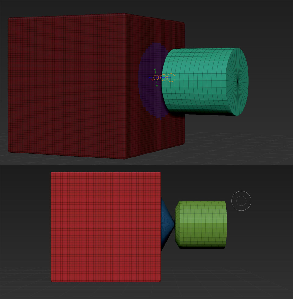

Here’s one last question though. Does the mesh you are inserting have to have a hole in it in order for it to connect to your original mesh in a sensible way? Because when I try to insert a cube or a cylinder it connects it in a pretty weird and unhelpful way. The only thing I could think is that it doesn’t know how to connect it logically since there isn’t a hole in it it doesn’t know where to make the connections.
It just uses the new polygroup you create as its joining location… maybe fiddle with that selection for the best attachement?
Well I’ve been fiddling but it still doesn’t seem to be working the way it was in Michael’s video. Here is a picture of what I mean.
Two very simple shapes but it just doesn’t seem like it should be inserting the mesh that way. Am I missing something?
ah; instead of using a cylinder, use the Hcylinder insert mesh–when using this method, your insert mesh needs one (and only one!) hole on it. Drag that out on your polygroup, then ctl-drag twice; it should interpolate the geo correctly. turn off the geometry > smt modifier to have a “harder” transition.
Ah ha! That worked. So it does need to have a hole in it to connect correctly. That’s exactly what I needed to know. Thanks!
Yeah, does the mesh you are inserting have an open end? What you are getting is the imperfect hole at the pole of a closed cylinder. Use the HR cylinder insert brush, click on the new polygroup of your base shape and draw out the open ended cylinder on that group, cntrl swipe, cntrl swipe and bob’s yer uncle.
