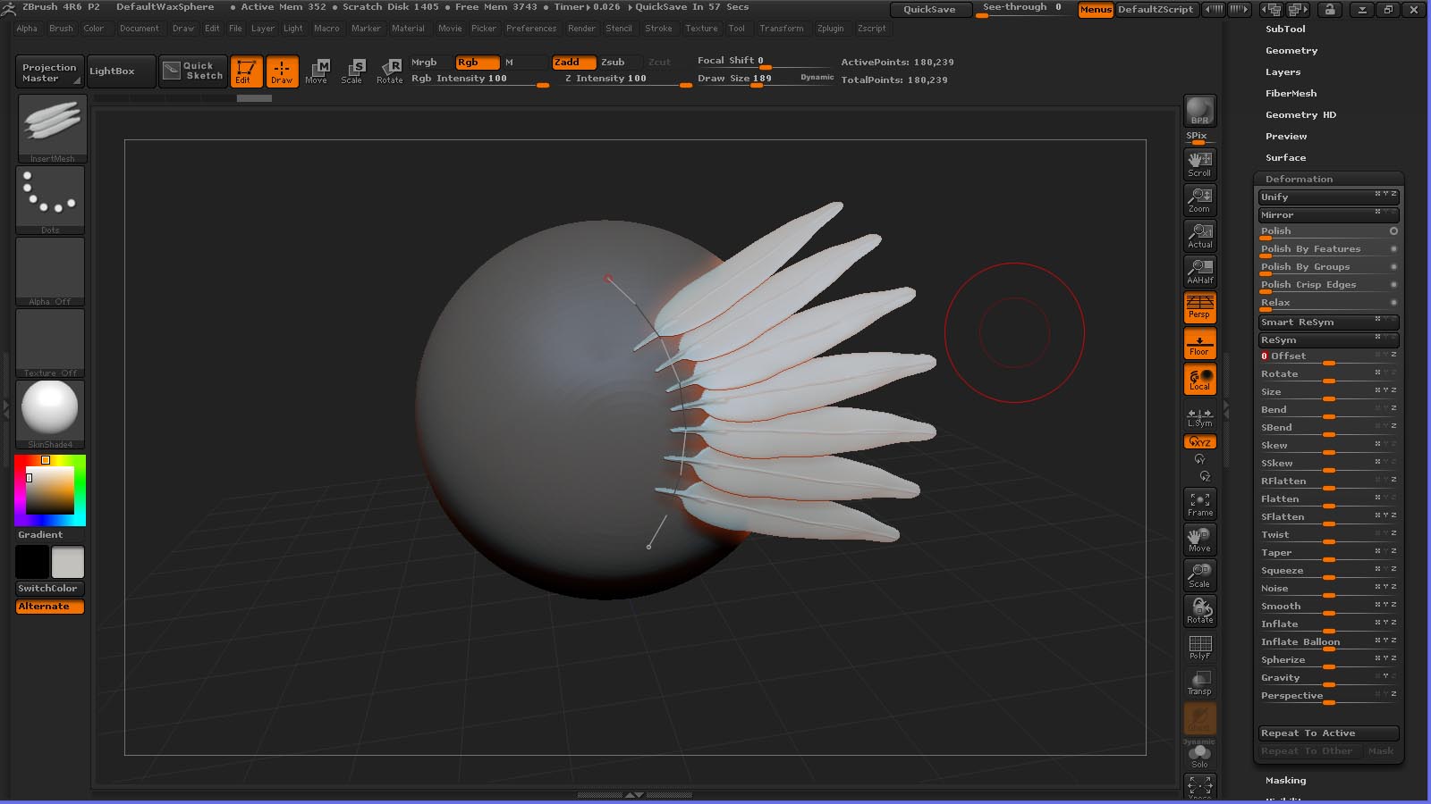

I am looking to make a feathers Curve Insert Mesh brush, I am part way there, but the brush that I have anchors each feather on to the curve by the middle of the object and I would like it if this could be anchored by the root of the feather - is there a way to achieve this? Thanks for any answers.
http://docs.pixologic.com/user-guide/3d-modeling/sculpting/sculpting-brushes/insert-mesh/creating-imms/ See creating.
Thanks for the prompt reply - I can see how to change the orientation, but not the “anchor point”, it seems to always select the centre of the object, which in many cases would be fine, but for this case an anchor point near the end of the object (on the “root” of the feather) is what I would ideally like.
Another really basic question (sorry!) - if I draw a curve and then want to draw another curve, how do I “fix” the first curve, as the default behaviour seems to be that the new curve replaces the previous one.
See step 1, orientation. Z Depth (in draw) will control how far into mesh. Click on mesh away from first curve. Or in stroke pallette, select delete.
Thanks for the help, I knew there had to be an easy way to start a new curve, I just couldn’t find it!

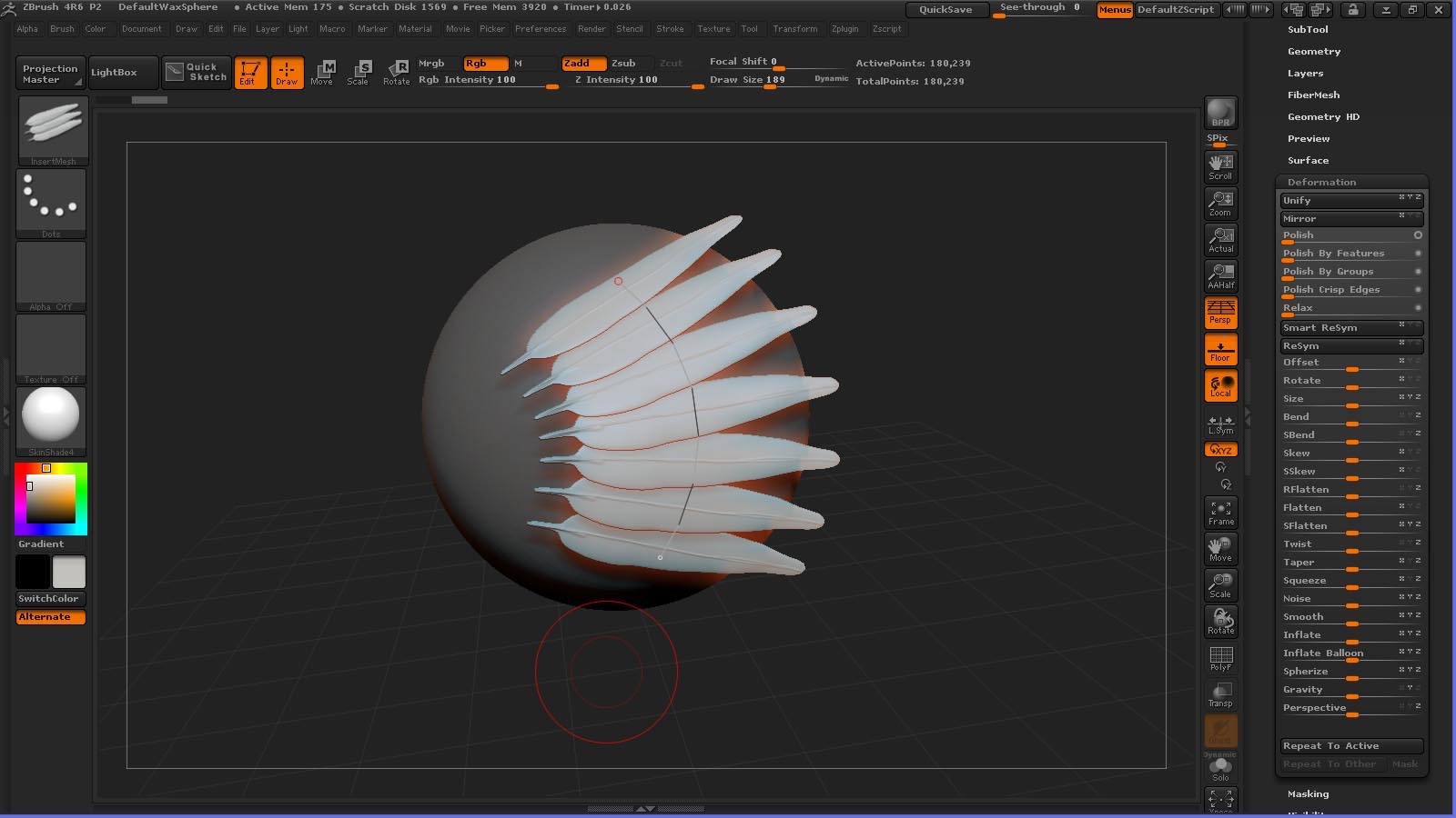

On the feathers, your suggestion would work if the feathers stuck out perpendicular to the surface, but I’m trying to get them lying more or less along the surface - the first image shows how they are now, the second how I would like it to be. Maybe I’ll just have to Offset each row after I draw them in.

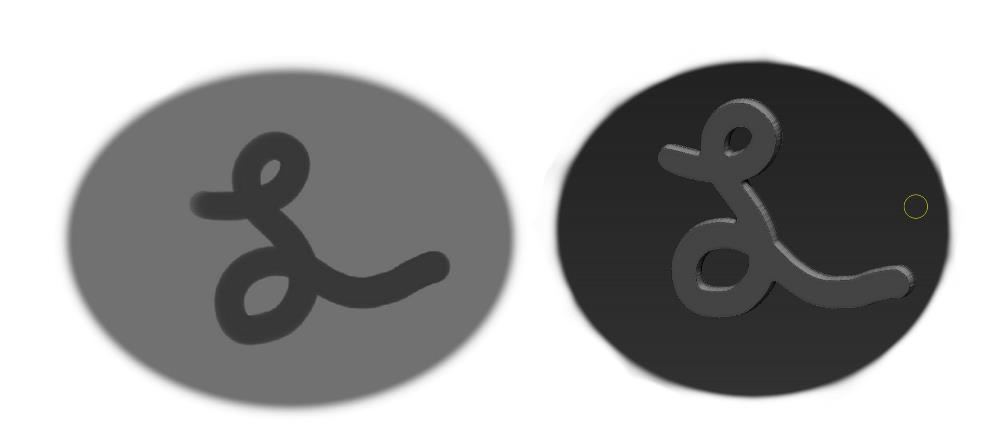

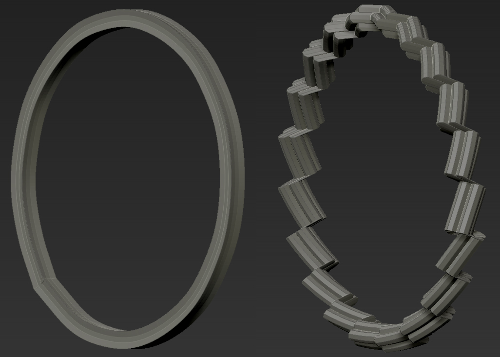

I was wondering why is it when I set up a multimesh insert brush to be used with a curve it does what you see on the right? Yet when I take the exact same profile mesh and turn it into it’s own brush all by itself it works just fine? I set up each mesh exactly the same before I turn it into a multimesh insert as the one by it self. For example the picture below. The one on the right is part of a multimesh insert and the one on the left is it’s own brush. Both are from the same set of geometry but the only difference is one is it’s own brush and the other is part of a multimesh set.

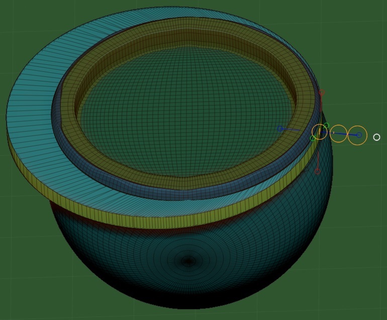

I am working through Michael’s first Transform video and can’t Inflate the ring using the W-Transform feature. The image below shows the problem. I attache the transform brush to the ring polygroup, I pull on the inner red circle of the outer pull handle. The ring inflates but not symmetrically. It inflates away from the brush attachment point. I have tried all ctrl, shift, alt, left and right mouse button, and stylus picks. I can get different effects but I can not get a symmetrical from center inflation.
What am I doing wrong?
W is move. R is rotate and S is scale. Try masking the part you don’t want to inflate and use the Deformation Inflate feature?
Hey Doug thanks for the tip. That worked but seems to be a work around to the instructions given in MPs tutorial. In Part 1 of the Transpose videos, within the Digital Sculpting section of the Home Room, MP shows how to Inflate by isolating an edge loop, selecting it with the move brush (W), and then pulling out on the brushes outer red circle. In the video what he does with the transpose tool works just like what you are suggesting with the Deformation/Inflate slider.

Watch the status bar while you are on various parts of the transpose line. All dots are not created equal. :wink:
That was the solution!
Watching the status bare was a great tip. I had never noticed that before. I’ve looked for it but never seen it. Probably because in other CAD packages you declare what you are going to do before you do it and then get an instruction. In ZB all you do is select what you are going to affect.
The odd thing is now that I can do this, it isn’t working on a second inflate. On the second inflate the diameter gets larger but so does the face height. It is like the horizontal face is un-masked too. I wonder if this is be cause my edge loops are so close to the corner?

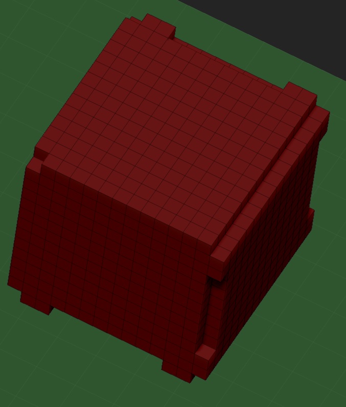

When I try to unify the skin on a Cube3D, Under Unified Skin I set the Resolution to 16 and Smooth to 0. The Unified skin created has some inverted rows. I have tried adjusting the setting but any Smooth value greater than 0 creates a rounded corner cube, with no inverted edges. Any suggestions on why this is happening?
UPDATE: I restarted ZB and it works now. Ugh.

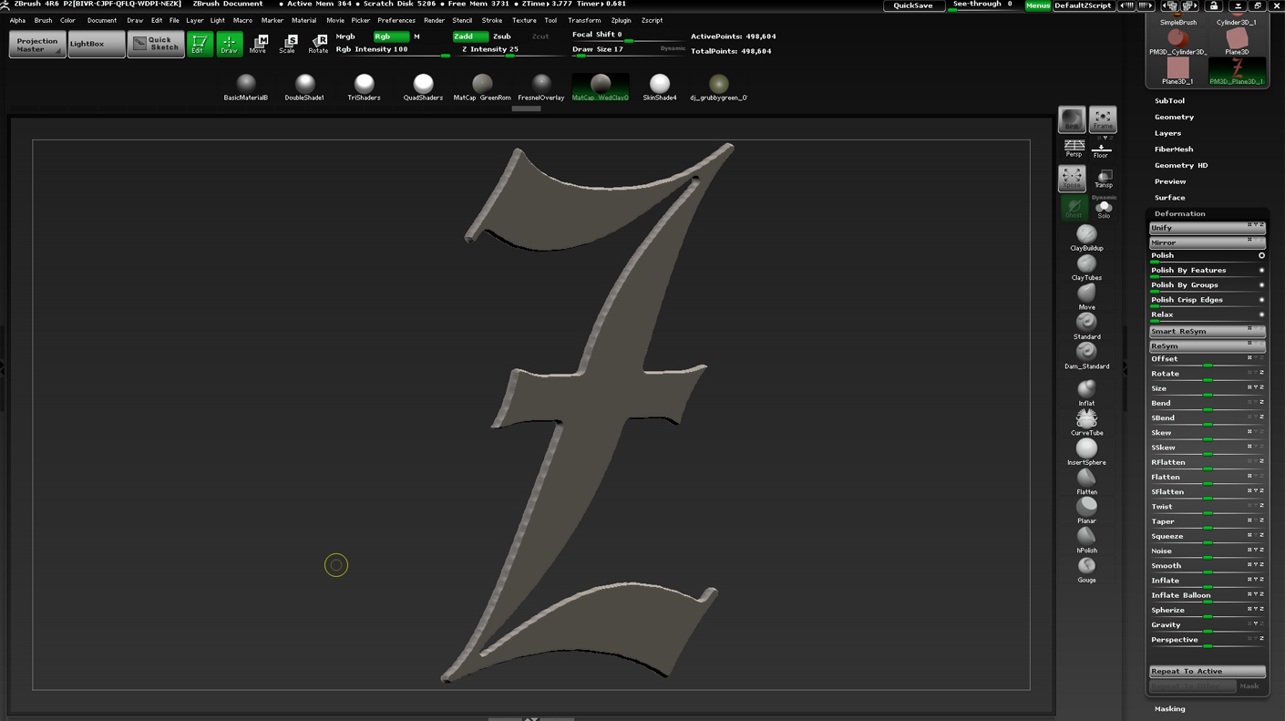

Quick screen shot, I know it’s not exactly calligraphy but you can use anything really. I just grabbed an alphabet off the internet and made this Z 3D with masking in less than 2 minutes. Unless you’re doing something absolutely insane you should be able to take any calligraphy you do and make it into a 3d tool. And even then the most insane is achievable if you learn your tool set. Hope it helps. By the way I used light box to paint it on to a plane and masked by intensity and poly grouped that mask then hid the rest of the plane and then deleted hidden then used panel loops. Like I said less than two minutes. Good luck in your explorations.
