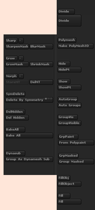

Here’s a small script that simply makes a few of my more commonly used buttons smaller so as to better organize my interface. When I use my surface pro 3 in tablet mode, I need a lot of things to be available on the sides of my screen, as my pen buttons are dedicated to shift and ctrl, and my left hand is holding the tablet. This script is actually technically for 4R7, but it should work in 4R6 too.
If anyone wants to continue updating this to include more buttons, feel free to do so and post it back on here. Although you’re free to do the buttons however you choose, it would definitely be easier to organize if the buttons were kept at sizes similar to the sizeblocks used right now. I’d love to eventually have the majority of buttons converted to smaller sizes for us users with smaller screens, but I need to focus on studying zbrush and anatomy rather than further perfecting my interface. In some cases, the buttons could have been made smaller, but I opted for clarity and ease of organization over saving a few extra pixels.
Any of the buttons that have a - box next to them do the ‘opposite’ of that button.
Morph stores a morph target. The - box next to it will delete that morph target.
Grow and Sharp will grow and sharpen masks, while the - box next to them will shrink and blur them.
The Spacesaver version of the SymDelete button doesn’t contain the x y z mini buttons, as I found I almost never delete symmetry on an axis other than the default x axis.
You can find these smaller buttons under the Zplugin:Spacesaver menu.
Here’s a screenshot to show the size difference between default and spacesaver versions of the buttons. The spacesaver versions are on top, while the corresponding default buttons are directly below them.
