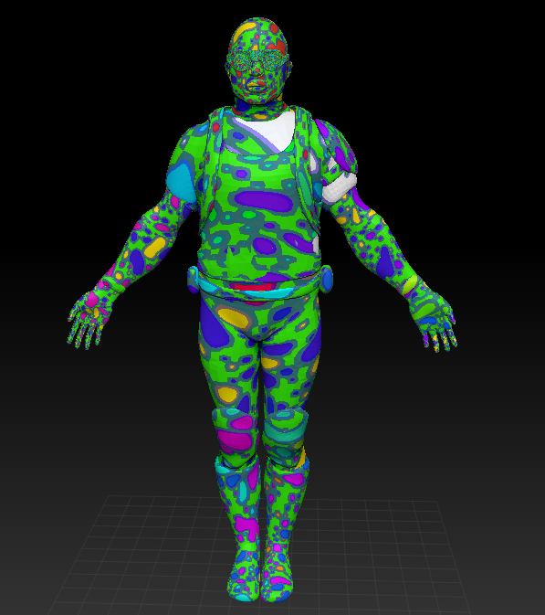

Here you go! Tried it after loading the Default cube from LightBox.
That’s a pecularity of some of the default projects and is something to do with how they are registered within ZBrush. If you rename the subtool there won’t be a problem. I’ll look into seeing if there’s a way around it but in general the macro should be fine.
OK Doug, I’ve updated the macro. I think this should be OK but if not, let me know.
That’s a wacky macro you’ve got there!
LOL. Like that? Thank you sir, I’ll check it out.
