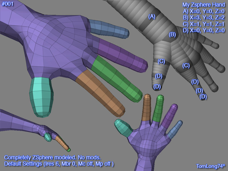

(A) in image #001
Start with a defualt Zsphere
Click Edit [T], rotate your view straight on (rotate +Shift)
Hold Shift and click on the Zsphere 2 or 3 times
This make a Zsphere attached to the original with the same size
(B) in image #001
Next go to [Transform] and change the Xres to 3, notice that the Y&Z update to 3 also. Hold SHIFT and change Zres to 2.
Click Draw[Q] and attach a Zsphere.
(C) in image #001
Next go to [Transform] and change the Xres to 1, notice that the Y&Z update to 1 also.
Move[W] the Zsphere into the parent ZSphere just to the point that it changes appearence as if concave.
(D) in image #001
Next go to [Transform] and change the Xres to 0, notice that the Y&Z update to 1 also.
Click Draw[Q], THEN hold SHIFT and attach a Zsphere (to what appears to be a concave Zsphere). Attach (with SHIFT) 2 more times
REPEAT C & D,D,D onto B for each finger the Thumb can be just C & D,D
Scale[E] Move[W] & Rotate[R] each ZSphere until happy with results.
I’ll attach a script I made to give you a starting point. You will still need to
tweak the Zspheres to make your perfect hand. Enjoy!
