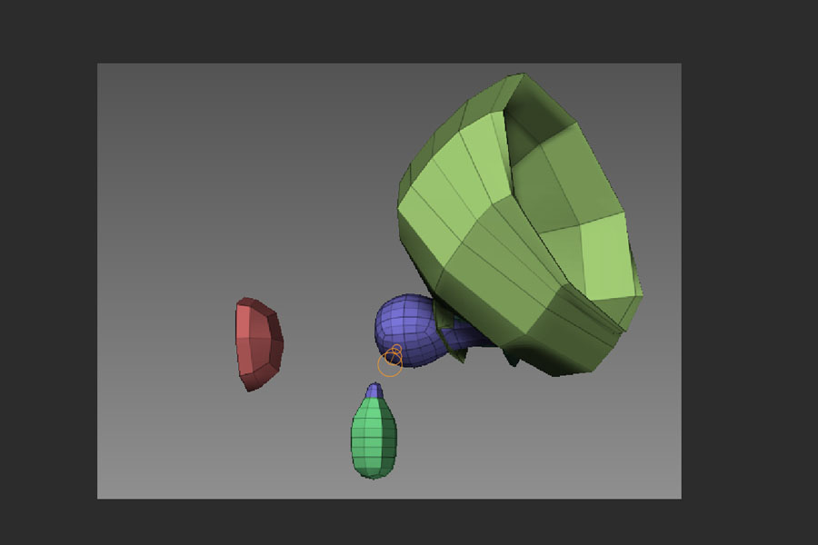

So when I downloaded and played the zscript it made some pretty weird things. I really like the zsphere hand setup and want to be able to use it.
This picture is a screenshot of the once the script was finished…
thats a ZB2 script.
Yes. This script was created with Zbrush 2.0. I guess it doesn’t work with ZB3. The tutorial should be easy enough to follow and should work with ZB3 - just not the script.

Haha, yea I suppose that makes sense if the script was made in ZB2. Ill go and spend some time messing around with the zspheres, Im sure Im overlooking something.
The instructions seem pretty confusing, at point C it says move the sphere back into the parent (Which I presume is B) so that it looks inverted, but in the image it doesn’t look like you’ve done that at all? Could you explain where I’m going wrong here…
This is because the picture is not a step-by-step picture, but rather shows the end result.
As soon as a child is added to that ZSphere that was created and moved in step C, the ZSphere changes to no longer appear concave. Only the final ZSphere in a chain can have this property.
That instruction in the tutorial helps you ensure correct positioning of the ZSphere. But as soon as you move to the next step, things will change back to looking like the picture.
