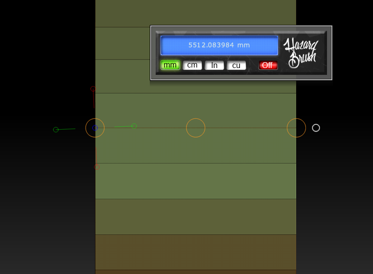

I created a ring in ringmaster. Set it to a size 7 with a thickness and width of 1.5mm square
create the basemesh.
Pulled out caliper master and measured the width in mm. It was astronomical ! Not sure what is going on. Tried it twice with the same result.
Can anyone give me a heads up on whats happening ?
thanks

@Foxjaw: Sorry to hear about your troubles with this. As long as you press âEnterâ after typing in the desired values in the Ring Master it should generate the correct scale. ][-][4Z4R][)) here on ZBC is the author of Calipers Master he would have more information for you on how to get the transpose options setup there.

After creating a ring basemesh, how do you go about getting the size scale thatâs under Geometry to match the tool size? Transpose sees it right as does Transpose Master, but I canât figure out how to get it to match in Geometry (I like using this as a quick-view reference for size).
Thereâs a scale setting under export that I tried setting to 1 per a video I found online but that didnât seem to solve it either.
Love Ringmaster but the mismatch is really picking at my inability to let seemingly insignificant things go⊠
Edit: Would love a simpler way but I just stumbled onto something.
After creating the ring base mesh.
1 - Set the Scale slider under Tool | Export to 1
2 - Save and close the project (this may not be necessary)
3 - Reopen the project, open Scale Master and Set Scene Scale
4 - I used the mandrel since it had a simple length of 50 - change the tool scale in Scale Master
5 - Ensure âAllâ is selected (this was on by default) and click âResize Subtoolâ
Again, that may be a convoluted way of doing it, but it worked.
