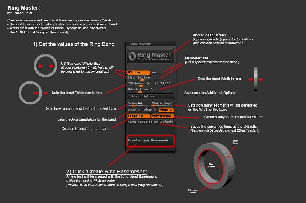

Ring Master allows you to quickly create Ring Band Basemeshes at a precise size for Jewelry creation
This plugin is unofficial.
Main features
  • Creates a Ring Band Basemesh at a precise mm size, thickness, and width
  • Exports out to scale via *.obj
  • Great for using with the ZModeler Brush and Dynamesh to create rings
  • No need for an external application to create a precise ring band for use in ZBrush.

*The plugin will create a new tool that contains a 1in(25.4mm) cube, a precise mandrel, and the ring band.
*Use *.ZTL when saving any created ring files (The creation process uses multiple tools to generate the band that can cause *.ZPR bloating.)
*As always, remember to save before using!

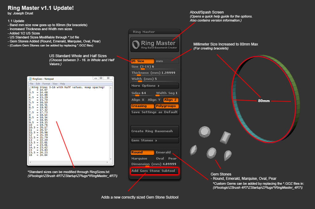

v1.1: Added US Half Sizes, Increased MM values for creating Bracelets, Added Config options, Added Gem Stones
Notes
Thank you all for the support; I am glad to hear that the plugin is of use! By request I have added some additional options to the plugin. The addition of US Half Sizes has been added along with the ability to modify the default values for these (watch the above for how to do this.) The mm value has been increased to allow the creation of bracelets up to 80mm. Help text should now show up correctly and the storing of the default settings should now work in the x32 version.
Finally I have added the support for Gem Stones. This will allow you to create new subtools with the correctly sized stones. These stone files can be replaced with custom ones if needed (see video above.)

Hi, Great plugin. I’m trying to make UK sizes but the pluggin doesn’t update some sizes when I use the mm tab. For example it doesn’t reconise a 19.8mm measurement. Any ideas what I’m doing wrong? Can i can the txt file within the plugin folder to make UK sizes instead of US?
Thanks for your help, cool plugins
@montana2008: On the mm slider make sure you type in 19.8 then hit enter (Sliders in ZBrush read as crazy numbers occasionally so this will show up as 19.79999 after hitting enter.) After creating the band and exporting it should read as 19.8mm inside of Netfab.
Yup! You can edit the text file to make the default sizes equal UK ones instead of the US ones :slight_smile:

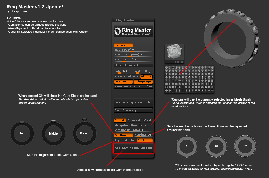

v1.2: Added the ability to align gemstones on the band. Added Array functionality, and Custom gem stones using InsertMesh Brushes. Thanks to @][-][4Z4R][)) for the recommendations and idea :slight_smile:
Notes
If you have already purchased Ring Master from GumRoad you should receive an email with a link to this updated version. Check your spam folders :slight_smile:
I added some additional functionality to the gem stones area. The gem stones can be placed on the band and repeated if desired. Also added the ability to use any InsertMesh object as a ‘Custom’ gem stone. Simply select an InsertMesh brush make sure ‘Custom’ is on and click “Add Gem Stone Subtool”

I noticed an odd issue in v1.2
  1. Draw > Perspective is automatically turned on when "Create Ring Basemesh" is hit. Seems like a bug as not all users will want that on when working with this awesome plugin.
Suggestion/idea - I've noticed when creating rings that have fewer than 64 "sides" to them that they tend to shrink quite a bit when they are subdivided. Which is why I'm assuming you set the default to 64. But It would be great if there was an check box that would create a ring (no matter what the segments were) that when the ring was then subdivided it would then match the size set in your Size slider. This may be easier said than done. But, a lot of times I want fewer control points when creating these rings so that I can deform them easier/smoother. But then I have to re-size them to the right size since they shrink so much when subdividing.
