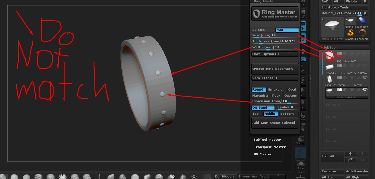

errror.jpg Hi, I have just installed the plugin and I have this issue, the measures don’t match with I need, What should I do? thanks in advance .

@carlosmbernal: if you are typing in the values make sure to hit ‘Enter’ after you type the value in. (ZBrush sliders occasionally do not update if you type them in and don’t hit enter.)
Let me know if that fixes the problem you are seeing :slight_smile:
-Joseph

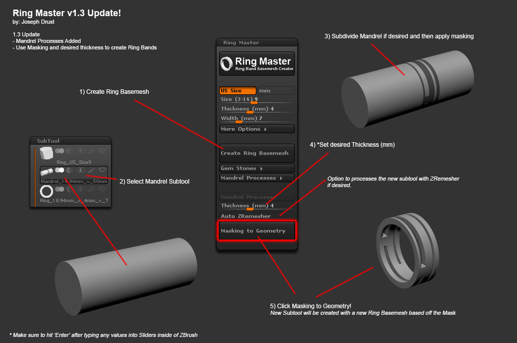

v1.3: Added the ability to create band with precise thickness from masking using the mandrel subtool. Fixed the Perspective issue reported. Added checking for ZBrush 4R7 P3. If you do not have P3 installed you will receive an error message now with information on how to fix.
Notes
Finally had some time to post this update :slight_smile: I added some Mandrel Processes that hopefully will be useful. This will allow you to create new ring bands by applying masking to the mandrel subtool. If you are not updated to ZBrush 4R7 P3 (or you are using a cracked copy of ZBrush…) this plugin will not work for you :slight_smile:

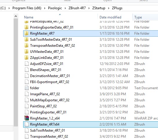

I just downloaded and installed the latest version of Ringmaster.
i) For some reason it isn’t showing the Icon for the About/Splash Screen
And when I click on it, it just brings ups a blank dialog box
ii) When I set up the dimensions for a ring and hit “Create Ring Basemesh” I dont get anything.
The only thing that happens is that I can drag on the screen and it drags out a cylinder.
Can anyone tell me whats going on ? I’m wondering if there is some kind of glitch happening
THanks !
@Foxjaw: Can you check to see if the folder is extracted with it’s contents from the Zip file? (If the About image is not showing up it’s usually related to the plugin not finding the image in the RingMaster_4R7 folder. )
For the x64 version the install directory should be:
\ZBrush 4R7\ZStartup\ZPlugs64RingMaster_4R7_x64.zsc
\RingMaster_4R7
[INDENT=2]AboutImage.psd
[INDENT=2]Emerald.GoZ
[INDENT=2]Marquise.GoZ
[INDENT=2]Oval.GoZ
[INDENT=2]Pear.GoZ
[INDENT=2]RingMaster.psd
[INDENT=2]RingMasterState.mem
[INDENT=2]RingSizes.txt
[INDENT=2]Round.GoZ
[INDENT=2]ZFileUtils.dll
[INDENT=2]ZFileUtils.lib
[INDENT=2]ZFileUtils64.dll
Let me know if that helps :slight_smile:
