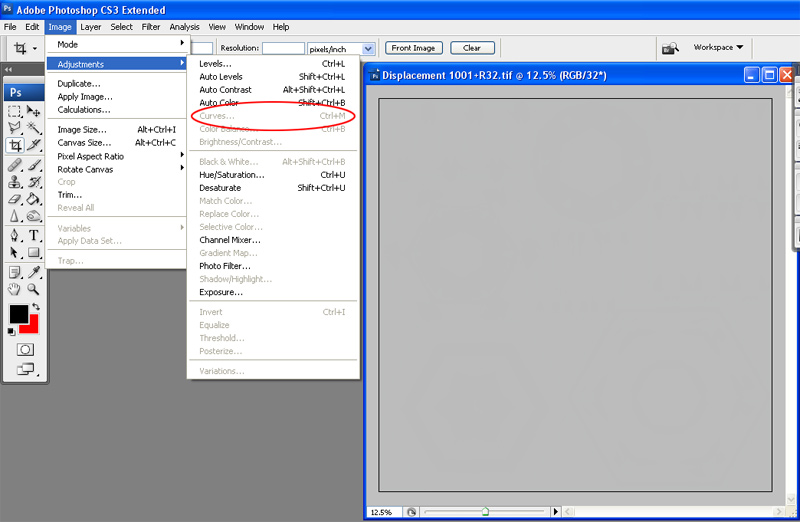

“The 32-bit floating point maps generated in ZBrush should not be edited in an external editor - doing so may alter the map in undesired ways”
Straight out of Scott’s book, which is awesome by the way and well worth every penny.
Unless Im doing something wrong (which I probably am) Photoshop won’t allow the 32-bit maps to be edited by adjusting the curves anyway.
From what I can tell by playing around in Maya 2009 the past couple weeks, cranking up the alpha gain & offset results in more visable details that are “hidden” in the map so to speak. I tried it on a couple of my models but it only seems to bloat the mesh more in places that shouldnt be displaced as much.
[i]“The 32-bit floating point maps generated in ZBrush should not be edited in an external editor - doing so may alter the map in undesired ways”
[/i]Yes your right…but the method I use is 16bit which is fine to edit in PS.
I think for 32bit editing you may want something like “nuke” or possibly HDRIshop.
You could also re-map the values inside maya with a node, but personally I prefer editing the texture itself.
The reason for editing the map itself and not your alpha gain and offset is due to expanding the tonal range of the displacement, instead of multipling it (which will bring out more of the map however it still remains narrow as far as the tonal range is concerned). Think of it as a black and white photo…more contrast won’t reveal more form.

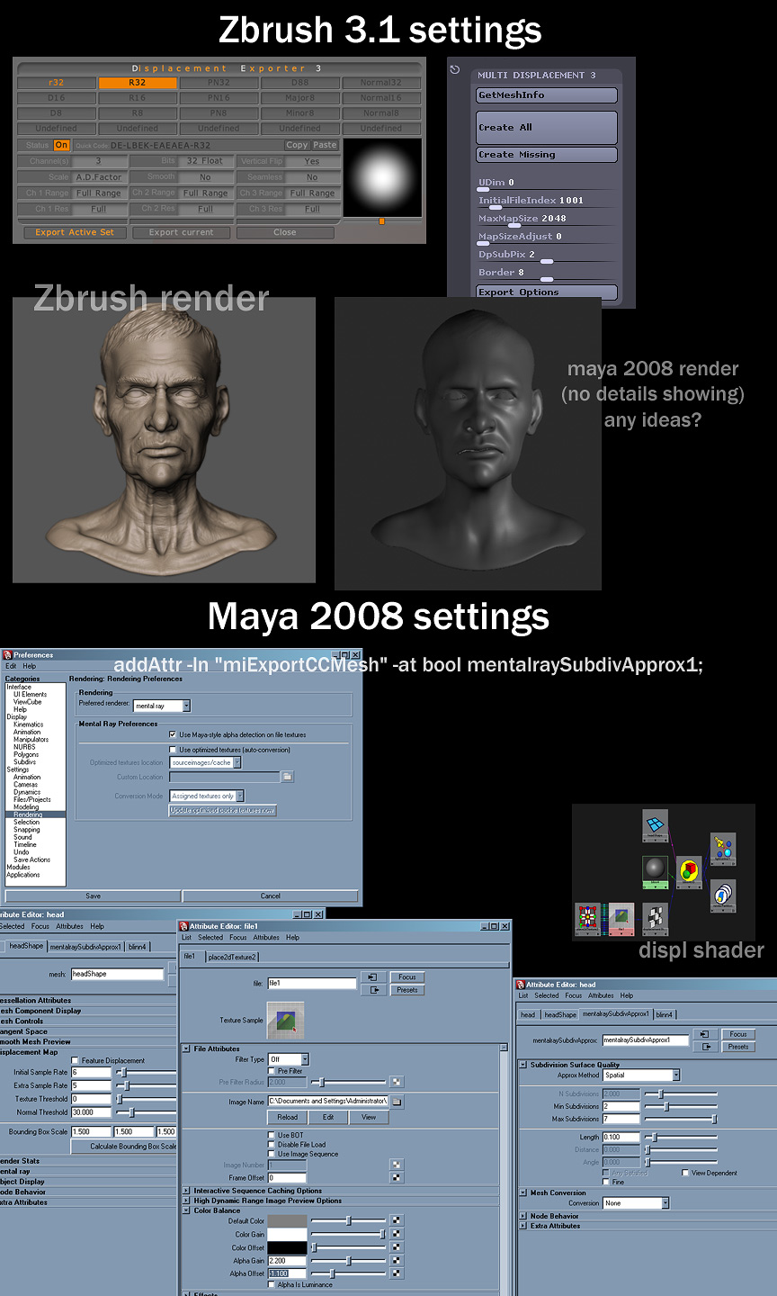

Hello,
It took me a while to assemble this post so I hope someone responds.
I’m trying to render a head mesh in mentalray for maya in maya 2008 and I can’t get it to work properly.
I used the 32 displacement guide settings along with script that Scott Spencer uploaded to ZBC for the CCmesh. (I copied the script into a text editor then copy pasted that into maya and ran it before rendering)
http://www.zbrush.info/docs/index.php/ZBrush_To_Maya_Displacement_Guide#Displacement_Maps_and_the_ZBrush_Alpha_Displacement_Exporter
http://209.132.96.165/zbc/showthread.php?t=56061&page=1&pp=15
For some reason I render with mray production settings and it’s as if there is no detail on the mesh at all.
Any ideas?
Zbrush 3.1 Settings
R32 set in the Displacement exporter box quick code: DE-LBEK-EAEAEA-R32
MD3 settings are:
1001 initi file index
maps size adjust 0 (also tried at 100)
2048 size
dpsubpix 2 (also tried it at 0)
Border 8
Maya 2008 settings:
I tried rendering as a .map and a .tif
I also set my alpha offset to -1.1 alpha gain to 2.2
alpha is luminance is unchecked
I haven’t scaled anything in maya, i just exported my level 1 mesh from zbrush and assigned the displ shader to it in maya.
imported multiple objects false.
Subdiv approximation settings are:
spatial
min sub 3 max 6 length .1
feature displ is off view dep is unchecked
set use maya-style alpha detection in prefs
My Uvs are all in 0 to 1 space non overlapping.
Mesh is all quads, ran maya cleanup script on it with no errors.
I also couldn’t get maya 2008 to show progress messages, under translation they didn’t have the progress message tab anymore.
I didn’t open the original displ map in photoshop I did however open a copy just to see if it worked and I saw some detail on it after adjusting the levels (I didn’t save anything from photoshop just opened a copy of the original)
Am I missing anything?
Thanks for any help, I’m losing my mind. Screenshot attached.
Darrell
abnoid,
I would suggest first mastering a 16bit displacement…32bit is used for high end film and game…did i mention high end.
  1. check alpha is luminance, this is critical it will tell maya to calculate your map.
  2. The multi disp 3 settings are there for exporting to particular programs, if you don’t know what to use go with the code found on the scott spencer thread… personally for 16 bit i go with DE-HBEK-EAEAEA-D16
  3. 32bit RGB and floating point is huge…check my previous posts.
  4. 2.2 and -1.1 ARE NOT EXACT VALUES!!! This bold this not to point out your inexperience but rather to highlight the fact that this information has been gven so many times in this thread and others for the past couple of years. Having said that the way to truely determine the correct Alpha gain and alpha offset values is to begin at 2.2 and -1.1 then increase or decease as needed. This is how to get good displacement, sorry there is no magic number or equation.
    Each mesh is so different that tuning is the only way to get it…So you may find you need to boost these values if you haven’t edited your disp map to increase its tonal range…I mean comn’ lets face it zbrush spits out maps which contain all the info needed for disp, but it doesn’t spit out a map ready to use raw…it needs tuning itself, the map that is.
So 2.2 may become 44 and -22 or .08 and -.04 get it? Just remember to keep the values as multiples of the 2.2 and -1.1 relationship which means take a number, any number and divide it by -2, 44 divided by -2 equals -22.
You have these values because zbrush calculate mid grey as zero and maya calculates it at black…so what you are doing essentially is shifting these values.
  1. This one is the most important of them all…displacement is dependant on the geometry of your base mesh.
A mesh polycount of 1000 will not work/look right if you try to displace up to 6 000 000, because even though you are adding a subdivision node to the mesh it is only an approximation. You can get away with this sort of thing for games because they requires normal maps.
The best way to check what you level you need as a base mesh is to inspect the silhouette of the object… when it looks close to the final hirez model then you know.
I think a common misconception regarding displacement maps is that a 32bit map will some how add all the detail back to a base model. Why not consider that a higher poly count will reduce the amount of render calculation and produce a displacement you know is going to work because the base mesh is high enough to contain all the major and some mid forms.
Anyways hope that helps:sunglasses:

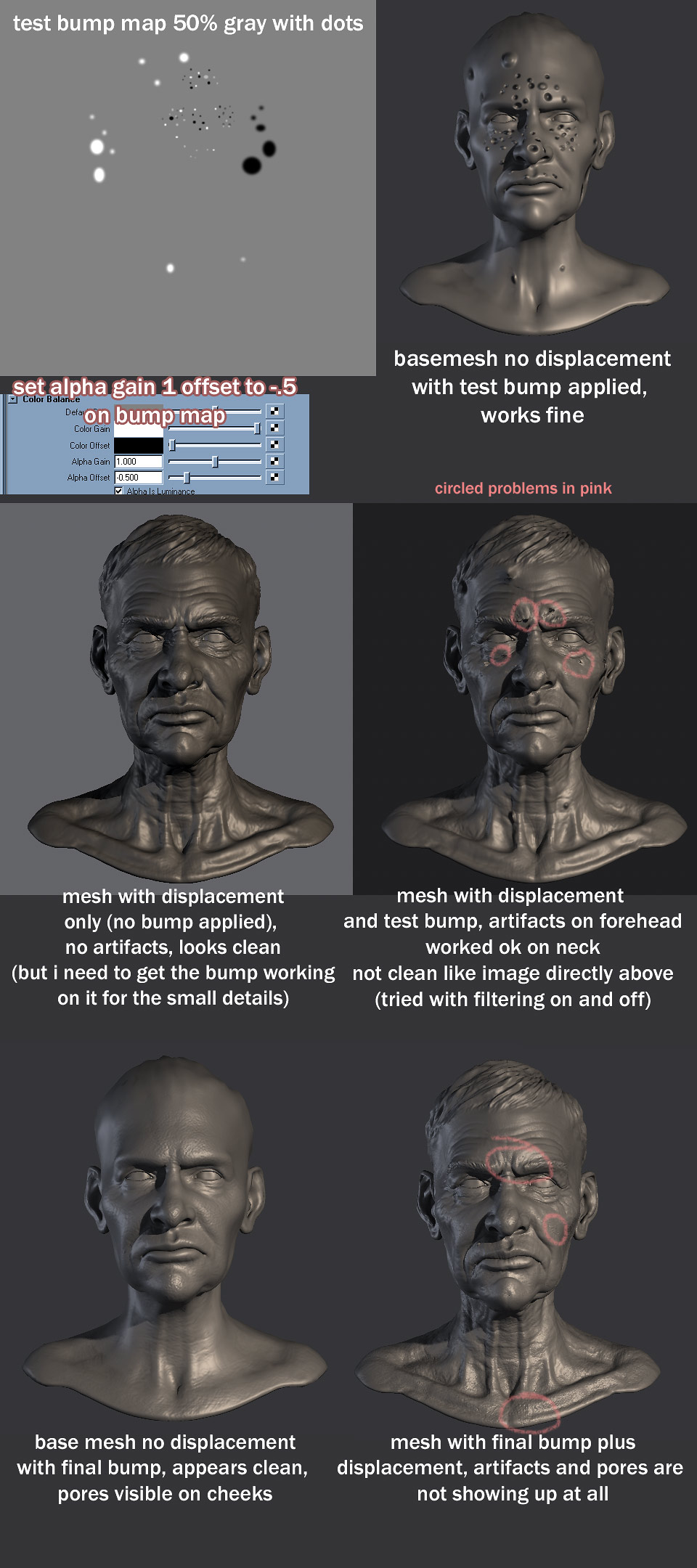

I’m still working on the same project I posted earlier (using Maya 2008 on xp pro 32bit) , only now I got displacement working great, and the bump map is causing issues when used in conjunction with displacement.
My bump map is done on a 50% gray background with the alpha gain set to 1 offset to -.5 in the color balance slot (also tried on default settings)
When I render a bump map on a model with no subdiv approximation and no displacement it comes out clean, but once i add a bump map to the bump channel of a shader that also has good displacement with a parametric subdiv approximation, the bump map doesn’t really show up at all, and causes artifacts. Screenshot attached. I really need this bump map to get the pores and tiny wrinkles goin on this model before I can call it done.
Any idea what I’m doing wrong?

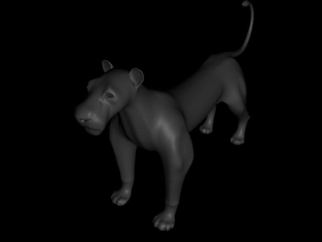

Okay so the problem I am having is a new one I think.
I have 2 objs in my scene and each has their own SubD Approx. and a Disp. Approx.
At First only one of them would render but it looked really nice.
I used the Script you gave us scott and they both rendered with Disp! I was sooo happy!
But they only render in Maya Software. And one of them has wierd swirly lines all over it.
When I try to render in Mental Ray which I really wanna do I just get a drey screen after 1 second. Doesnt even start to render. every time. ???
Brownie3703
make sure you turn off “feature displacement” and the approximation nodes are related to mental ray… which means you can’t render in software with these nodes.
abnoid
At a guess would you need to set your bump alpha gain and offset to the exact settings as your disp?
Also just curious what advantages, if any, does parametric have over spatial?
(i haven’t had this issue and usually paint with black as a base for bumps…thats how maya likes it)

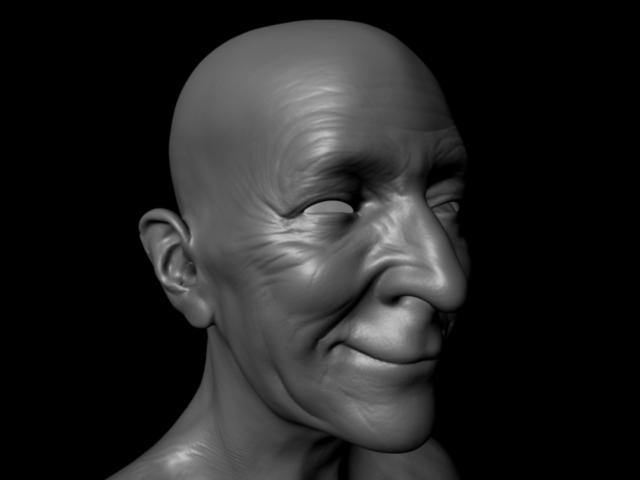

Displacement test
both images rendered in mental ray, maya 2008
(with default production quality settings)
Settings
*use maya style alpha detection is on
*Mental ray Subdiv approx node settings the same for both
*Approx method = Spatial
min subdiv = 3
max subdiv = 5
length = 0.01
*file node settings for both images
alpha gain = 2.2
alpha offset = -1.1
  • feature displacement is off
  • Alpha is luminance is on
displacement map settings in zbrush
for 16bit, quick code = DE-HBEK-EAEAEA-D16
for 32 floating point, quick code = DE-LBEK-EAEAEA-D32
Both maps where generated at 2048 x 2048 with a DPSubPix of 2
Both maps took 54 sec to render. The 16bit actually displays more detail.
Please note the settings I used for this test are as standard as can get, there was no time spent looking for the right balance between settings, hence why I used 2.2 and -1.1 for the alpha gain and offset.
Note: Both renders in my opinion have a ‘softness’ which is a dead ringer for cg characters.
Although the 16bit has more detail it is far from what I would call done.
Remember this test was done in a clean scene with nothing but a model and its shading network. I wouldn’t expect the same results with regard to time if it was for production.
