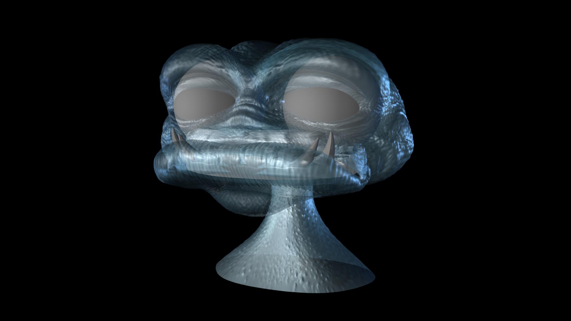

This question is for Scott. Dude have you experience a render where your displacement looks perfect, but the material turn out to be transparent.
It looks like the Disp.Map force the shader to go transparent up to a 50% and when I manipulate the color gais and decrease the color to be less white, the shader gets back to normal, however if I touch the viewport again, the shader goes transparent again.
The Disp.Map file is the bad guy.

After try and error I have done getting a some way a normal render, but I’m still anoyed by the viewport issue. And The model look some what exploted as you may see.

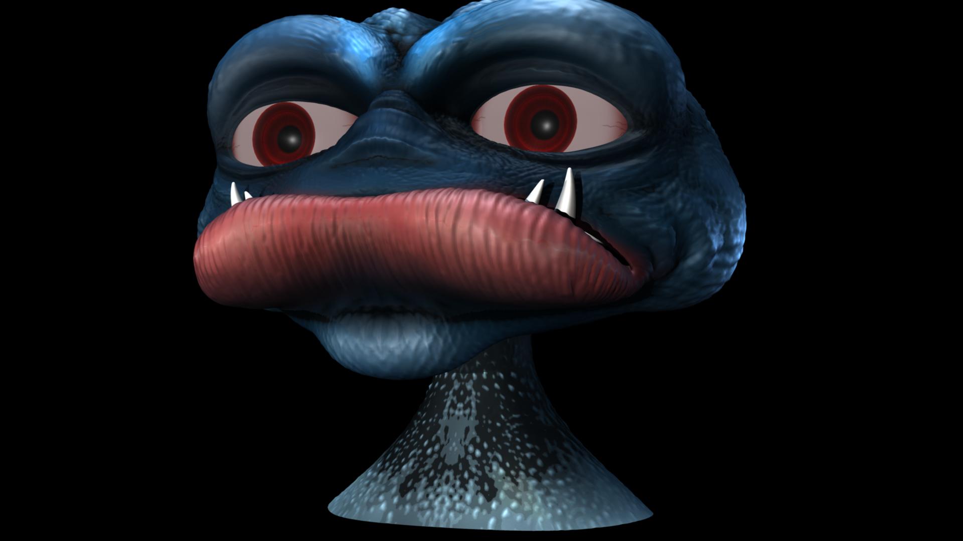

Ok Scott. Ayhorya here.
I have repeat the process again, but this time I create the nodes one by one
the order:
Shader: blinn
DisplacementNode.
FileNode: The displacement.map from ZBrush and converted to a map.
then I conect the DispNode to the shader as Displacement.
Then I conected the Disp_FileNode to the default atribute to the DisplacementNode.
Runned the script. some crazy error showed up, but I ignored it.
And the rendered image looks very close to what I want.
At the end the process works, It’s that the stupid bug is really staburn and the guys from Autodesk should fixed fast, and give to the clients a fixed extension or something.
Any ways, here is the render:
Thanks again and have a cool one.
Ayhorya.

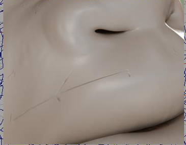

but now, after the script and render i don’t have seams but i have this… untitled.jpg
sigh…sigh sigh…

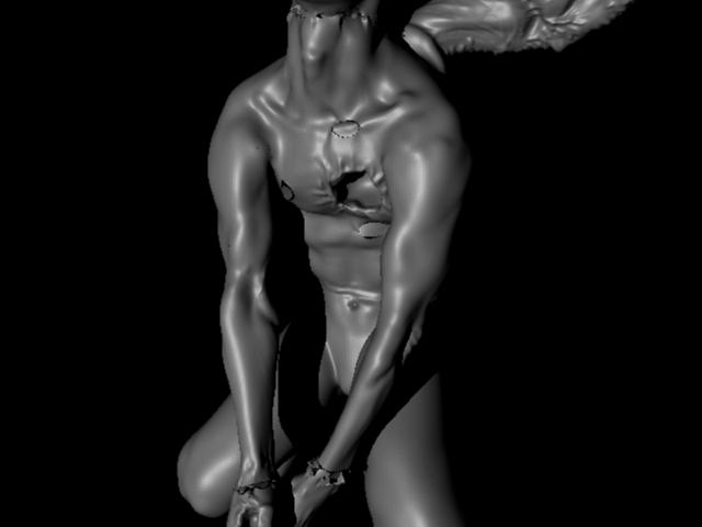

I’m getting lines on my mesh and i’m using the 16bit displacement(converted to rgb) provided with the Pixologic model. I can’t seem to get 32bit displacement to work at all.
Aswell as the lines in the mesh i’m not getting much detail, is there anything I am overlooking? I’ve looked through all the tutorials…

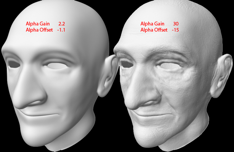

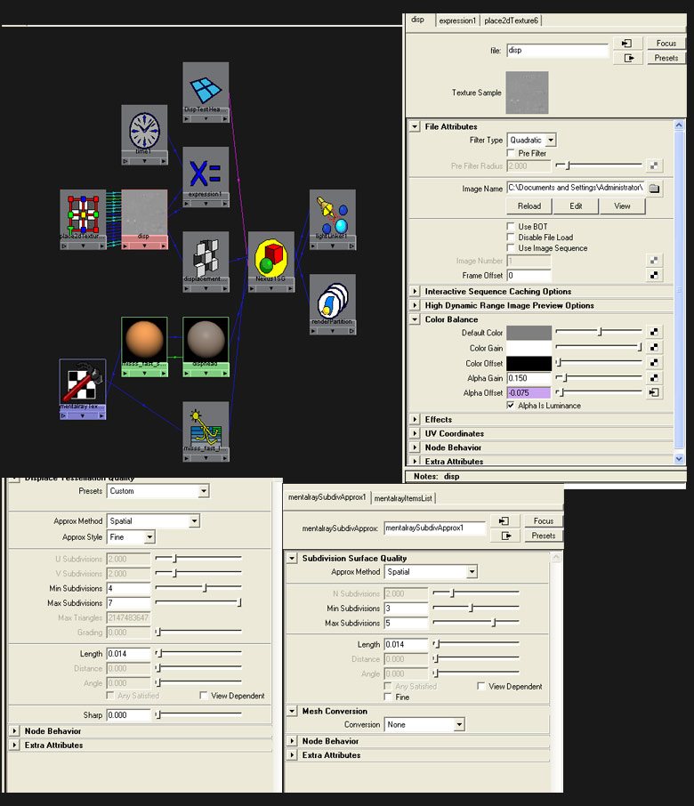

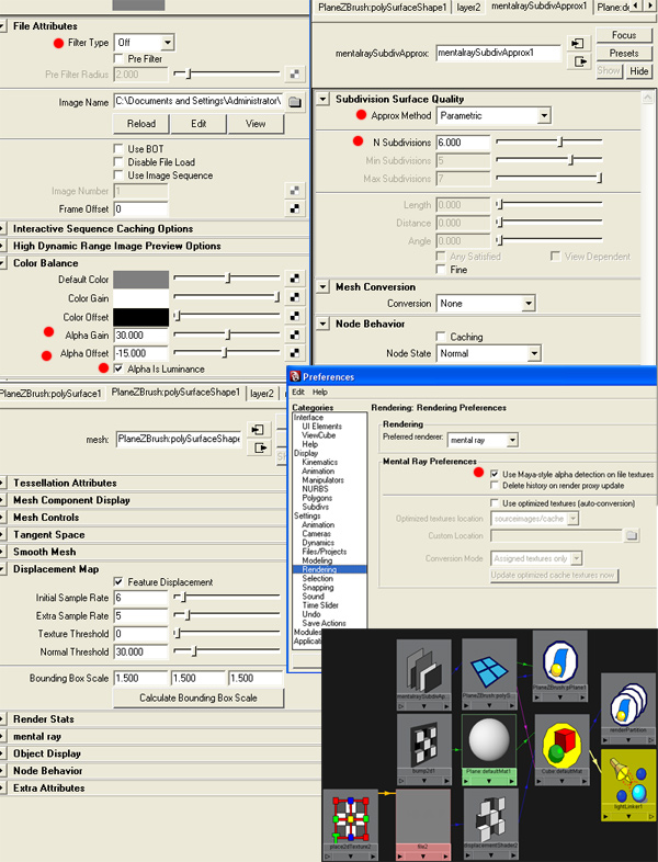

Here’s my issue, that perhaps someone can shed some light on. I’ve followed every guide Ive ever come across to a T, and have had no luck. As you can see by all my settings below. I kept making small changes here and there until I started seeing results. The areas that finally made a difference is the alpha gain and alpha offset. What I dont get is why everyone says “set these at 2.2 & -1.1” The only way that I am able to see detailed results is if I crank these settings way up. For these renders, 30 & -15.
Correct me if Im wrong or Im not getting one of my settings right, but I thought I recall reading something, that with the use of a 32-bit displacement map, you didnt need to play around with these settings as much anymore. If Im wrong, is there another way to accurately determine what the alpha gain & offset will be?
Ive attached some images of my settings for reference.
Im also using the quick code of DE-LBEK-EAEAEA-R32 to generate my map.
I use the converter posted on this site to change it to .map format.
If it’s relevent, my system specs are in my sig.

my displacement .tif file (non-color managed, rgb, flipped vertical, 16-bit) and phong shader were setup as per scott spencer’s
tutorial on the subject. i get very choppy, pixelated results from a 2k, production quality mental ray render, and a LOT of the fine details are missing. it’s frustrating! i would love to do some full 3d landscapes instead of 2.5d cam projection solutions.
my alpha and alpha offset were set at 30 and -15 because the base mesh was fairly large in my viewport gui. even when i do tests on a 1x1 poly plane, exported from maya, to zbrush for sculpting, then back to maya it doesn’t render the detail properly.

Post your settings within Maya & make sure you are using the correct exporter settings in the ZBrush displacement exporter.
@gfilmman - 2048 is not nearly big enough. A 2k map contains just over 4 million pixels, which means that all small details above 4 million polys will be lost and that is in a best case scenario assuming the uvs are perfectly laid out to use 100% of the uv space. Try a 4k map and you should see a difference.
