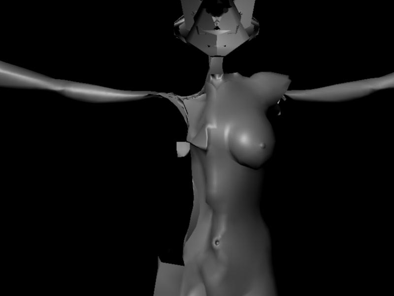

Hey guys
Im a games design student and my latest project requires me to make a highly detailed model.Iv made the base mesh in maya, sculpted in zbrush and am now trying to generate and apply a displacement map, but im getting really odd results. I have the zbrush character creation book (By Scott Spencer) so im following that as closely as possible. Iv gone over the entire process countless times and its the same thing over and over. i just cant understand whats going wrong…
Any suggestions would be greatly appreciated, im supposed to hand this in within the next few weeks.mess.jpg
Thanks for adding this info Scott! :slight_smile:
Woah Snakes23… Implosion. Thats an odd result. Is your disp. map generated using the right settings and applied correctly in Maya? UV’s laid out correctly?
I fixed it…
Uvs were set up correctly, no overlaps. I think it was something to do with how zbrush flips maps vertically, i had mixed the setting for both preferences and flip in the displacement exporter.
Even when id sorted that there were problems, one of the legs imploded - but turning filtering off sorted that out.

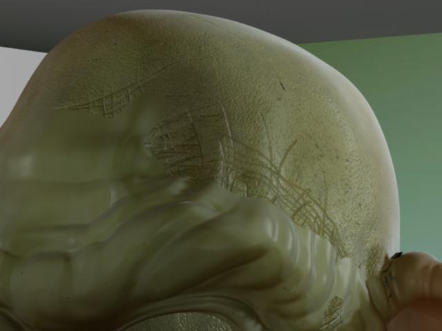

Robb, what happenes when the mesh “dosent work” or when you get “weird parts?” Do you get a render that looks fragmented, or bloated maybe?
Post some images of the problem you are having. Seeing it can help determine the issue.
S
Hi Scott,
Here is some pics of the model.
the first one is the high res mesh rendered in mentalRay (render correctly)
http://www.digitaledge.be/tmp/forum/headHigh.jpg
the second is the displaced mesh without the use of morph target (render correctly)
http://www.digitaledge.be/tmp/forum/headDipslace.jpg
the third one is the displaced mesh with the morph target (render with artifacts)
http://www.digitaledge.be/tmp/forum/headDispMorprhTarget.jpg
as you can see on the third image there is a strange bump next to the nose and a thin line under the lips.
On this model there is a little update. I use the projectAll tool on another model to be able to use it in maya with my base mesh and it works :slight_smile:
but I still have problems with the morph target.
thx for your Help
you should be able to re-construct your base lvl subdiv in zb…most of the time.
If all your blend shapes and ztl where created from the same original mesh then vertex ids will remain consistent at different levels of subdivision (in maya nad zbrush)…you could subdivide your blend shapes in maya…although obviously this could result in too high a poly count, however a way around that is to create the blendshape (node) then delete all the shape meshes.
Something I’ve heard is to check SUV on your ztl BEFORE you start sub dividing your mesh, something to do with the border of the maps zbrush generates, apparently SUV will improve if not solve the issue of seams (among other methods).
hope this helps
thx for your reply
I actually use the project all to rebuild my mesh and now it works fine
I can use the mesh in maya with the blendshape
my last problem is the morph target
when I export my displacement map with the morph target switch
I always have some atrifacts in maya
but if I export directly without switching the morph target it works without any problems.
