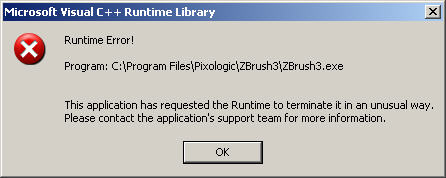

My Ztool have 23 subtool.
I did each step and i finished by clicking on STL binary. Then after 1mn i get a message error (i did a screen shoot) and zbrush shut down.
[attach=160708]Prob1.jpg[/attach]
Can anybody help me please?
For information : i already execute the vcredist_x86.exe application (that said in the .doc with the plugin.
Is therez an other way to get a stl from my ZTL?
thanks

Regarding the error…
have you set the executable to run as administrator?
Right Click icon, properties, Compatibility Tab, Run As Administrator…
then Apply to make sure it ‘always’ does this.
Might be the issue, might not, but I hope this helped.
Also, make sure that you installed the correct version of the C++ software…
I know I wound up installing like 3 versions to get ZBrush and some other apps running straight for me.
Thanks for advices LWAddict!
Yes i ran it as administrator and i have the correct version of C++.
I did some test on simpleZTL, it works pretty well. But still don’t with my big ZTL…
Can you tell me if you’re sure there is no polygone limitation for the exportation?
thanks
