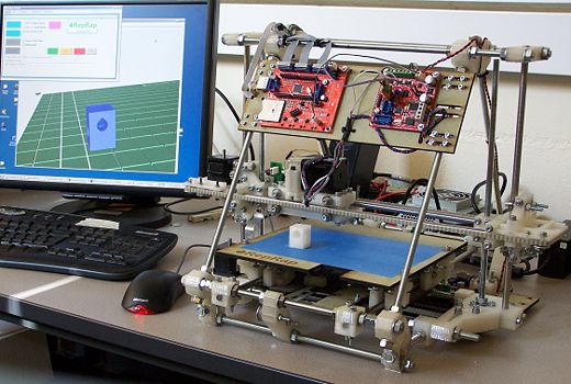

Just some info regarding the big question I see being asked over & over…
“Where can I print my models for really cheap?”
Here’s the best answer I’ve found…
YOUR OWN HOME!
You can build a 3d printer from scratch, using open source designs from the internet for less than $1,000. True story, no bull. Here’s a link…
http://wiki.makerbot.com/printing-videos
I’m seriously thinking about spending the money & making my own printer. The base model fo Makerbot costs about $750 to build while the deluxe costs about $900. If you make 90 models & sell them all for $10 this thing could pay for itself.
