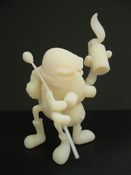

Hi,
I just thought I would show you this 3d print that I printed out last week for a customer of mine, it was modelled in Zbrush and came out awesome!
Some of the models I have seen created with ZBrush are just plain amazing! This one was created by Matt Long at the West Wales school of arts.
That looks good, what kind of printer was that printed on?
