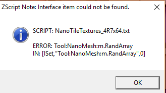

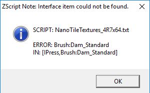

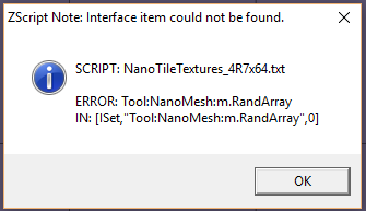

Great plug in! i am trying it out and i can set up all my nano meshes and be ready to capture but i run into 2 issues
  1. when creating a new tile plane i get the error below
  2. when trying to capture i get the second error below
I followed the steps you gave one of the previous comments and the plug in is installed in the correct place. any ideas?
@yeluis: Make sure you have ZBrush updated to 4R7 P3. (it should say what version you are running at the top of ZBrush.) The ‘RandArray’ should be there if you have the most recent version of ZBrush installed. You can run the ZUpgrader.exe in the ZBrush directory to upgrade to ZBrush 4R7 P3.

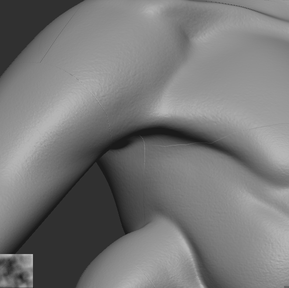

Such a great plugin! I’m having some issues with the output though, it seems all of my textures have a fringe around them that sadly makes them unusable.
You can see the effect when I’m trying to use the textures as surface noise here:
I also tried just grabbing the depth of the framed tile tool and exporting that, but the result was the same. :confused:
Has anyone encountered this issue and know of a fix?

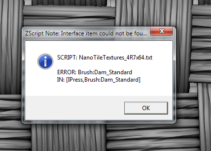

Hello,
I have a problem with the nanotiles texture plugin since i’am on ZbrushR8: i have always this message when i start the plugin and also when i try to export seamless maps.
Nano tiles texture v2.3 x64
conf: windows 7
anyway, thank you for everything
im having the same problem as the guy above whenever i try to export or create a new tiletool, has this problem been fixed/ is there any solutions? im on 4R8
