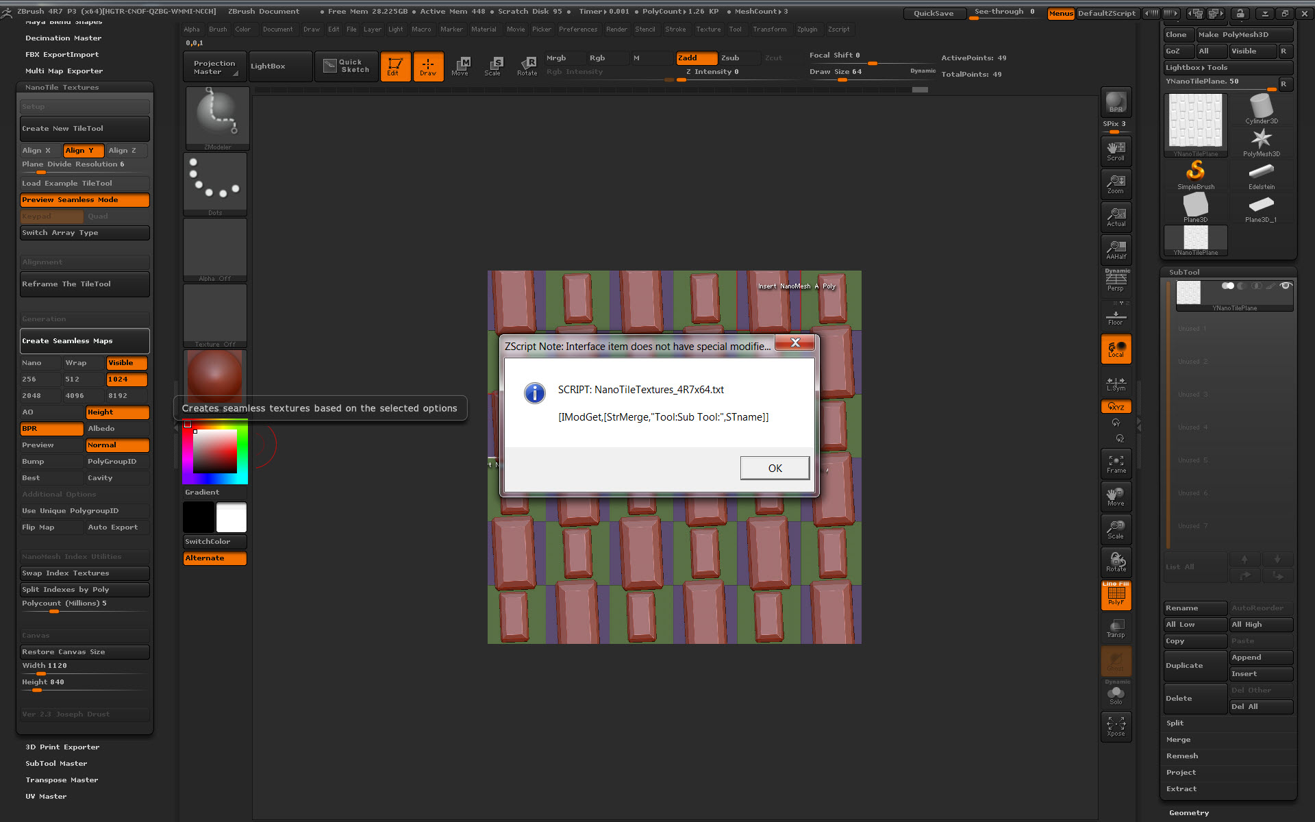

Why don’t I see “RandArray” in the NanoMesh window? Anyone else seeing this?
@Pombero: Make sure you have ZBrush updated to 4R7 P3. (it should say what version you are running at the top of ZBrush.) The ‘RandArray’ should be there if you have the most recent version of ZBrush installed.
-Joseph

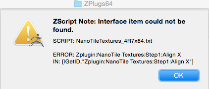

On Mac OS X 10.10.5 i get this error message on ZBrush 4R7 P3 (x64) startup and NanoTileTextures_v1_8Bildschirmfoto 2015-09-12 um 00.51.01.png
@TBAzB: Try this one and see if it fixes the issue. The error you are getting is related to ZBrush not being able to find the Interface for “Align X” I promise Its there :slight_smile:

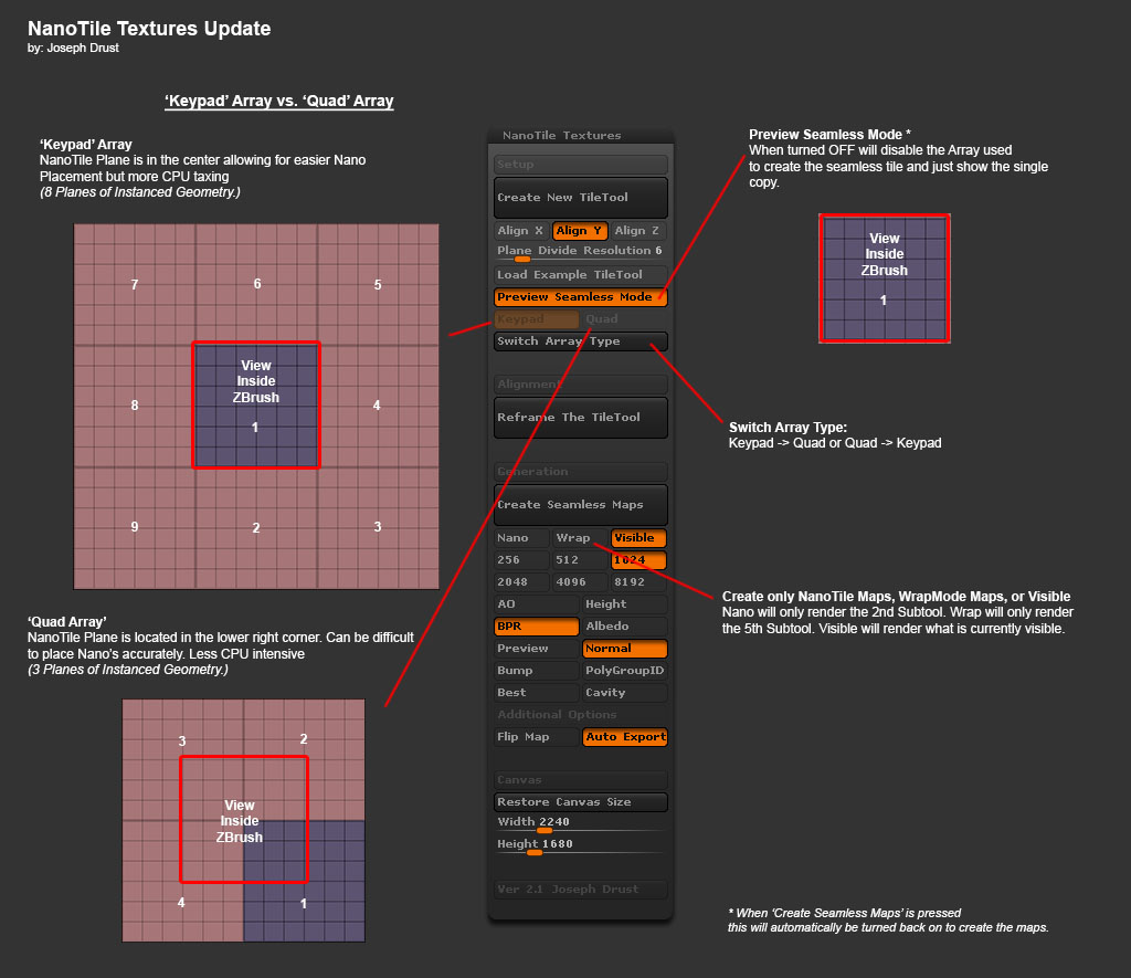

Soo
 This is a big update. Turns out everyone enjoys creating really large geometry scenes containing millions of polygons with this plugin :slight_smile:
To reduce some of the CPU throttling I added the option to use a ‘Quad’ Array in addition to the ‘Keypad’ Array to generate the tiling. This will reduce the amount of topology of the scene by over 50%! This mode however it’s not visually easy to use and can be confusing to users. When using the ‘Quad’ option the NanoTile will display in the lower right corner instead of the center (this is not a bug.) Below is an image to illustrate how it is working:
Now to make the ‘Quad’ option a little easier to use I have added a ‘Show Seamless’ switch. With ‘Show Seamless’ Off the NanoTile Plane will be centered on the canvas. This will make placing the Nanos easier but will not accurately show you what the final tiled result will be. (The WrapMode Plane will also not display correctly when using ‘Quad’ and having ‘Show Seamless’ Off.) A button has been added to switch between the ‘Keypad’ Array and ‘Quad’ Array (so you can toggle back and forth between the two if needed.)
In addition to the ‘Quad’ Array option a ‘WrapModePlane’ Subtool has been introduced. This will be the 5th Subtool in the created scene. This Subtool is setup to work with the setting of ‘WrapMode 1’ on any brush. (To activate WrapMode go to [Brush:Curve:WrapMode] and set it to 1.) By default when clicking ‘Create New TileTool’ the Clay Brush, Clay Buildup Brush, Dam Standard Brush, and Standard Brush will have WrapMode activated automatically (This will only happen on a new scene creation thou; if you open up an existing tool you will have to reactivate WrapMode on your brushes.)
To use the ‘WrapModePlane’ Subtool just select the Subtool then divide up to a desired polycount (SMT is already off. [Tool:Geometry:Divide] ) Then choose your desired sculpting brush. If WrapMode is active, when you sculpt over the outer edge the effect will be seen on the other side. (The WrapModePlane contains a safe zone to prevent tearing.)
Finally the ‘Cavity Render’ pass has been added.

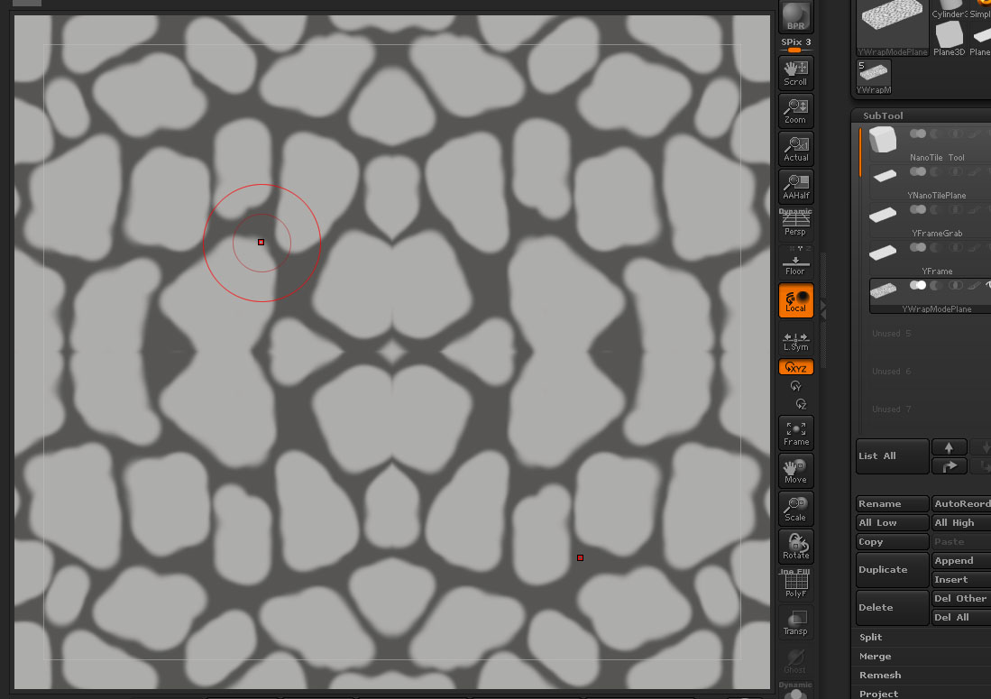

Hi,
Thanks for new update Joseph :slight_smile:
I was wondering if there’s a solution/fix for example using Tilling textures
created with NoiseMaker/PS to be used with the new WrapModePlane?
I have currently tried to use Alpha62 (In the Alpha properties set tilling set 2) then
when I do Mask by Alpha I can’t get it to tile. It would be cool if you could use
tilling textures on the WrapModePlane in combination with Deformation/Inflate.
Would certainly like to hear if this is possible? Thank you.
@decorix: Yes this will totally work when using the WrapModePlane Subtool as long as the alpha is tillable:
DragRect Workflow:
  1. Make sure Symmetry is off
  2. Hold CTRL to select the Masking Brush
  3. Select a tiling alpha (Alpha 62)
  4. while still holding CTRL set WrapMode to ‘2’ [Brush:Curve:WrapMode ‘2’] (Any WrapMode should work.)
  5. while still holding CTRL change the stroke to ‘DragRect’ [Stroke:DragRect]
  6. while still holding CTRL set your focal shift to ‘-100’ (this will make sure that the alpha draws out at 100%) [Draw:Focal Shift]
  7. while still holding CTRL drag the mask out you should see it appear. Now you will have to play with the rotation and scale as you drag it out to match the seams.
You can also select any brush and apply the same steps to make it wrap. If using a sculpting brush it is recommended to disable ‘Lazy Mouse’ before using the DragRect option. Storing a morph target on the plane before you apply the alphas then using the Morph Brush with WrapMode turned on will allow you to scrub out the details.
Now to remove the manual matching process out of the equation you can use Surface Noise as well:
Surface Noise Workflow:
  1. Select a tiling alpha (Alpha 62)
  2. Export this out so that if can be loaded into NoiseMaker [Alpha:Export]
  3. Turn on Surface Noise [Tool:Surface:Noise] The NoiseMaker window will pop up.
  4. In the view, frame the plane so that you are looking straight at it (The alpha will be applied based on what angle the model is facing.)
  5. Load the alpha (Alpha 62 that was exported above) by clicking ‘Alpha On/Off’
  6. Set ‘Mix Basic Noise’ to ‘0’ [Mix Basic Noise]
  7. Click ‘fH’ [fH] to flip the graph horizontally (this will allow for positive strength values to make the black recede. little more user friendly.)
8a) To Create a Mask (for use with inflate):a) Set [Strength] to ‘0’
b) Set [ColorBlend] to ‘-1’ and then Set the Color to Black. (This is purely visual so that you can see the noise applied.)
c) Adjust the [Alpha Scale] of the Alpha being applied if desired. (You are limited to these values for holding the seamless tile: 1, .5, .25, .125, .0625)
d) Click [Ok] to exit NoiseMaker
e) The alpha should be visible as color on the plane.
f) Convert the noise to a Mask [Tool:Surface:MaskByNoise]
g) Sculpt/Inflate/as needed.
8b) To Create 3D:a) Set [Strength] to ‘100’ (This can be changed on the fly to adjust how much depth appears.)
b) Adjust the [Alpha Scale] of the Alpha being applied if desired. (You are limited to these values for holding the seamless tile: 1, .5, .25, .125, .0625)
c) If desired change the graph, change the offset, etc
e) The Noise applied to the plane can now be rendered out*; or you can bake it into the mesh [Tool:Surface:Apply to Mesh]
  • Passes using ‘Best’ and ‘Preview’ render modes (Albedo, Best, Cavity, Height, Normal, Preview) will always display active surface noise above the NanoTile geometry. It is best to apply the surface noise to the mesh before creating the seamless maps where you want to use the NanoTilePlane and the WrapMode plane together.
Let me know if that helps =)
-Joseph

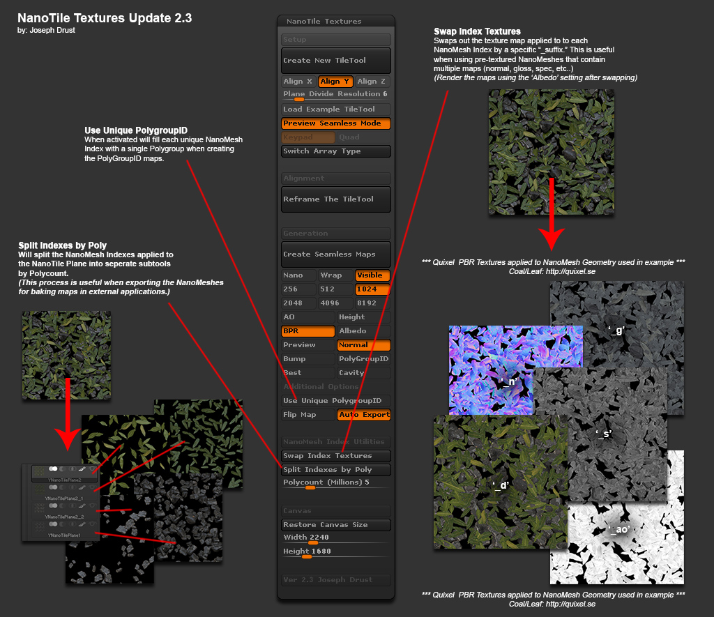

Soo
 This is a another big update that might break a bunch of stuff :slight_smile:
I added some NanoMesh Index utilities to help with pipelines using NanoMeshes that have texture sets (ex. Normal Maps, Spec Maps, Gloss Maps, etc
) Also added the ability to split the NanoMesh indexes up by Polycount for exporting and baking in other applications. (Polycount used is the one that will be created when converting the NanoMesh indexes to real geometry.) Hopefully these additions will help with large NanoMesh scenes and PBR workflows.
Example image of new functionality:
As always there may be bugs; so if you find any post them here and I’ll try to fix them :slight_smile:

Hi Joseph,
thank you for this nice plugin. But on my PC it does not work.
I use Win 7 64 Bit. And i unpack the Zipfolder in the ZStartup/ZPlugin64 Folder
After i created an Nanobrush, I click on “Create New Tile Tool” an i get this message:
Ok, press “T” and “F” and turn arround
, after some time i get the plane with 6x6 Quads.
I place my Tools as in the video https://www.youtube.com/watch?v=aG1PSVFyrB0
Than i am done, I turn on hight and press “Create Seamless Maps” and i get this message:
What I am doing wrong.
THX in advance
Tommy
@basquiat79: From the screenshot it appears that you only have one Subtool in the scene? The plugin relies on the file it creates when you click “Create new Tiletool.” It won’t work if you just grab a plane and start using it =\ Try running “Create New TileTool” then see if the “Create Seamless Maps” works for you.
-Joseph
