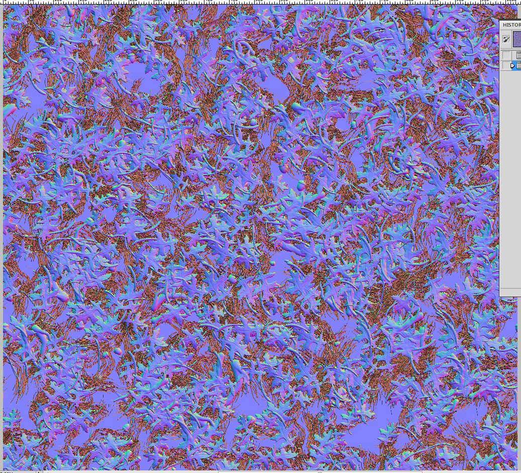

Piggyson@Campi: Interesting! I donât think I have ever used a single NanoMesh that is larger then 50k. The NanoMeshes are still looking at the max poly per mesh. So if you have 10x 500k NanoMeshes it will still be registering 5 million. It appears that the effect you are witnessing is the NanoMeshes reaching that cap. Iâll give it a go on my end.
Agreed 100k+ on a single Nanomesh is definitely a fringe case. I only subdivided it to show that the placement issues get progressively worse the higher the nanomesh resolution.
I had a case though where I placed a lot of rivets, so I created one poly per metal plate and created one nanomesh consisting of multiple rivets (all placed correctly in a square first then saved as n-mesh). The final resolution per nanomesh was roughly 11k and it was impossible for me to get the naomesh fit perfectly to each source-polygon.
It was only a small offset (again it gets worse the higher res mesh you are using as nanomesh) but it looked like the welder showed up drunk for work that day
I ended up using insertMesh instead manually dragging them into place but seemed like a perfect case for nanomesh if it would be working correctly

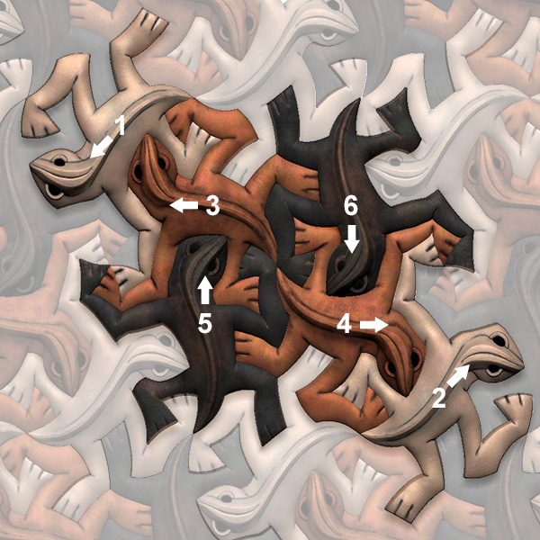

Now I search for the thread, where you had explained the technique, how to do this tileable lizard tool. Canât find it any more
Thx for your reply SPRINGFIELD-JACK!
But I think you misunderstood me, because I explained it bad!
Long Time ago there was in this forum a thread where he explained how he develop this lizard itself. Watch it in detail. The legs from the lizard grab 100% perfect in the other lizards head.
You can place full screen with lizards without overlaping any lizard. He uses a nice technique to do this tool, that he use as nanotile.
That was it what I searching for.
I understand this NanoTile Texture tool and used it, very nice and easy to use.
I just did a quick search for âEscherâ and âtessellationsâ and found this http://www.zbrushcentral.com/showthread.php?24902-2-5D-fun&highlight=escher along with many others.

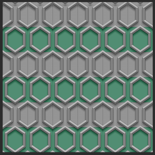

@willlord: For creating Hex patterns you just need to apply NanoMeshes in rows then use the âOffsetâ settings under NanoMesh. Below is an example of a quick Hex pattern using 2x NanoMesh indexes (notice the Polygrouping rows on the plane.)

I then broke the design down even further to just use 2 indexes. Below is a quick image of the break down; the original 6 indexes, then the final chunk used with 2 indexes.
(Escher was the true genius; I just dissected what he already figured out

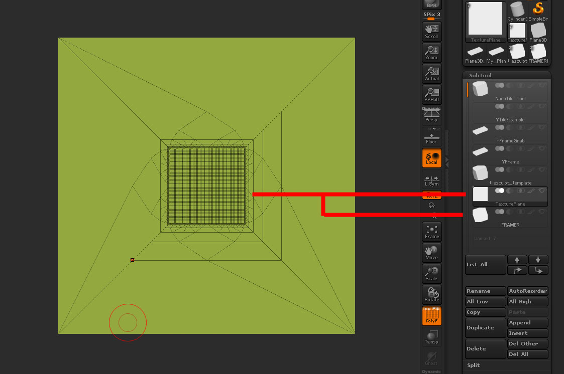

Hello Joseph,
I have appended my TexturePlane which uses unified space setup. With lets me
sculpt on the edges of my borders using brush/curve wrap mode. To frame my unified space correctly Iâm using
a FRAMER subtool.
The problem Iâm having is that when I turn on YtileExample and start playing adjusting nano-mesh.
and want to renders out my maps its not tilling correctly. Is this because of running the nano-tile
plugin it frames it on different size. Or are there other things I should consider/check? How
would I set this up correctly?
@decorix: If you can you PM me your TexturePlane Iâd be happy to take a look at it. It should work fine as long as the âmiddle geometry sectionâ is the same size as a Plane3D Object (if âWrap Mode 1â is working this should be fine.) The order in which you have it setup should be fine too. Just make sure that the top 4 Subtools stay the same (the script is using the order to process the framing.)
