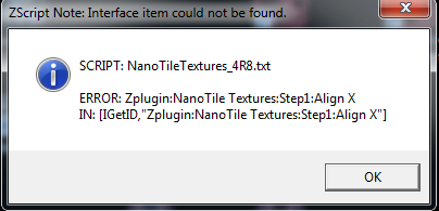

Hi!
I got the infomail today about the 4R8 plugins. After installing the NanoTile plug-in, I get this message when starting ZBrush:

incorrect install instruction/compiled:
NanoTileTextures_4R8.zsc move to %\ZData\ZPlugs64\ , not %\ZStartup\ZPlugs64\
UPD: Thanks Joseph for the very quick response - the problem is a unworking plugin in 4R8 - MatCap Baker for 4R7.

The issue displayed appears to be caused by conflicting 4R7 plugins being used with ZBrush 4R8.
With the changes that occurred with ZScript from ZBrush 4R7 - ZBrush 4R8 it is not advised to use 4R7 plugins until they are updated to function with ZBrush 4R8. In addition to this it I would also suggest not modifying the items in the ZData folder as it can cause issues with your ZBrush licensing :slight_smile:
An updated version of the NanoTile Textures Plugin is now on the ZBrush Download Center. This update should resolve the issue with the conflicting plugins. Hope this helps resolve the issues!

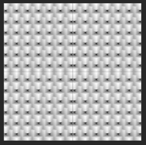

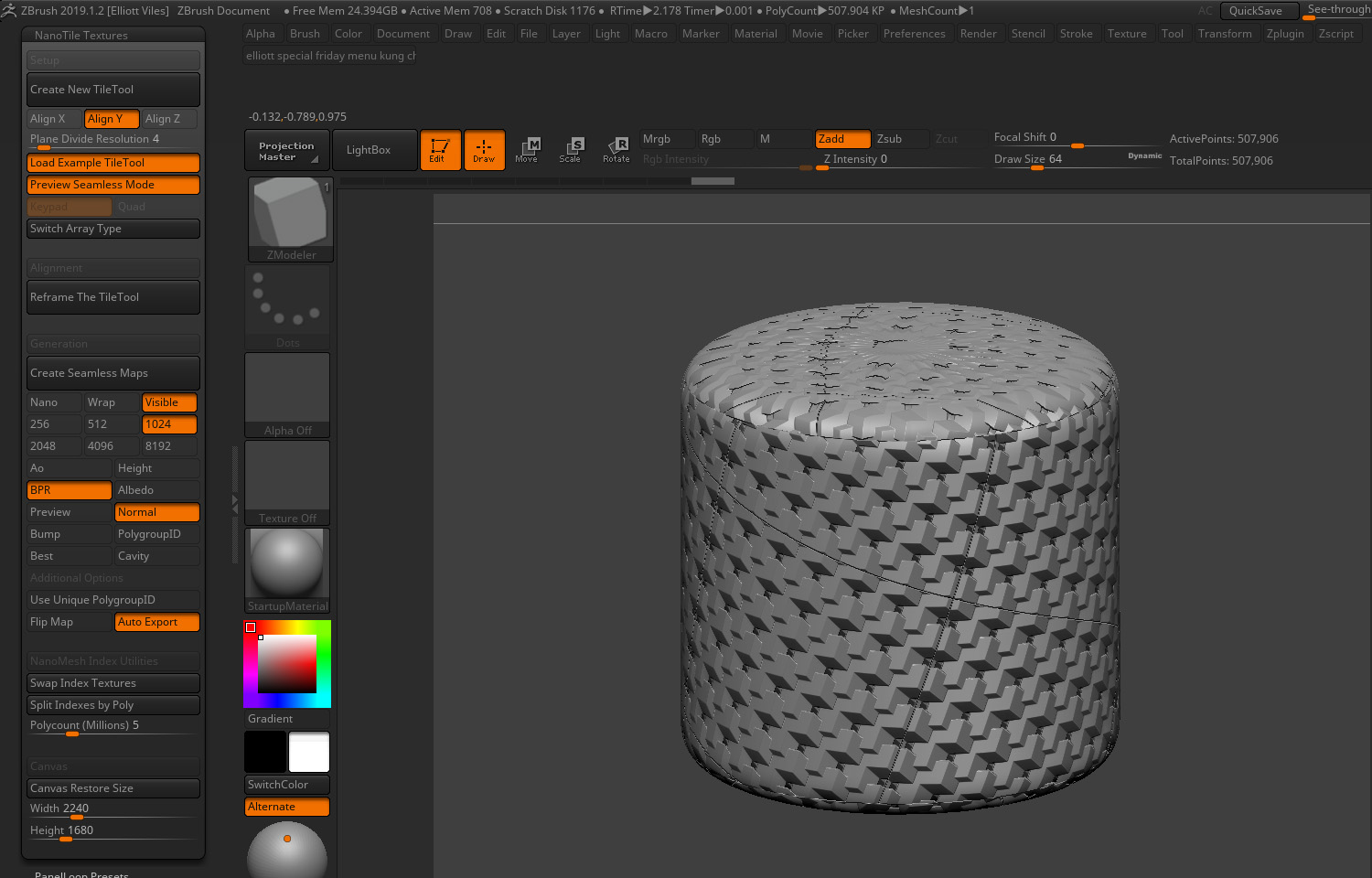

I have started experimenting with this however very quickly I have run into problems. I have followed the steps in multiple videos however I am not able to achieve the tileable result, I even loaded the example tile to see if that worked and it well
the results I have posted below. I am sure I am doing something stupid so please someone point this out many thanks! Nano_Tile_Tool_settings|1200x768 Texture_output_example
