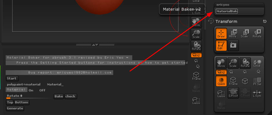

Installation Guide:
  1. Create a new folder and name it “temp” in C:\Program Files\Pixologic\ZBrush3.
  2. launch zbrush 3.1 and load the zscript “material baker v2”
  3. load in your model. Make sure u have ur polypaint done and material setting ready~
  4. Click on start.
When it prompt
“This image contains material-index imbedded within each pixel. Would you like to save the material-index as a separate channel?”
Choose YES. It wont do any harmful to the orginal setting
  1. It’s recommended to bake the four views: Left, right, front,back. You can rotate hortizontally mannually or use the slider to controll the rotation . Once you have ur angle, press the bake button .

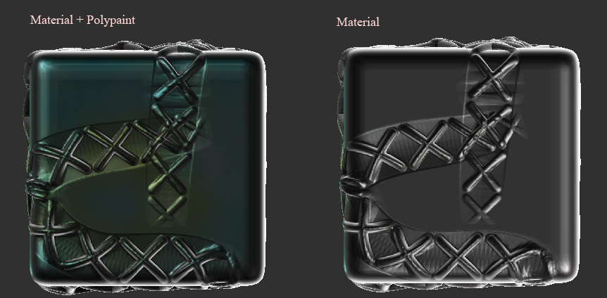

Difference between polypaint+material and material:
haha. I think dont have to explain this

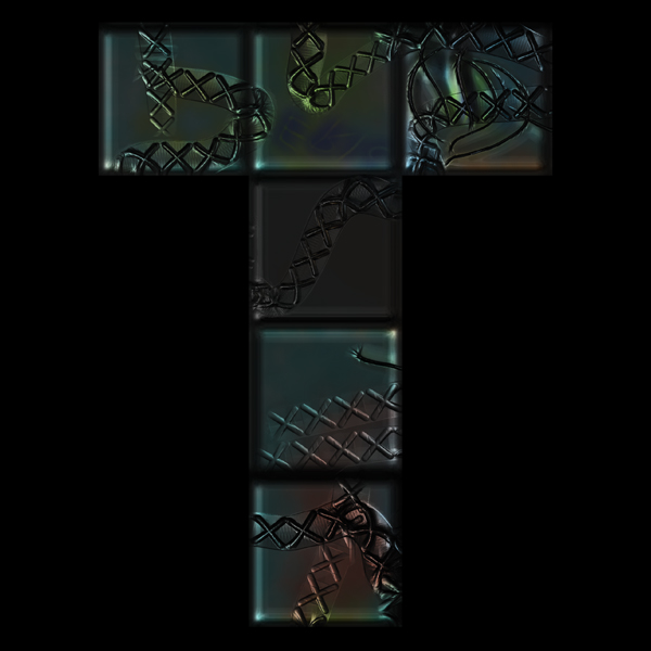

         First attempt bake with with organic model.
         Below model is in zbrush with flat shade, flat render with sub div 1.
         I used matcap and play with the material modifier setting. Changed color of Col and Base.
   I notice one thing~ Do bake ur model a few times(around 3 times or more) until it cant go any darker. It gives better color~ If u find any weird parts. u can go there and rebake that area.
           [![test.jpg|1050x800](upload://2T7lWv7yfKwBDcC3jkoooomDi8D.jpeg)]![color.jpg|600x600](upload://uO90rWm8tUESGgluYgK48u8c0dL.jpeg)

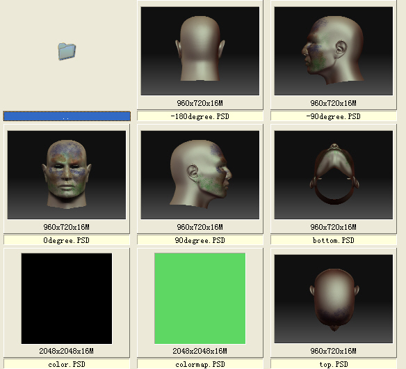

Hi ericyeo,
Thank you for sharing your modified script! It looks to be exactly
what I was hoping for (basically a way to get the matcap’s baked
into the actual texture map)…however, when using the script, for
some reason I’m unable to get it to generate the actual material to
1 single texture file after I’ve baked all 6 angles.
I’ve basically done what you’ve shown in the first post, and made
a cube with a similar ‘cubemap’ UV set. I am able to bake front, back,
left, right, top, and bottom textures, but when I generate, it only yields
a solid grey texture in the areas my UVs are. Any ideas on what
I may be messing up?

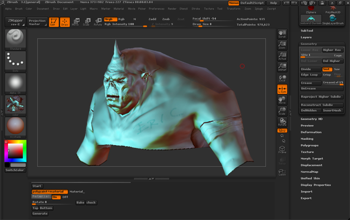

Hi All,
I seem to be having some trouble with this script. I apply the material I want to bake to the object, for instance the rs_sculpy material, then launch the script. When I hit start I get the following message:
Not sure exactly what that means, so I will hit no. Next I toggle on Materail_ button and click bake. The material switches to the default red wax for a split second then the “done” box pops up. When I hit “ok” I am left with the red wax projected onto my model. My active material is now called “myshade”, which appears to be rs_sculpy. Even when I rotate around the model I see the sculpy material in the unbaked areas. Its just when I hit bake, it is baking the default material. Here is a screenshot, any ideas?
wa… I found the bug~ my apology to those who have downloaded… Jaidek thanks. problem solved.

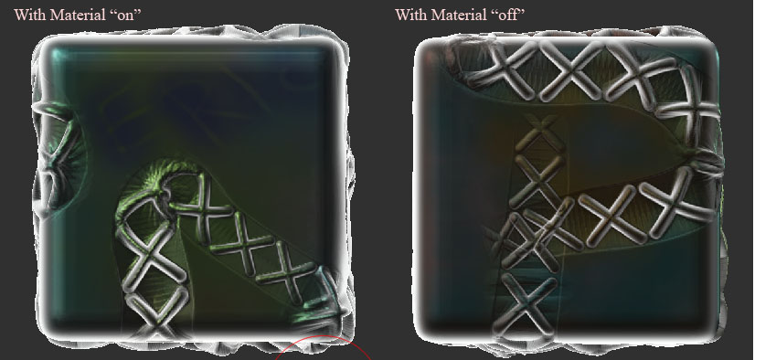

Hey All,
Thanks Ericyeo for the update. However, it seems to be doing the same thing on my side. I am able to get it working (both versions) as long as I have the Material button set to “on”. If it is “off” it still defaults to the red wax shader. Should it be doing this? As far as I can tell you would want to have this on always.

Jaidek: Thanks. I didnt notice it, cos I tested with material “on”. Sorry. Problem fixed.
