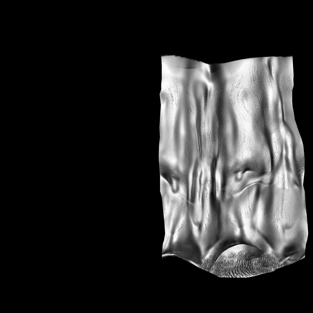

The .psd that the script is baking is missing color/material information in certain spots when I follow the exact instructions found on the script’s instructions page while baking the object. Thinking I could correct this issue, I decided I would try baking it from a few extra angles (in the first .psd outcome, I had only baked from angles 0, 90, 180, 270, top, and bottom. in the second .psd outcome, I also baked from angles 45, 135, 225, 315.). As you will see in a moment, that certainly did correct my missing color/material issues, BUT it made the texture MUCH MUCH too dark.

The outcome. As you can see, this texture is missing ALOT of color and material information in angles that I did not bake on. Since this is not right, I’ve added more angles in the baking process.
Here, I’ve baked from the extra angles I mentioned at the begining of this post (45, 135, 225, & 315) that were not listed to bake on in the instructions. This seems to be giving good results, but once I’m done, you notice the texture becomes dark in the angles that I had baked in the begining (0, 90, 180, 270, top, & bottom).
In this .psds it is clear that neither of these even resemble what my item looked like before I started using this script (see the first picture posted). These are both .psds laid out together so you can see what went wrong on both:small_orange_diamond:
As you can see, neither of these results is what I had wanted at all. One is missing tons of color and material information from not being baked in enough angles and the other one, well when I go back and bake the areas that are missing color information, it just starts making the areas I had already baked super dark. It never ends up evening out.

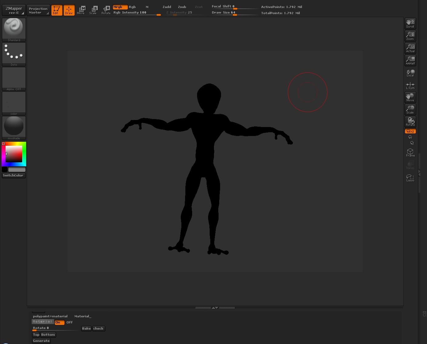

I followed the directions to a tee for this script, but in the end, I am left with a model that is all black. It has no shaders or materials…just black. Any help as to why this is happening???

got the same problem as iray i also get a black model the texture disapears completly

irahk and theeman, after bake just turn texture off or if you are in “check” status yet, just press the start button again and it will back to normal your model again :slight_smile:
