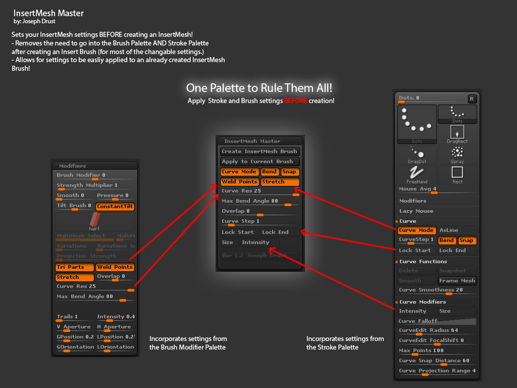

InsertMesh Master
(Ver 1.2 Updated 9/5/2012)
InsertMesh Master helps speed up the process of creating InsertMesh brushes. It combines settings from the Stroke Palette and the Brush Palette together and allows for these settings to be set BEFORE brush creation!
This plugin is unofficial.
Main features
  • Sets your InsertMesh settings BEFORE creating an InsertMesh
  • Combines the most changed settings in the Brush Palette and the Stroke Palette
  • Can also be used to change settings on an already created InsertMesh Brush
  • Examples of some of the changeable options:
[LIST=1|INDENT=2]
  • Curve Mode
  • Bend
  • Weld Points
  • Curve Resolution
  • Lock Start and Lock End
  • [/LIST]
    Usage
    Installation
    UnZip the attached InsertMeshMasterV#.#.ZIP file to your \Pixologic\ZBrush 4R4\ZStartup\ZPlugs\ folder.
    Restart ZBrush.
    InsertMeshMaster will be located under the Zplugin tab.
    Change Log
    v1.2: Initial Public Release
    Notes
    After making quite a few InsertMesh brushes I decided to automate the process of changing the settings in the Brush Modifier Palette and the Stroke Palette. The settings that are on the tool are the ones I tend to set the most. If you find that you want any additional settings added let me know =)
    Once again my Zscripting knowledge is average at best; if you find any bugs or other issues please report them in this thread.
    Thanks!
    -Joseph

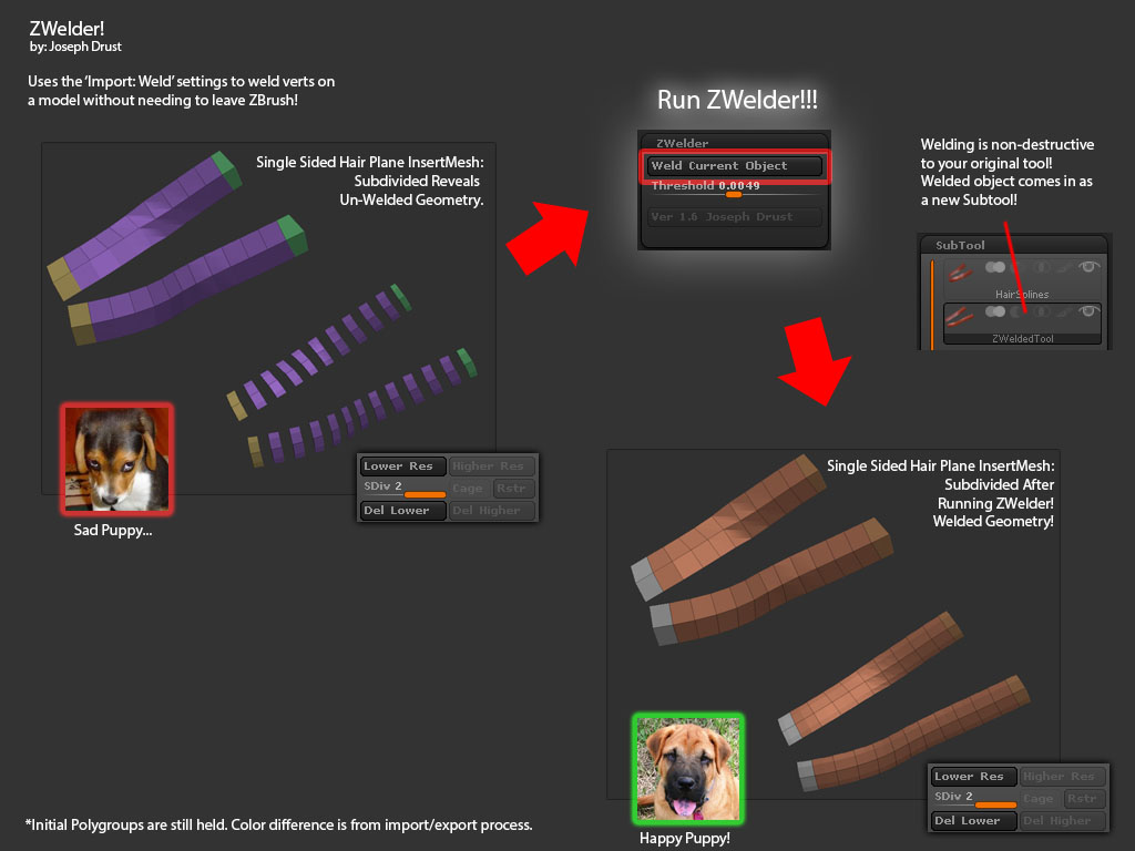

    ZWelder
    (Ver 1.6 Updated 9/5/2012)
    ZWelder uses the ‘Import:Weld’ setting to Weld geometry inside of ZBrush!
    Main features
    • Welds your geo without leaving ZBrush
    • Threshold can be changed
    • Welding is non-destructive; Welded objects are appended as a new Subtool leaving the original intact
    Usage
    Installation
    UnZip the attached ZWelderV#.#.ZIP file to your \Pixologic\ZBrush 4R4\ZStartup\ZPlugs\ folder.
    Restart ZBrush.
    ZWelder will be located under the Zplugin tab.
    Change Log
    v1.6: Initial Public Release
    Notes
    Thanks to the amazing Paul Gaboury for the idea behind this script! Also thanks to Iván B for letting me use images of his Anillo (ring) model that is shown above!
    If you run into any issues let me know and I will attempt to fix them! Hope this plugin helps! (Instead of starting a new thread for this plugin I decided to just attach it to the InsertMesh plugin thread :slight_smile: )
    Thanks!
    -Joseph
    ZWelderV1_6.zip (43.6 KB)

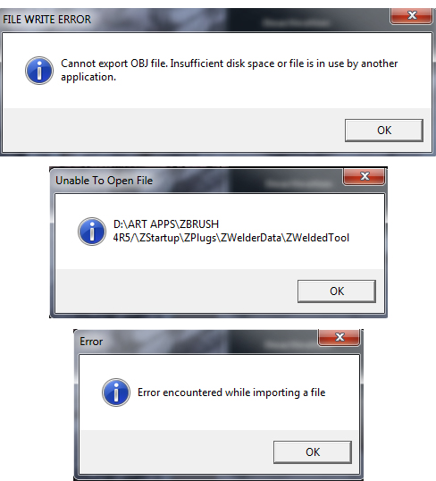

    I’m getting the following errors when trying to use zWelder with 4r5. I really like and use this plug a lot so I thought I’d show the errors in case there is a fix. I get these errors on any given object. Its always the same errors. I didn’t get these in 4r4. The errors occur in order from the top down.
    Windows 7 64bit.
    Thank you,
    Ron
    Please disregard. I had the plugin only in zBrush 4r5\ZData\ZPlugs and not in zBrush 4r5\ZStartup\ZPlugs. It works fine now.
