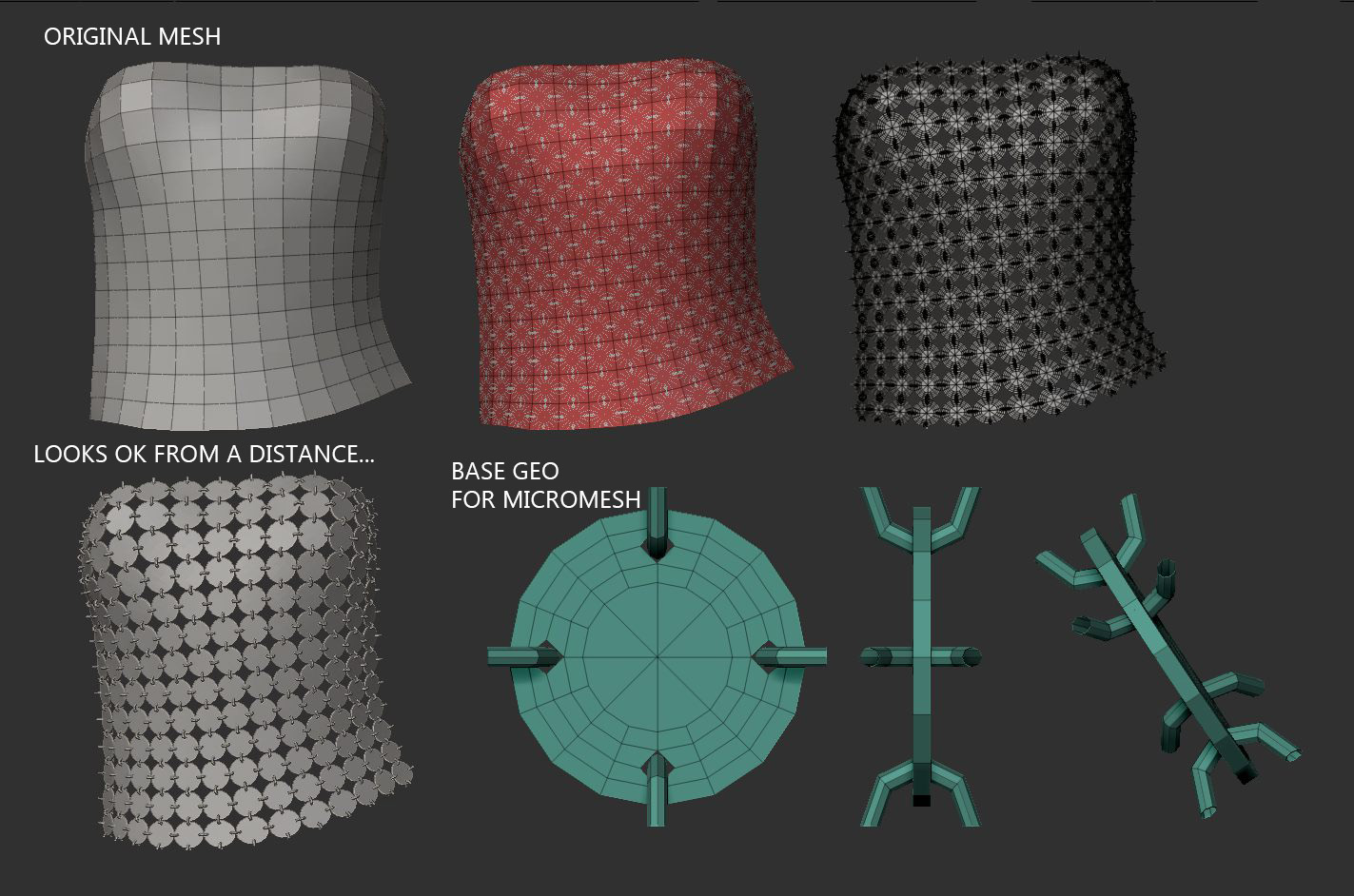

Hey there!, thanks for the awesome plugins. I am having and issue with micromesh and welding these coin pieces. I have tried many things, even going out and trying to weld the open edges in an external software, and cant make it work, still would love to fix this just with zbrush, I cant figure out what i’m doing wrong. So here are some images.
I highly appreciate any insight into what i’m doing wrong or overlooking. By the way I also get the error tonare mentioned before though I do have zwelder installed in ztartup/zplugs folder.
Thanks

The problem you are running into is two things I think, the first is that your object is not welding correctly because you have not used the Spin Edges trick to get everything pointed in the same direction (this is a guess on my part).
The second problem COULD be that its simply too tall (in Z relative to the center of the object its being applied to).
Bare in mind here Im kind of guessing, Im dealing with the same sort of problem. I don’t know enough about this to say any of that as fact.
Look though at the Spin Edges part of that video, its towards the end, I think that could help a lot.

I’m positive its not the spin edges, since I did know about that and tried that also. Maybe it’s the second thing u mentioned. What is really curious is that some parts do weld while others dont. I have more projects on my hands at the moment and haven’t been back to solving this. But will certainyl do so at some point.

Confirmed: yes ZWelder works with Micromeshes. I run 4R6 W64. I tested it on a dozen different square/circular mms, no spin edge, all sticks. Only minor issue is Zwelded MM subtool won’t keep initial micromesh polygroups.
Zwelder is definitely stickier than Zbrush’s own Micromesh>Weld Points, which only welded one out of my dozen squarish micromeshes.
Zwelder is also more efficient in optimizing BPR2Geo micromeshed subtool than Micromesh>Optimising Points.
Micromeshes must be even on all 4 sides for any welding operation to work. My take on why some MM sticks and some won’t, is sizes. Too small or too big/overlapping, no vertex to cling to. X Y must have perfect symmetry. Regardless, Zwelder welded what Zbrush Weld Point failed to weld. Setting ZWelder threshold higher seems to ensure overlapping and welding success, even if it’ll lessen overall uniformity, something I can live with.
