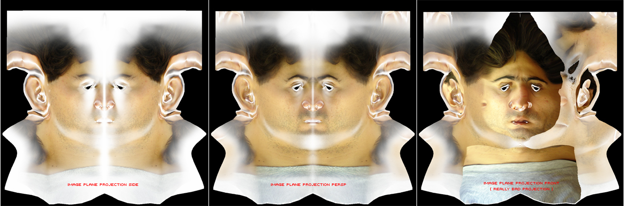

Hi, thank marcus. Image Plane is a great plugin and very useful!!! Thank you very much!!
I’m from Argentina, I hope that my ā€œterrible englishā€ could be understanded. :confused:

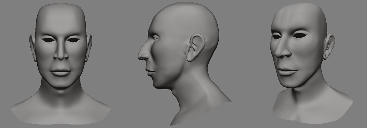

So, I’m trying to do something similar to video tutorial of ā€œTexturing with photo referenceā€. But I’m still with some questions about it.
From the beginning, I’m getting these material images in my experiment. Following the tutorial steps, I can get these results…
Model:
But my question is: How to mix the diferent images projections (from ImagePlane+ProjectionMaster) in photoshop to get similar results? It’s suppose a very difficult task, I mean… tricky white areas in the cheen, ears, eyes… etcetera…
When I play the second part of the tutorial, when the guy explain, "Āæhow can we get more detail in the model through alpha channel generated from the images?..
he doesnĀ“t show how to fuse the layers into one composition Image texture (in photoshop). It was very perfect projection, with no seams problems, no hole, no white areas…
I’m using XSI for modelling.
  • Headus UVLayout for UVs.
  • Pictures resolution: 2304 x 3072.
What do you recomend me to get similar results?
Maybe, Are there some problems with pictures reference?:laughing:
So, thanks a lot…
Cheers!! and Happy Xmas Pixeling!! lol :wink:
