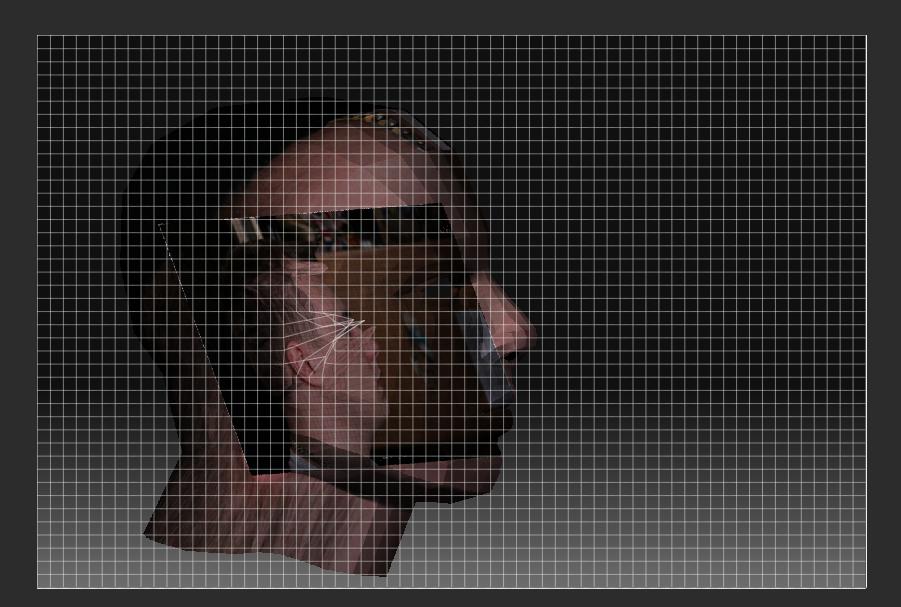

I have a problem everything is fine but when I would like to move the texture I have a wireframe of the plane and its hard to fit the texture to the model. Is there a solution for this? Picture better describe the problem. Take a look
I have a 2 gigs of ram and my reference picture is only 2048x1024
Ps. in Zbrush 2 everithing is fine.
puki,
My answer two posts above yours, the ADots slider is about this issue.
I should add that this is a way ZBrush preserves system resources and keeps the program responsive. When a model is scaled beyond a certain threshold, it switches to dots display mode, which displays it just as a wireframe – but only while you’re interacting with the object. If you stop moving it, the object draws in with full shading. Adjusting the Preferences>Draw>Adots slider adjusts the threshold.
