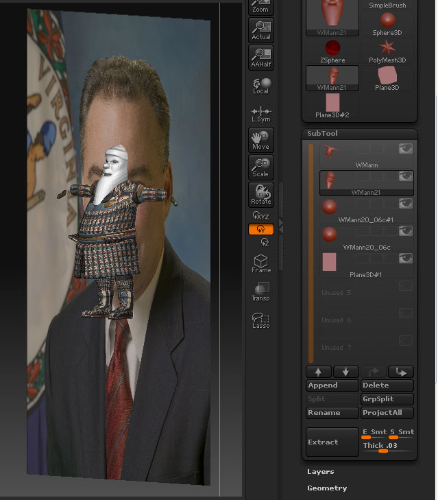

I try to use ZProject with ImagePlane.
But I have a problem with scal the plane to the size of the head.
I want to paint face texture and displace.
How can I scale the plane ?
I read in forum-search the transposetool only works in polymesh objects.
It dont work here.
I read in this thread something about resize canvas document, but I dont work, too.
Any Idea ?
In the Tutorial http://www.zbrush.info/docs/index.php/Tutorial:ZProject_and_Adjusting_Photo_Reference
is the answer: Deformation Tools.
I have try this some times before - ZBrush crashes.
But now it works
Why, I donāt know.
But now I can use it !!!
Thanks for Image Plane Plugin
Jack,
Thanks for your comments and Iām glad you found the answer.
One way to avoid the crash is to do this for the plane (or any new subtool) before using the Deformation sliders for the first time:
Select the new subtool.
Press Tool: Deformation: Unify
Press Edit: Tool: Undo to undo the unify action.
HTH,
