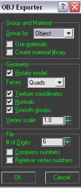

1: Build a low poly mesh in Max: (See pick below, taken from the “ZB Practical Guide”). You can easily do this in Max in no time. Or learn to use ZSpheres which gives very nice results.
It is very important to change the # of digits to 6 (in the file section), the default is 1 otherwise your UV map created in max will not transfer into ZBrush correctly!

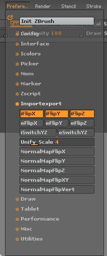

a: First open ZBrush & set these options in the preferences menu in ZBrush before you import your Max mesh. (see pic below).
Ok so this is pretty obvious:roll_eyes: .

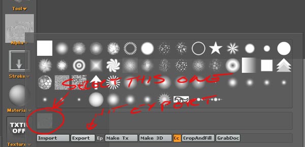

b: Next you want to create your displacement map in ZBrush. Expand the “Displacement” rollout in the “Tool” menu. Change the DPRes to 2048 if you want a fairly detailed deplacement map (you can choose for higher if your computer can handle it). Personally I leave all the other settings alone as I have not seen any notable difference in ramping these up or turning them on with the 3dsmax Displace Modifier. I’ve tried rendering out with DPSubPix at 4 but have not seen any difference in my renders from Max.

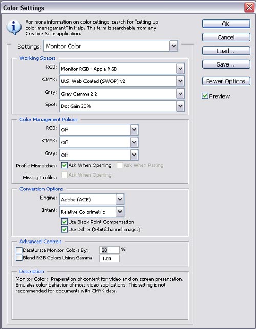

b: Next you need to convert this displacement map (TIFF) to RGB colours (this stops Max and most other apps from stepping your Displacement map (no jagged edges)). The instructions are as follows:
Image>Mode>RGB Colour.

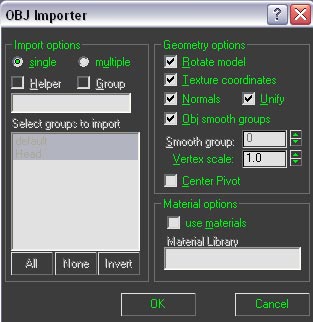

7: Start Max up. If your are using Max 6 and below install the “Habware” OBJ to Max import plugin to your 3dsmax Plugins Folder (Max 7 has this as a standard export option).
a: Import the OBJ file from where ever you saved it. File> Import etc.
b: You will be promted with this dialog (See pic below):
Use these settings above.
