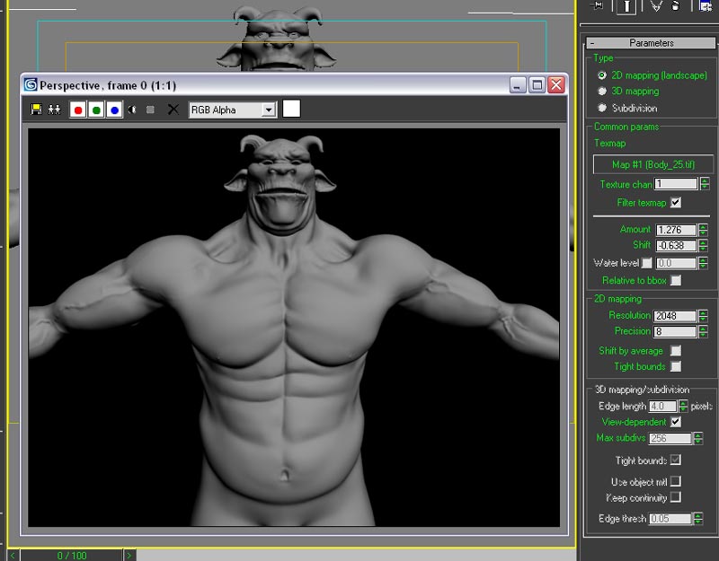

Can you give some examples of intersections of the mesh when using displacement with vray? I havn´t had any problems. Probebly you didn´t use shift in Vrays displacement modifier.

I stand corrected;) . Numse I have been using shift, but not with the right Amount & Shift settings.:roll_eyes:
Anyway, with the correct settings taken from the OBJ file, Vray will render without bloating and is very easy to set up. It is not as fast as the scanline which is a surprise (default lighting for both) considering the scanline mesh is 1,200 000 polys and the vray 302 000. Although I had a large res in the Vray Dis mod 2048.
Here is the result with the settings on a character I’m working on:
Don’t take these settings as the bible, or what you should use, they are just a guide, oky doky!

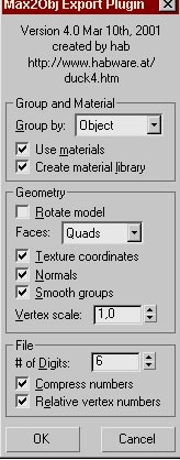

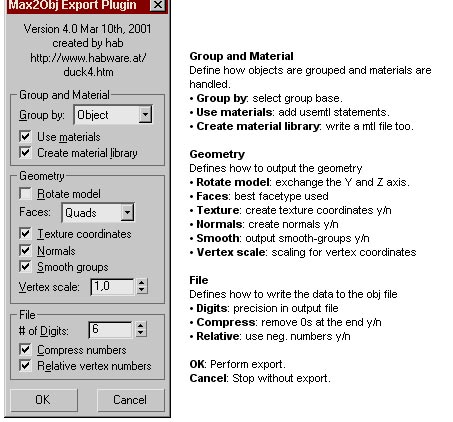

Hi,
I have learned so much from here but this is my first time post a question. (By the way, you guys are wonderful to offer your knowledge.) I just switched from maya to max and I found this problem of exporting obj file in max. I followed the setting mentioned above and it solved my problem but I still dont quite understand what the settings mean. When I exported a mesh with compress numbers and relative vertex numbers checked and imported to zbrush, it became a mess. Only when they are unchecked it will be imported properly in zbursh. Can you quickly explain why? Thank you!
Nan
Here you go nan, this might explain these settings and what they do:)
