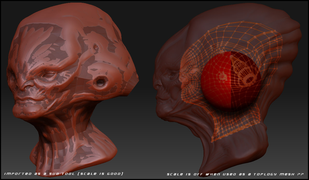

Ok so I have followed all of the steps but I am running into a scale issue. Perhaps you could tell me what I have screwed up.
  1. So I have my original model (Hi res detail) loaded.
  2. I have my retoplogized mesh )Lo res mesh) loaded.
  3. Draw the zphere.
  4. Go into the rigging section and use “select mesh” and select my Hi Res Mesh.
  5. Go into the Topology section and use the “select Topo” and select my Lo Res mesh. (resurfaced mesh)
Everything loads but I have a problem.
The scale of my resurfaced mesh (Lo Res mesh) is off for some reason. I have checked the scale as a sub tool and everything lines up just fine. I have even checked the scale as a sub tool and then saved that out as a .ZTL file and used that mesh, but the results are the same.
Wondering if you have run into this or not.
Thanks,
NickZ. :slight_smile:
@ Nickz:
I have just rechecked my setup with the demo-head from my tutorial, it works without scale problems.
I only had this scale thing when I exported the retopoed low-poly as an object and imported it again.
With saving it directly as a .ztl the scale issue didn’t appear again.
Try this:
  1. Be sure that you have turned off any transpose translation/scaling - line.
    Therefore go within your original model into move,scale or rotate-mode and LMB-Click once on any point of your mesh.
    The transpose-line should now disappear.
    Now do your retopo-work.
    When you created the retopoed low-polymesh, check this again for that mesh before you store it as .ztl or export it as an object.
If this does not solve your problem, try this:
  1. Use the retopoed low-poly-mesh directly without first saving and reloading it.
    If any transpose line is turned off before you do any retopo-work, you should have exactly the same scaling between the original-mesh and the low-poly-retopo-mesh.

Thanks again bud! This is great! I got it to work. I had to use the “make polymesh 3D” (In the Tool palette) on the resurfaced mesh that had the correct scale. I then saved that as a .ZTL and then used the Load Tool to bring it back intoZB. Now my model had the correct scale and I could go about using the retopology detail projection method that you outlined.

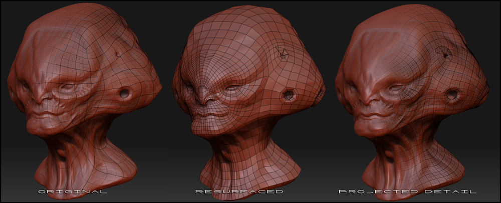

[attach=63945]alienHost_retop_final.jpg[/attach]
I hope this gets highlighted somehow because this is a HUGE workflow improvement. Now you can sculpt as a concept, not worry about topology, retopologize, capture that detail and then start to go to town on the final mesh.
Oh this is so cool…I feel like a ZB fan boy now.
Thanks again,
NickZ.

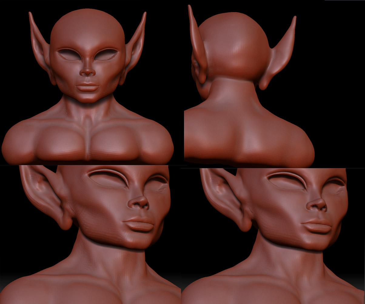

Well, I gave it my best… but I haven’t got the results I wished. Here’s a large picture to show what I mean. First the original:
[original.jpg](javascript:zb_insimg(‘63962’,‘Rastaretopo.jpg’,1,0))
I can only correct those artefacts by using smooth brush and elinating the fine lines and details I’ve worked on so hard. :frowning:
It’s quite demotivating. I love to continue on this model, but I can’t without knowing if I can connect the different parts together without loosing so much work and effort.
All in all thanks Rasta for thinking out yet another option. Do you think there’s a way to get cleaner detail out of my original mesh into a retopo-one?
