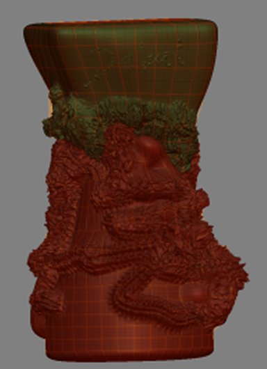

Easy Retopologising models preserving the fine-detail levels (by Rastaman)
Solution for retopoing high detailed merged meshes:

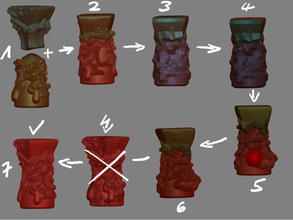

  1. You have two (or more) separate meshes with high-poly-details, whether they have lower subd-levels or not,whether they are mostly identical in their subdivision or not, this doesn’t matter.
Make one the active tool and all other parts the subtools (Tools -> Subtools -> Append) of the first and sculpt, move and scale them just as they should be in the later merged final mesh. The border where they connect should be sculpted as good as possible to already match the later outline in this area. This saves you some extra work when you later retopo.
Perform Tool -> Make PolyMesh 3D for all in their highest possible detail-level.
If you have lower subd-levels on them, do that again for all in their lowest subd-levels.
  1. Now we bring them all together into one single model ( a high-poly and if available one further low-poly-model). Therefore choose one Polymesh you just created and insert the others of the matching poly.level with the Tool -> Geometry -> Insert-mesh-command.
  2. Do that for all the high-level as well as for all the low-level Poly3D-Meshes.
Now you have one single high-poly-model and if available furthermore one low-poly-model.
  1. If you have the low-poly-model, then do the retopo-work just as I describe it in the tutorial, make Adaptive skin and
5)+6) use it for the described detail-transfer-procedure in conjunction with the high-poly-mesh.
If you have only a high-poly version, then you have to use this what means you will not be able to use the quick Shift + LMB-Drawing method but instead you must create all topo-lines by freehand onto the already high-poly-surface. But you can already use the Tool -> Rigging -> Projection function and transfer all details directly onto your new retopoed mesh.
:-1: On very complex and fine details, sometimes wired result can occur in the ‘a’-preview. In that case lower the value of the Tool -> Rigging -> Projection strength.
You can later reveal missing details with the Morph-Brush if you previously stored the morph-target in your high-level mesh before you enter the detail-tranfer-setup.
  1. If you worked according to the procedure described in my tutorial, you will have now at least 4 subd-levels with all details transferred to the new clean merged mesh. :smiley: :+1:
One further explanation:
My descriped setup for the detail transfer will always produce a new mesh with 4 subd-levels, regardless if the high-poly-mesh had lower subd’s or not. :bulb:
This is the reason why this method also works in this special case as well as with any mesh of any poly-count. When calculating the final projected mesh, ZBrush also calculates max.4 Subd-Levels downscaling from the high-poly-status if you set the slider in the Topology-Tab.
All you need is a high-detailed mesh where all parts are thrown together into one model that can be choosen in the Select-dialog of the Rigging-panel for the zsphere-setup.
The low-poly-version is not a must, it just makes the whole retopo-process much easier and quicker because you can use the quick-retopo-drawing-method along the low-poly-structure instead of doing all the work by freehand. But you definetly don’t need it to transfer your high details into a new retopoed mesh.
If pixologic upgrades the calculation to more subd-levels, this method would be really 100 % perfect. But so far, the lowest 2 or 3 subd-levels will always miss (when you used a Level 6 or 7 mesh). So, 80 % perfection is not soooo bad, isn’t it ?:laughing:

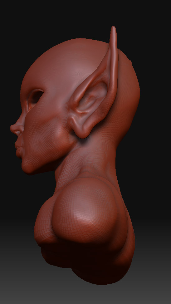

Rasta, you are getting me all excited! I’m trying it right now, but I must be doing something wrong. Here’s what I did:
[wrong.jpg](javascript:zb_insimg(‘63999’,‘wrong.jpg’,1,0))
A. I made a high poly version of the two pieces in one object, and a low poly version (not shown).
B. I made a retopo of the low poly version with a transition from head to neck. The adaptive skin preview gives a nice merged neck area.
C. I pressed make adaptive skin.
D. The step that doesn’t work out:
I selected my high poly version of two pieces in one model. (the one shown in A.)
I select a ZSphere
Under tool:rigging:select I select the same high poly model.
Under tool:topology:select I select the adaptive skin model shown in C.
E. I get the same model as in A, with an neck area that can’t be merged!
I suspect the fault to be in step D… Can you spot what I do wrong Rasta? If this would work I’d be ever so grateful…
Apart from this: I never knew Morph brush could help in all this: how does it work exactely?

@ WailingMonkey:
Of course it is possible to reimport new UV’s that you created whether inside ZB or outside with another app. Go to Plakkies Topo & FlowLab-Thread and read my post for that issue from 1 or 2 days ago. Another member asked there the same.
Now to Plakkies problem:
Plakkie, for a clean result you have to sculpt the both parts (Head and Torso in picture A.) already when they are 2 separate parts in that way that there is a smooth transition between the two models on their borders. You have too big and sharp angles there, so you will always get those unwanted wrinkles, no matter what you try.
Please look again on the pictures and the text above, I described this in step 1):
The border where they connect should be sculpted as good as possible to already match the later outline in this area …
But you can also use the smooth-brush there and reshape this area in the final retopoed-version.
Go down the 4 new subd-levels and work through each level to get a clean and wrinkle-free area.

Aaahh, one more thing, Plakkie:
Your picture D. is not as it should look when you followed my workflow.
There is an major fault and I suppose this is your problem right now.
When you rig up the high-poly-mesh with the zsphere and load the low-poly-mesh in the topology-selection, you should see exactly the same low-res-topology than in your picture B.
The resolution of the yellow topo-mesh in your picture D. is much to high, and I assume you selected the wrong mesh in the topology-selection-dialogue.
It looks for me that you selected in both dialogues, rigging and topology, the same mesh, the High-poly !
Then your wrong result is clear, because the high-poly-mesh contains polys and points that go inside the the structure because although both parts are inserted in one model, they are still totally separated structures with different topologies !
Then you get as result exactly the same model that you put previously in the process, a duplicate of your original high-poly-model, containing two separate meshes that only stick together, but are still departed.
A right setup should look like this:

OMG!!! Rasta, I think I took the right model for the topo information, I can’t be certain, but I did it again just now, and now it works!!!
[right.jpg](javascript:zb_insimg(‘64005’,‘right.jpg’,1,0))
Rasta, you are a life-saver! Thanks so much for thinking along and presenting a quite easy solution. Means a lot to me to be able to continue this project knowing I can join the head and body later on without a problem.
There are two minor glitches in mouth area, but I’m confident I can solve that with a better topo.
One thing: I only got 2 subdiv levels out of it. Not much of a problem for me, but shouldn’t I get 4?
Again, many thanks!!! :+1: :+1: :+1:
Plakkie
Glad that it works now.:smiley:
