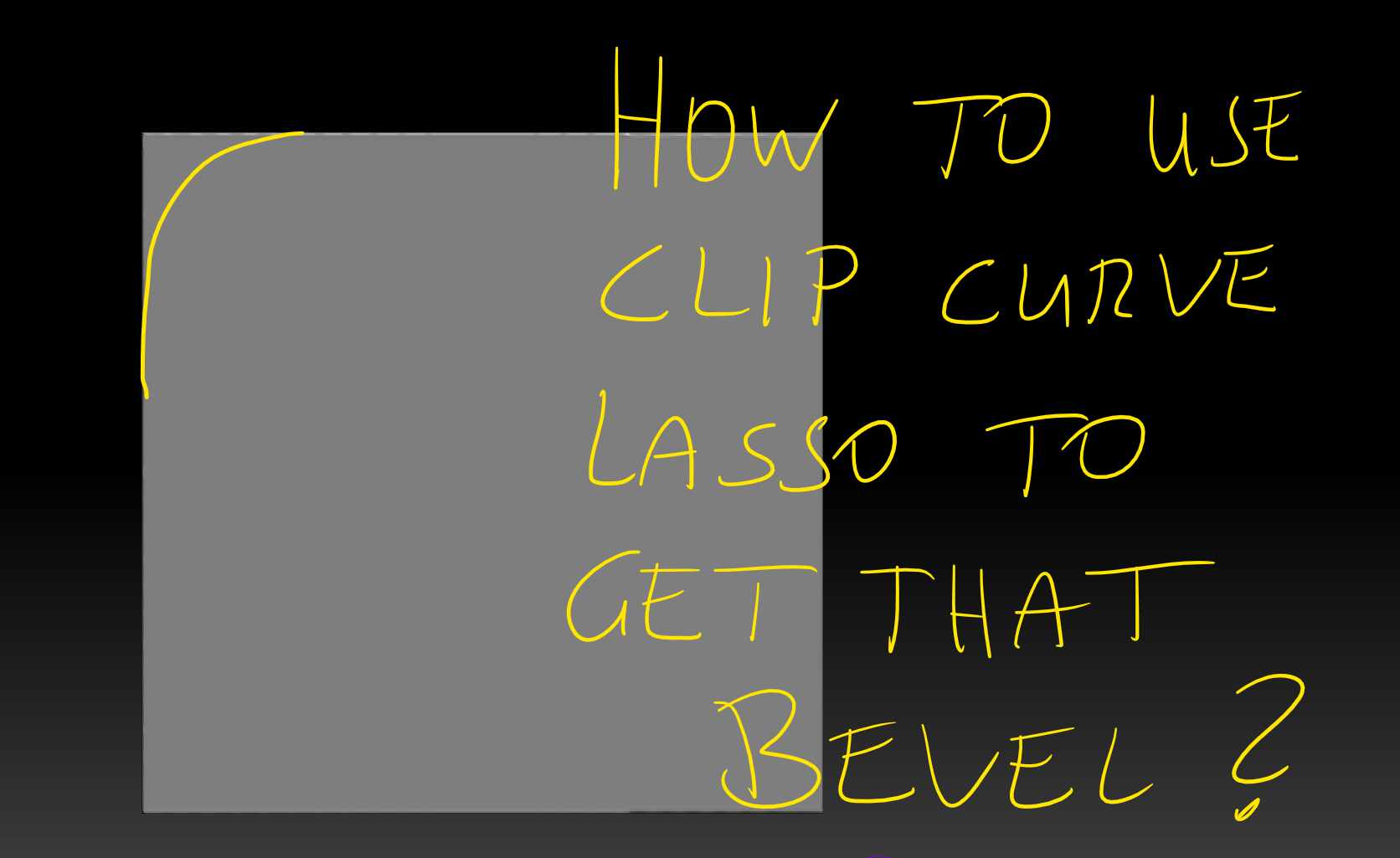

No matter what I do, I can’t control the Lasso and Curves to bevel the edges that specific way. Is there any clear video instruction that would showcase how to use that tool properly, to control any angle, any bevel you want?
For example:
Where to start the first “click” and then click ALT for the Curve?
sorry, can’t get this done.

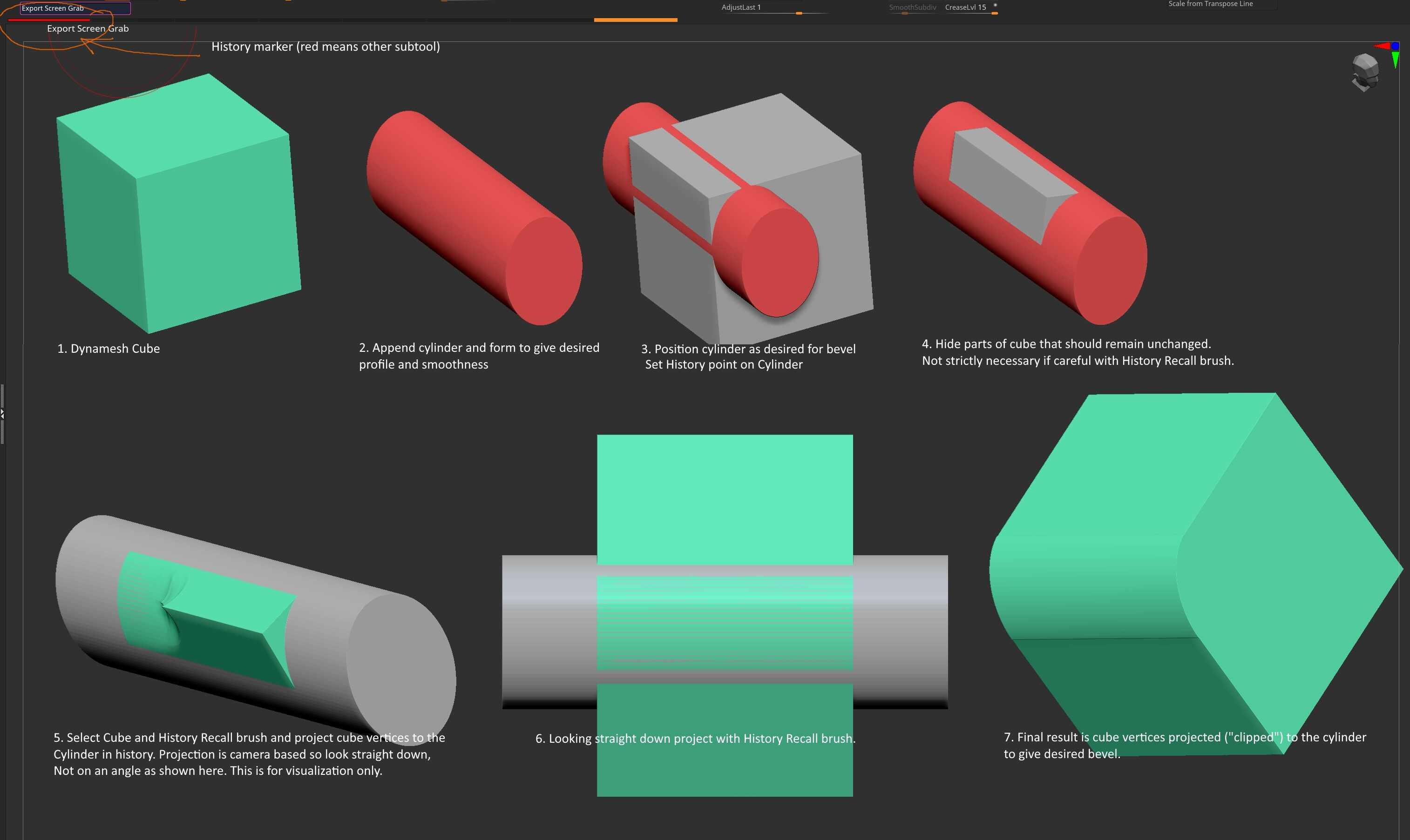

A better way I think is to create a body that has the desire curved face. So for your example I appended a cylinder subtool. Subdivided and scaled in X&Y to give a nice, smooth elliptical surface, and scaled Z to be larger than the cube. Then positioned the cylinder subtool so it was tangent to top and siude surfaced of the cube, scaling size if the bevel was too large. Once in place, add the cylinder to the History by Ctrl-click on its undo history. Then select the cube and with a large History Recall brush, project the cube vertices to the cylinder face to make a nice, smooth, bevel tangent on two faces. Could do the same with a sphere to make a beveled corner. It’s pretty easy to do and much quicker than typing out the instructions in this email. Much less frustrating than trying to use the Clip Curve brush.
Alternatively, set the stroke to circle, hide everything except the corner you want oto bevel up to and including the tangent points, and then draw out a circle/ellipse, size and position to get tangency (or near enough) and clip away. Still pretty fiddly, and not repeatable if you want the same bevel elsewhere.

Not video but this annotated image sequence shows what I described above.
Bevel by History Recall

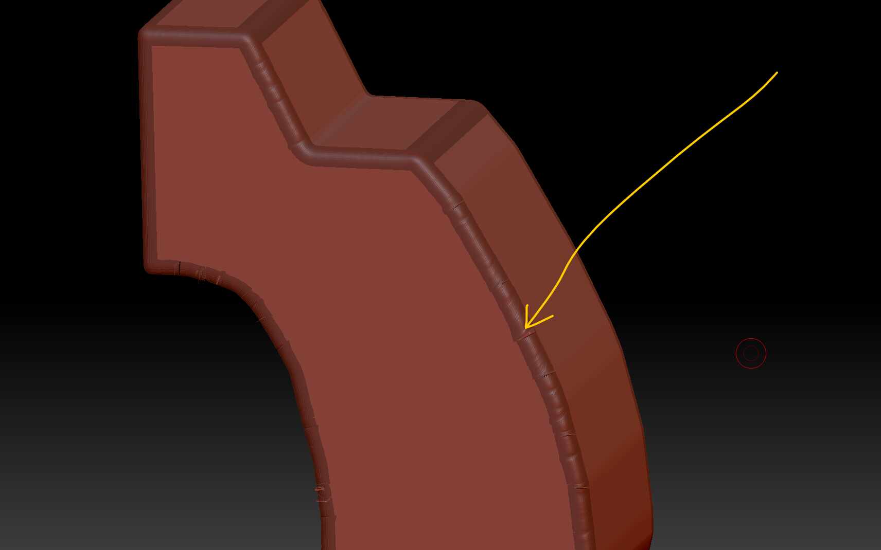

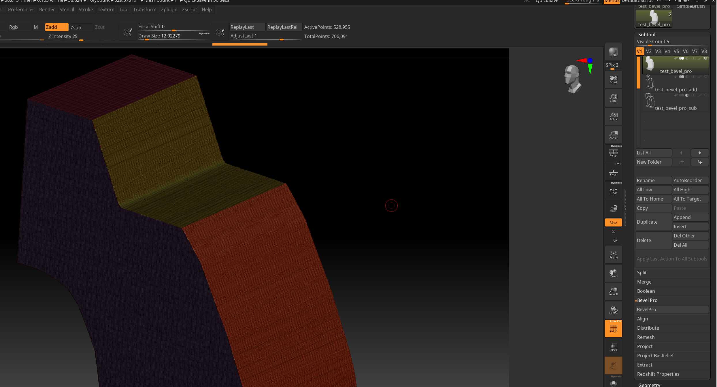

I am currently trying Bevel Pro and all attempts fail 100%.
Check out the simple shape I created, Dynamesh increased to about 600k points.

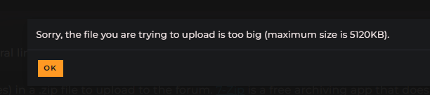

I thought I am going to upload the file for you, but man.
You can’t upload .ztools and files are in general limited. This really sucks.
Could Maxon provide somehow some space for that?
anyways, look at the screenshot. Bevel Pro totally fails on creating any useable Beveled Edge on this tool or geo. Even so, I increased the Dynamesh to 600k.

You have to put any files (other than image files) in a .zip file to upload to the forum. 7-Zip is a free archiving app that does the job very well.

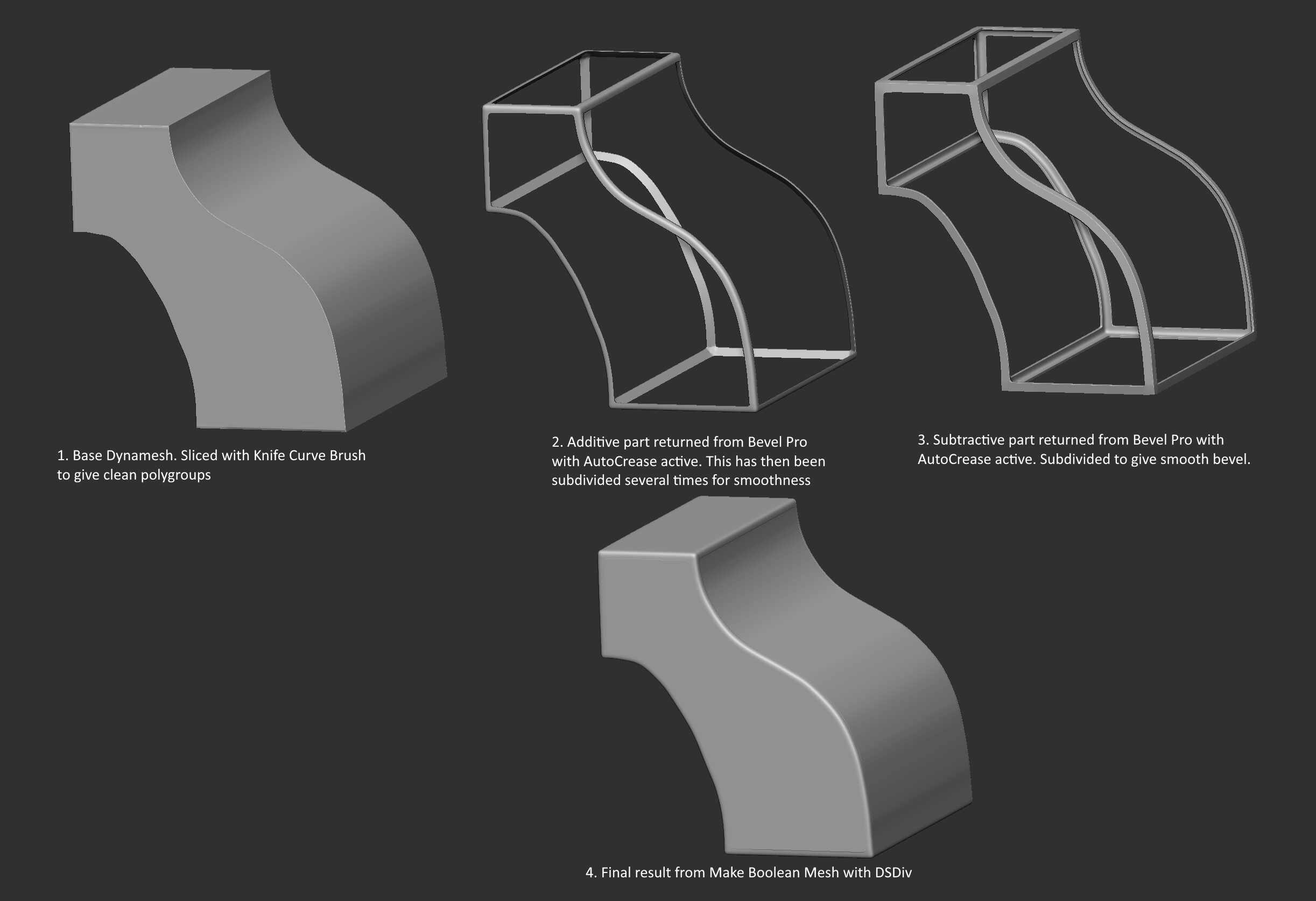

Here’s what I got so I’m sure you can get the same result.
Default cube, dynamesh res about 400, cut with Knife CUrve Brush to give clean polygrouping, Bevel Pro defaults but unchecked the triangle options in Advanced Settings so the additive and subtractive tools are quads and can be smoothed nicely. AutoCrease preserves the hard edges.
Make sure to watch Bevel Pro videos by Michael Pavlovich. He goes through all the settings and best practice in detail.

thank you @zber2 and yes, of course, I .zipped the .ztool file, but as I mentioned before, the upload size is limited, which is a problem.
I would appreciate it if the upload file size in the forum could be dramatically increased.
thank you @Spyndel I have been using Dynamesh, and Dynamesh has already 530k active points. Should be dense enough.
I am not sure how Bevel Pro is using the Polygroups itself, I guess it would be very helpful to see your poly groups on the mesh you posted, or also if you can share your ztool, so I can see the difference.

I’m not sure what I’m looking at here. It appears you have a separate inactive subtool that is overlapping the active subtool at the edges. Switch on Solo mode so that you can be certain you’re only seeing the active subtool. The situation in the screenshot could be depicting a mesh with properly beveled edges that you simply can’t see because the other subtool is obscuring them.
This could also be the result of your Bevel Pro settings. If Auto Apply is active, Bevel pro will perform the cuts automatically and change the original mesh that was sent to it. If that button is not active, it will create the bevels non-destructively as a separate mesh subtool. In that case you will need to manually use Live Boolean to subtract them from the original mesh. It may be this subtool that is interfering with your display.
Your polyrouping will control where the bevels are placed. BP will generate them along polygroup borders, much the same way ZRemesher works with the “Keep groups” option.

@Spyndel what you mean you are not sure what you are looking at? I provided the subtool, and you can see it’s just one tool, I applied the BevelPro to it as intended, it creates the two separated subtools.
I just kept the subtool in the file, so you can see the result Bevel Pro created.
Does this make sense?
So that’s how it looks after using BevelPro.
And yes, Auto-Apply was not active for the file I uploaded, clearly to see.
I am assuming you didn’t get a chance to download the file and to open the ztool in zbrush.
And also yes, BP should generate the bevels along the polygroup borders, but I uploaded the file for you so you can see it’s failing.
Please check the file I provided, then I guess it’s obvious.

But you know, make them clean. I don’t exactly know what that means?
The Polygroups are pretty nice, made with a Normal Angle Threshold.
How else should I create the Polygroups?
Edges should be polished before creating polysgroups when using Dynamesh?
Or what’s the key here for success?
What am I missing here?
How should the Polygroup edges look like that Bevel Pro can perform the operation?
You are also pointing out, I have only 6 Polygroups.
Yes, for each face I guess. Why would I need more?
thx a bunch for your help, appreciate it!

That’s correct, I did not download the file. For me to examine the file you would need to submit a ticket at Maxon Support. Technical support for ZBrush is provided there for registered users of ZBrush. Security, privacy (yours), and license verification issues prevent us from conducting it any place else.
So failing that I can only try to help you create a successful beveled mesh with Bevel Pro that you can compare to the other to see how it differs, either in geometry or in your process.
  1. Restart ZBrush. Draw a Cube3d primitive from the Tool menu on the canvas and enter Edit mode. Press “Make Polymesh 3D”.
  2. Use Tool> Polygroup > Group by Normals at the default settings. This will turn each face of the cube into its own polygroup.
  3. Subdivide the mesh 4 times with the SMT button disabled so it does not smooth, and then delete the lower subdivision.
  4. Send this to Bevel Pro, and Press the “Reset” button at the top of the plugin UI.
  5. Set the Bevel Amount to about .5. You should see the reddish line around the borders of the polygroups increase in size. For some meshes you may need to adjust the Mesh Offset amount to control how deeply the objects cut into the mesh, but it should not be necessary in this case. Check the “Advanced” section and make sure that Generate Inner Part" Smooth Connection, and Triangulate Bevel Junctions are all active.
  6. Make sure Auto Apply is active, then click “Ok”. In ZBrush make sure that there is no other subtool in the tool that may be active with Live Boolean display turned on. Live Boolean may alter what the mesh really looks like.
This should produce a clearly and cleanly beveled cube in ZBrush. There are many easier ways to bevel a simple cube–this is merely for demonstration.
If it does not behave as I have explained, please contact Support. If it does, then what is different between this and the other mesh? Is something in your process different? Does the mesh report any problems with Geometry> mesh integrity> Check mesh? Are any other subtools present and visible?
