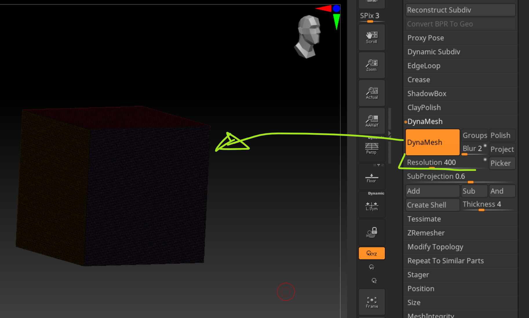

  1. Bevel Pro on Dynamesh
    All I did, take a low-poly cube and Dynamesh the low-poly cube.
Of course Polygroups have been assigned.

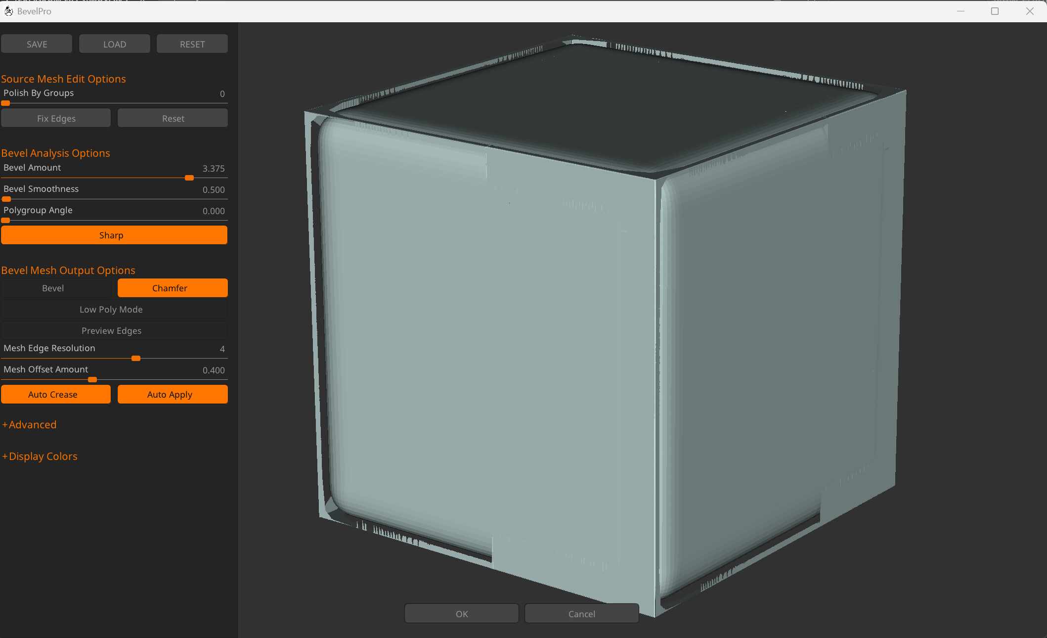

Now if someone can use BevelPro on this mesh, and get’s a clean Bevel. I will call you a Wizard.
Sorry folks, but it’s not working.
