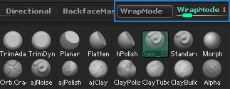

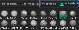

At the moment unfortunately the button switch doesn’t work as I would like.
The button status (ON/OFF) doesn’t update when I change brush.
Lets say that I am using the Standard brush and I enable the WrapMode using my script (the button turns ON), then I change brush, but the button remains ON (instead should turn OFF because that other brush has WrapMode set to = at the moment).
The problem is that I cannot figure out a way to update the button switch status according to each brush I select.

So I think that the “intermidiate” solution I found is the best one: I created a simple button (not a switch) and I placed it in the interface near the WrapMode slider, so to be able to tell if each brush has the WrapMode to 0 or 1. :slight_smile:
well marcus, many thanks again for the help! :wink:

, I added the [IFreeze,…] command to the script and seem to work well.
The update of the brushes instantly happens without updating the interface (definitely faster the before, where was obvious that was setting brush after brush) .
The big downside is that now is not clear if Zbrush did something or not (or at least is not that apparent). :laughing:
Luckily I have the WrapMode slider near the brush pallets so it’s easy to see if the WrapMode of the selected brush has been changed or not.

Hi < Ash >,
Sorry about the delay. I had a look at it last weekend but for some reason, the code I imagined would work simply did not.
Hey Mark, don’t worry, there was not rush at all, besides, the script that you previously helped me to develop works great: whenever I am scultping a tilable texture now I can easily tweak all the brushes I need in once click ! As to say: I was already pretty happy with the previous result. :wink:
So many thanks for looking into it furthermore: I admit that being able to have also a couple of smooth and masking brushes affected by the WrapMode script would be pretty awesome).
Your script looks great: I don’t think that the fact to be able to hold any modifier key while running the script would matter (does it?). In the end as long as it sets the WrapMode value for the hardcoded brushes is all right.
Pretty interesting the trick to define the “type of brush” !
I will give a shot to the script tomorrow to see how it works. :smiley:
That said, many thanks again for taking the time to solve this issue for me ! :slight_smile:
