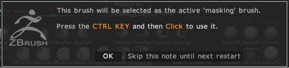

It matters in that ZBrush will tell you (possibly for each masking/smoothing brush) “This brush will be selected as the active ‘masking’ brush.” and then ask you to press OK or skip this note until next restart.
Not a big problem, just an inconvenience. With some earlier code it did fail for me, were holding SHIFT would select the main brush, i.e no change.

the active ‘masking’ brush." and then ask you to press OK or skip this note until next restart.
Ahhhh understood: now I know which message you’re talking about. “THE” silly message that I use to dismiss until the end of the session every time (I would really like that Pixologic would give us the opportunity to turn off that message. :laughing:
Btw not a big deal: after dismissing the first warning (until the end of the session) the rest should be fine. :wink:

That’s great! Glad you are happy with it.
The ZBrush warning message is only displayed if you hold SHIFT or CTRL when you press your WrapMode Main Brushes button.
