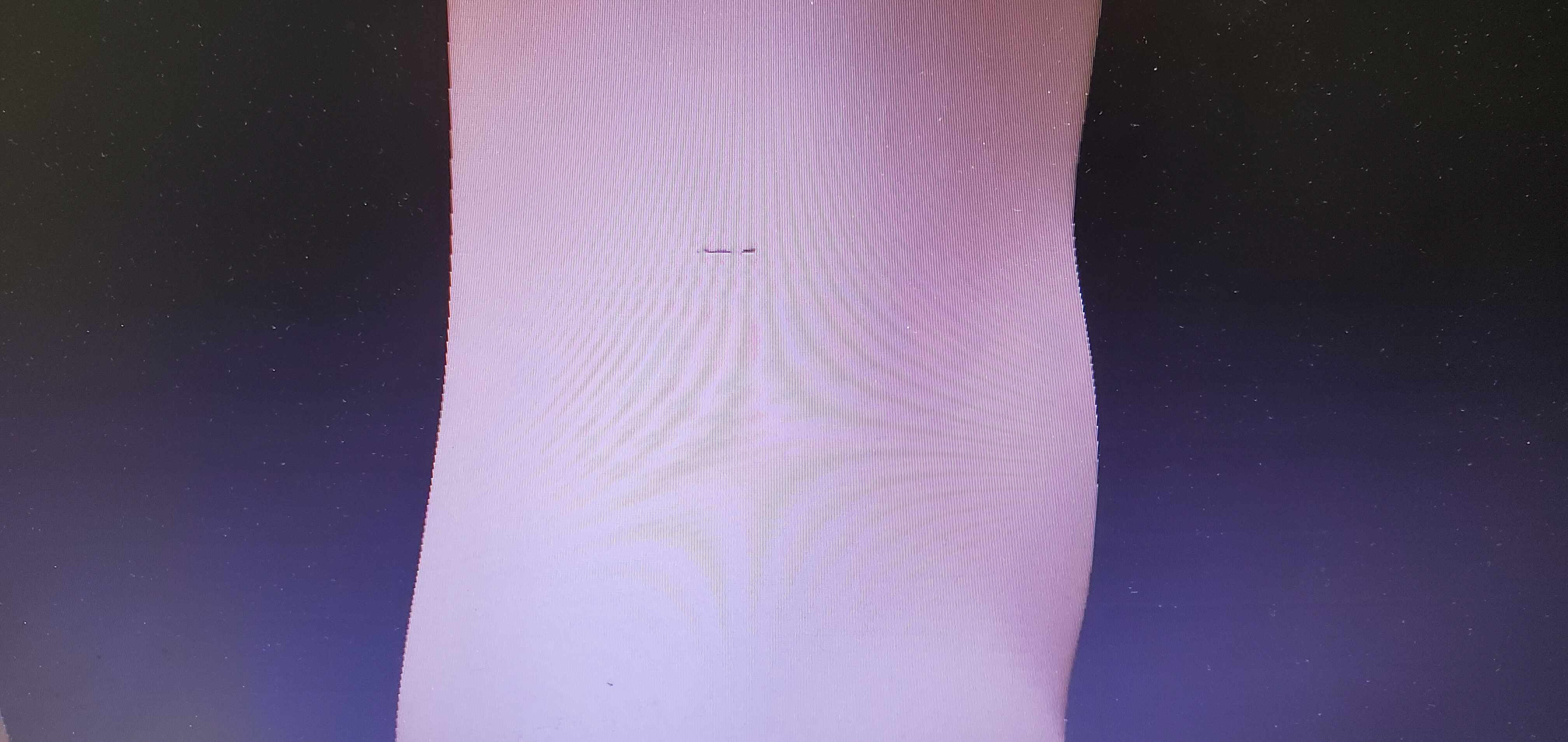

After remesher model and project details, my model’s line and hole issue begin to appear. I notice it could be resolution gap, but after i tried to fix at low divide, issue still there.
How can I fix this issue?
Thanks.
Thanks.
Hi @John_Tsai ,
Unlike Dynamesh, ZRemesher does not close holes or fuse any geometry. If the mesh has holes they will still be there after ZRemeshing, and this can cause localized issues with the mesh in that area because it complicates the topology ZRemesher has to draw.
In this case I can clearly see the holes or some sort of defect in the mesh in your “before” image, and this is likely to be what is causing the results in your “after” image.
If they are simply holes in the mesh you can use Geometry> Modify Topology> Close Holes to close them up prior to ZRemeshing. If there is some deeper problem with the geometry in that areas you would need to deal with that.
