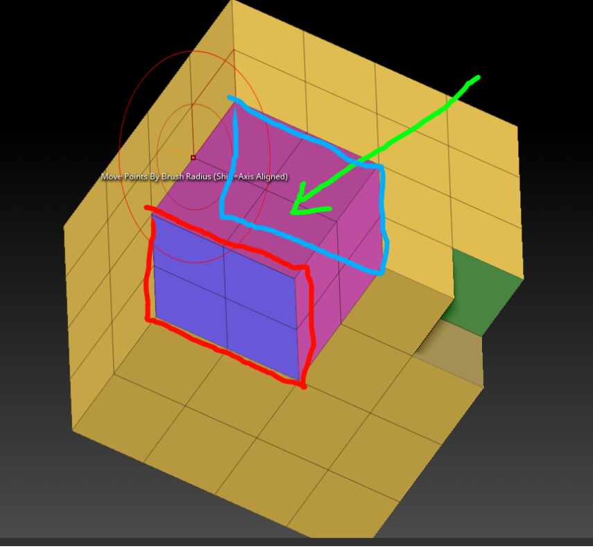

  1. how do i get a group of flat surface to move a cube distance back?
    for example :
    if i get a single face to move back, it was working.
However, if i get a group of faces to move, i got some distortion.
how to overcome this without painstakingly moving the qmesh to the next lower level?
I need to push back a single face or a group of faces in a single mouse move. Can that be done instead of tapping on the faces again and again to repeat that action?

If all of the polys you are trying to push inward have reference edges to snap to, then yes, you can move them all at the same time. The reason why you cant do this with some of the polys in your scenario, is that the inner polygons have no interior edges to snap to. If you were to isolate the 4 interior polygons on the face of that cube and attempt to push them in, the only edges QMesh sees to snap to are on the other side of the cube. You would have to collapse the polygons in an order that provides an edge for subsequent polygons to snap to.

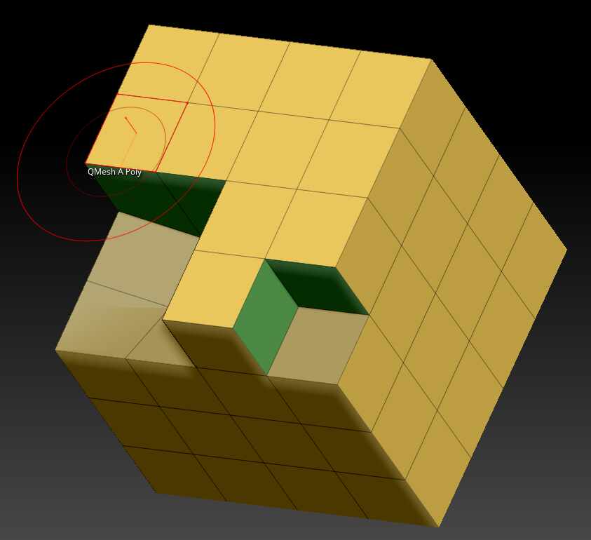

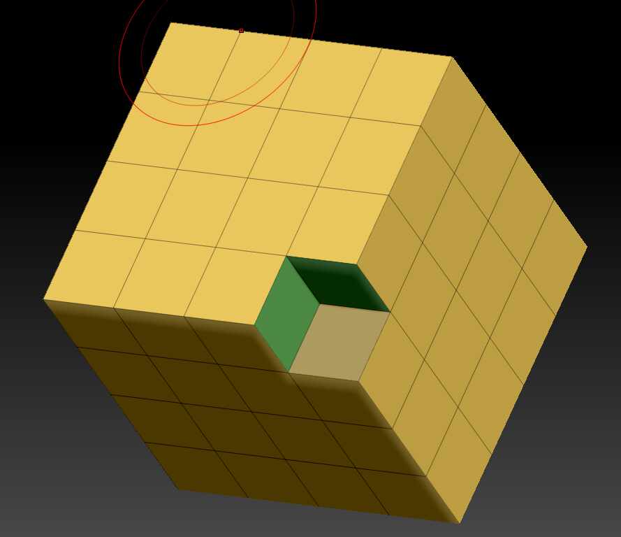

So in the following example, I have Qmeshed a single polygon on the edge of the cube where it has clear edges to snap to. This creates very even, expected results. If you simply click on any other polygons where the same conditions are true, it will collapse them to the same depth. In this case, I can select the entire ring of edge polygons and collapse them to the same depth with a single click. However, if I try to include those interior polygons at this point, QMesh won’t have edges to reference for all the polygons, and your results will be uneven.
This leaves a cluster of 4 polygons in the center. Try to collapse them all at once and it wont work, but three of the polygons can be collapsed cleanly, creating a reference for the final polygon to snap to.
