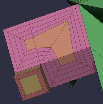

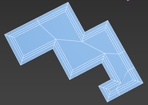

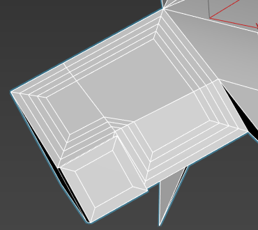

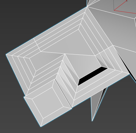

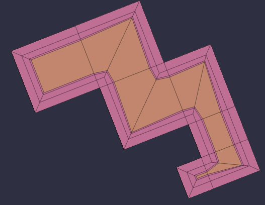

What is doing Zbrush is a not good implementation of the inset.
This is what Max does, that is OK in planar models but not in not planar
With the Miauu script Inset Pro with edge constrain active and with-wihout quads option and works the same with planar and not planar models. It keeps the same distances.
