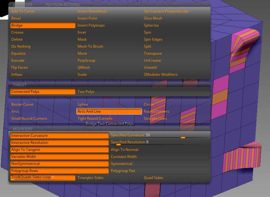

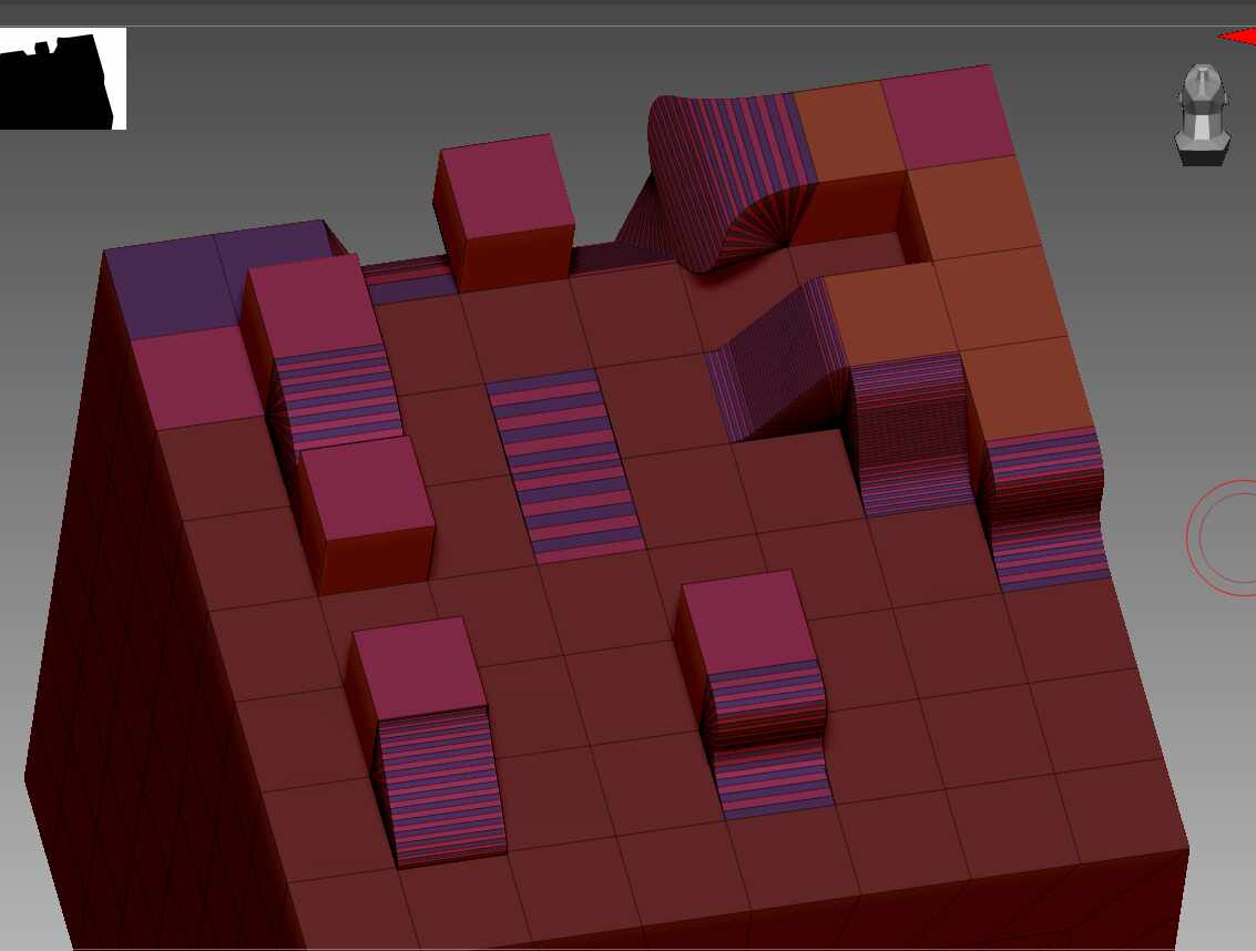

Attempting to bridge two connected poly’s does not create arc. The poly’s are connected but the connection remains flat to surface - UNLESS I attempt where one of the poly’s is located at an edge then it sort of works. Two images below show my settings and the various results I have been getting. This is very frustrating. I have used this successfully in the past and now it is not working. Any help?

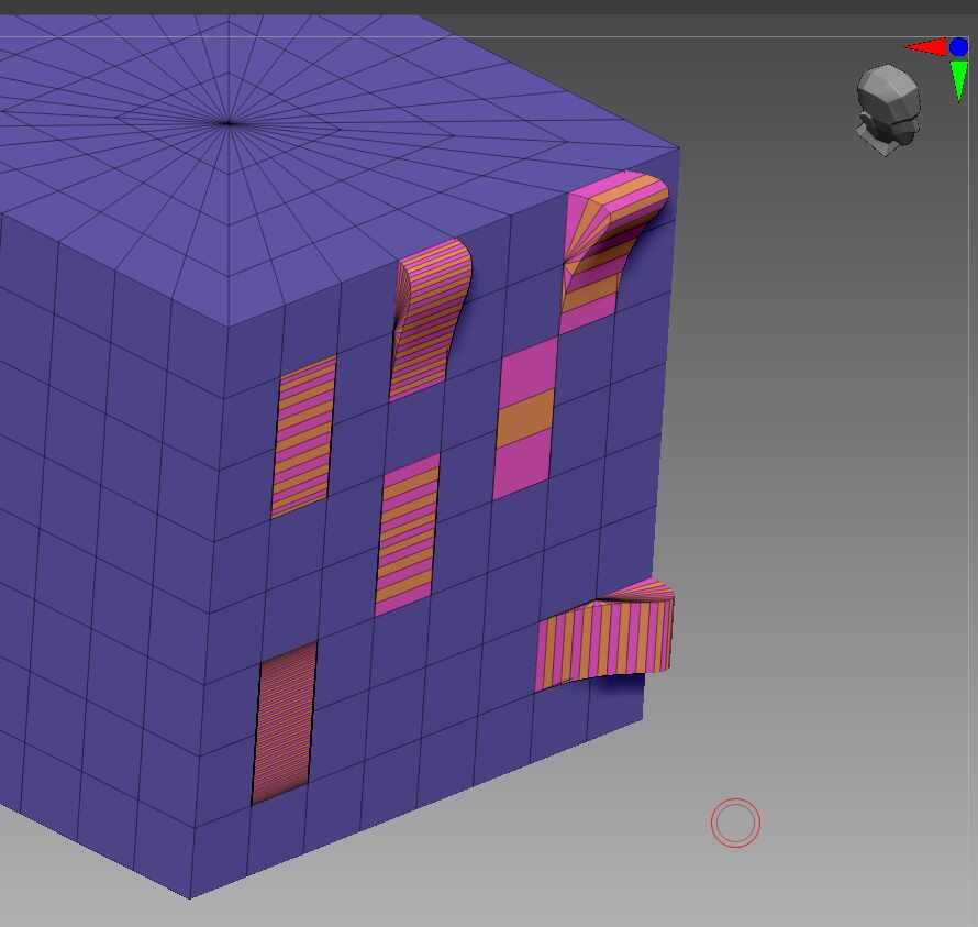

[Edited to add screenshot showing what happens when I try to bridge to poly’s at 90 degrees to each other. NO option will produce a nice curved arch.]

I get the same thing. It looks like it’s inverting the procedure somehow and it’s also doing it in version 2021.5. I think you will have to let Pixologic Support know so that they are aware of it. You can include a link to this topic.

Align to Tangent is active. Please switch on “Align to Normal” and see if it addresses your issue.
Thank you!

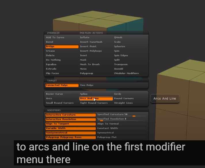

Well, what do you know - it worked… That is very surprising since I normally never even touch those boxes AND when I was looking through videos trying to solve this I came across the below video from Joseph Drust and you can clearly see that the bottom boxes are left at their default settings, including the Align to Tangent!
Thanks ! @Spyndel :+1:
@lensman888 ,
The geometry Jospeh was working with in that video will perform that way with tangent active. A cube with > 4 polygons on a side will not.
