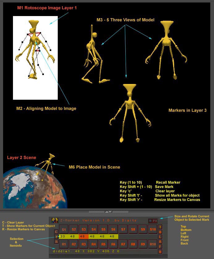

[Zmarkerinfo.JPG]
As an exercise I decided to update some old functionality that my original Digit Widgets scripts had storing and recalling Zbrush objects. ZMarker will allow you to Save and Recall Object properties of a ZBrush Model such as Postion, Size, Rotation, Material and Texture. In addition, if the user changes the Canvas size during the workflow, Zmarker will scale each Marker to fit the new canvas.

The Interface
Press SHIFT + “m” to load the Zscript from the Digit Widget Plugin Pallete.
You can save and recall 10 markers.
Press Shift + “1 to 0” (0 = 10) to save a object’s Position, Rotation, Size, Material and Texture
Press “1 to 0” (0 = 10) to recall Saved Model
Press “c” to clear the layer
Press “t” to show all Markers that the currently selected object is used (indicator turns light blue)
Press “r” to Scale all Markers to the Current Canvas Size. (use this after changing the Canvas Size)

As an Example to set up the script to using images for reference.
** Good idea to use a separate layer to protect any other layers you don’t want to erase
  1. Select 3D Plane and draw it on canvas
  2. Select Flat Material and a Image texture that you want to use as a reference
  3. Size and position it on the canvas. Move it to the back of the canvas Z depth so that it will appear behind anything else you draw on the screen.
  4. Save it pressing SHIFT ‘1’ to save marker one.
  5. Load a different Texture to the same plane (say a side view) and Press SHIFT ‘2’
  6. Now we can shift between 2 views by pressing “1” and “2” (press “c” between to clear layer)
  7. Leaving Marker 1 texture on the screen draw and position your model referencing the image
  8. Save this view by pressing SHIFT '3"
  9. Press “c” (clear) and “2” to bring up 2nd reference
  10. draw and position your model referencing the image
  11. Save this view by pressing SHIFT ‘4’
Now we can use this simple Rotoscoping setup up to alternate between Marker 1 and Marker 3 for Reference #1 and Marker 2 and Marker 4 to use Reference #2.
Press “c” to clear layer
Press “1” to load reference
press “3” to load Model
press “c” to clear layer
press “2” to load reference
Press “4” to load Model
you could also leave all references on the canvas by positioning the textures on a different layer and selecting the model markers in a separate layer.
Use the same method to use the script in different ways according to need, such as 4 model views with/without reference textures.
