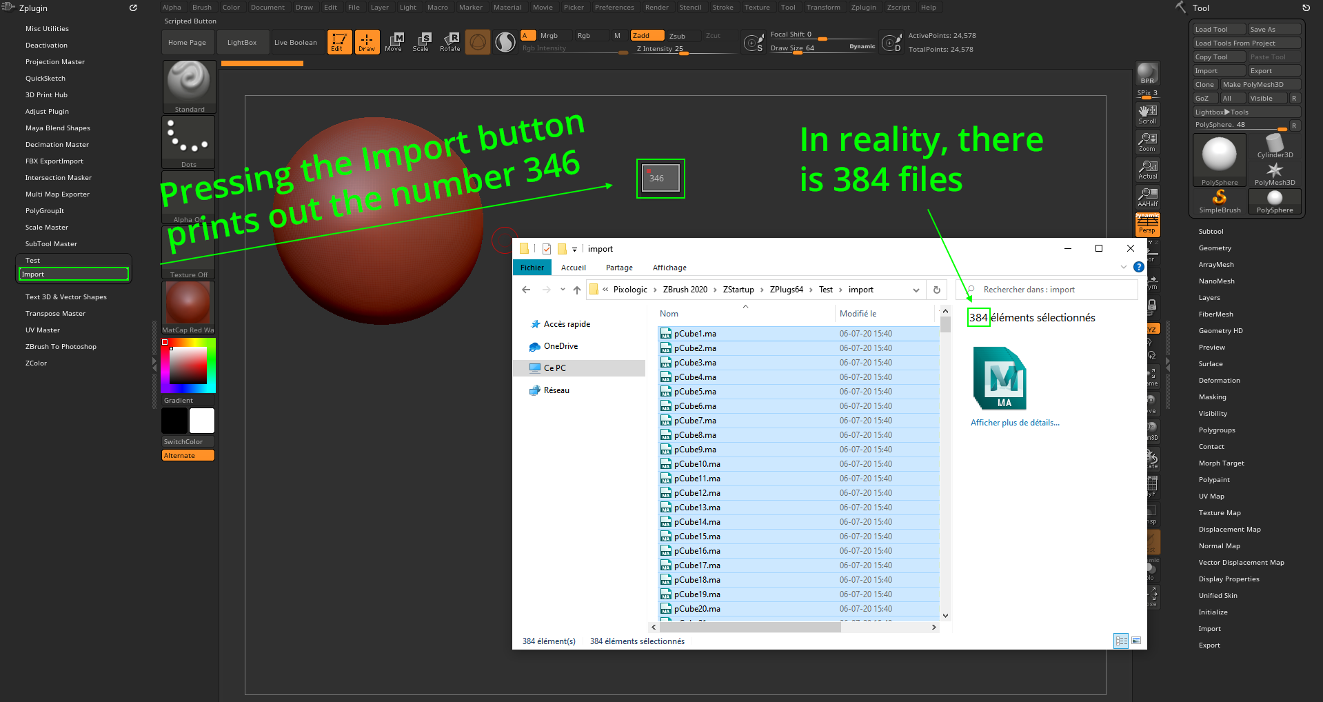

I have an issue using the “GetFileNumber” command from ZFileUtils.dll that I downloaded from ZBrush Docs
When I use the command on a folder that contains a very large number of files, it just doesn’t return the right number.
I made a test script that will print the number of files in a specific “import” folder and as you can see in the attached screenshot, the script prints out the number 346 even though the folder actually contains 384 files.

Hi Gabriel,
I’m sorry not to reply sooner.
I think this is a limitation of the ZFileUtils, caused by the memory buffer running out of space to store more file names. (If you had shorter file names you’d get a few more files!)
The ZFileUtils will need updating to be able to cope with more files. I will take a look just as soon as I can.
-Marcus
