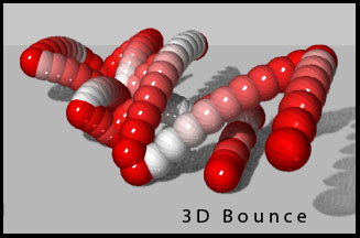

Here is the next version. Now you can bounce in 3d. Just turn on Zwalls in the Zwall menu and you are ready. You can build an object out of it with “MarkIt” and then then move the whole thing around. I have posted a sample image below.
Thanks again for all the input
