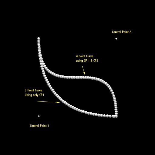

:warning: Update 6/23/05 Version 1.1 :warning:
Added 3 Point Curve selectable in the Settings Menu
Using the 4 Point Curve is a typical Bezier function
Using the 3 Point Curve can create more elliptical or oval curves.

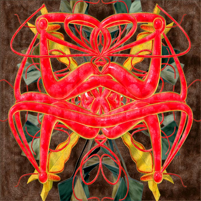

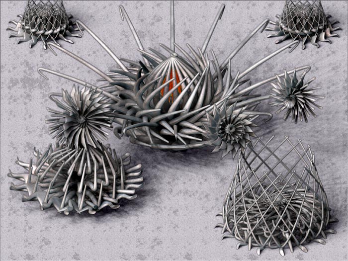

Here are some doodles I created while testing the script that I thought looked pretty cool, feel free to add.

Updated the script to version 1.1, you now have the choice of a 3 or 4 point curve to play with. See the attached image.

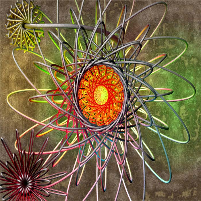

attached is another testing experiment.
