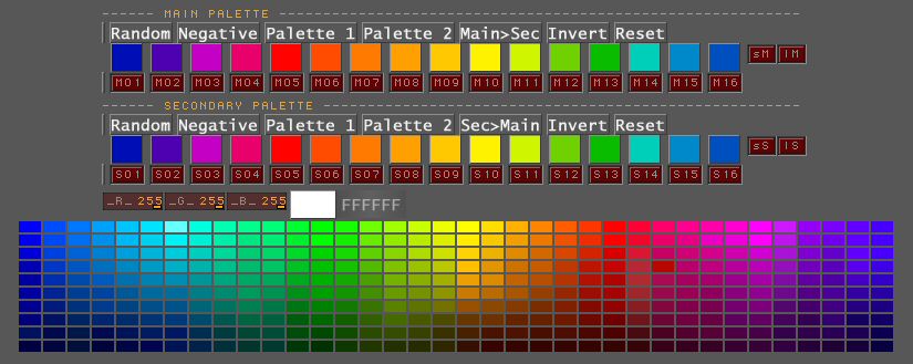

Hi all,
this script is a wip…
I wish to add some heuristic to choice colors…
Complementary, Triadic, hue shift, etc…
I’m looking for some reference on internet. Can you help me?
Where is Pilou ? :wink:
…Download and run it…
Please, notify me any error.
121 requested.
Ciao
cameyo

Hi Cameyo,
I tried the script and like where it goes so far… I had three things to say:
  1. For some reason when I press the buttons to store color on the secondary palette, I get a save dialog instead. Maybe it’s just me.
  2. Second thing is an idea about implementation that I might have done differently. See what you think. Each time I choose any of the process buttons a popup asks me to confirm the operation. That can get annoying after a short while.
Another way to approach it might be to just do what the button says immediately whether it be generate a random palette, generate a monochromatic progression of the current color or whatever… The user would see the effect right away. I would simply add an undo button which would restore to the palette to its previous state. That way the buttons are direct actions… and the user will only rarely need to take back what they did. Internally it means a little extra copying into a temporary array I guess.
BTW, I think I have code that transforms from RGB to HSV and back if you are interested. Kokoro’s suggestion for HSV color mixing might be a neat option.

i just tried the script, cameyo:) it works wonderfully and all functions as i expected :slight_smile: thanks again for making for me z1.55b version :slight_smile:
as svengali said already, i too would prefer, if thats not too complicated with programming, have that the buttons act immediately instead of asking again if they should do this …
and an idea, which is influnenced by that i often use photoshop layers to colorcorrect or also to unify an image colorwise … namely, say i have made palette1 with colors i want. now i try them out, and see i want all of those colors say a little more to the red to make mood in image more warm … would it be possible that user has additional field where he can stor a red, and then click a button saying “multiply” or “overlay” or “rotate hue towards that red” … ? (or even more adventurous with a slider which lets user determine influence of red … :wink: ) …just idea
anyway, as this script is, i already really like it, and is help for me painting in zbrush.
i like in particular that i can store palettes, this gives good way to try out lots of variations :slight_smile:

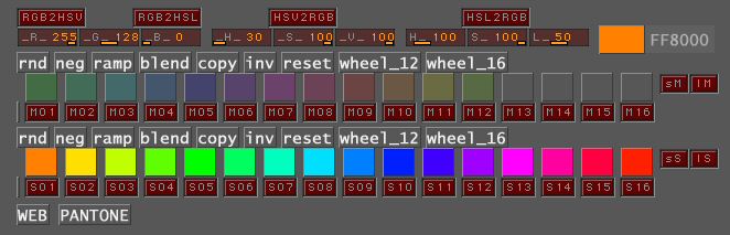

Latest version…
I’m working on:
  • HSL, HSV sliders color space
  • Color wheel (12 colors)
  • Triadic, opposite, complement colors, etc.
  • Web Palette, Pantone Palette, etc.
Thank you for viewing
cameyo
p.s. to select the color on palette you must move the mouse over the color and press ‘c’.

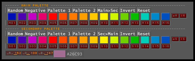

here is a new version of ZColor:
There are some small bug, but we now how to remove it :smiley:
This script is written by me and by Marcus Civis, i’m happy to work with another scripter and a very good boy.
Post your hints.
Have a good color choice.
cameyo and Marcus Civis

Here’s a few script lines for a TINT button that modifies the Main palette by the current color: It adds more tint to the palette each time you press the button.
I inserted it in your code just after the wheel_16 button (both for Main and Secondary palettes)
// BEGIN TINT Main palette colors
[VarDef,TintPercent,256/20] // sets the degree of tinting
[PenMove,4]
[SectionBegin,“tint”,0,“Tint Main colors by current color”,
// OPEN COMMANDS
[iUnPress,0]
[VarSet,RR,[IGet,Color:R]]
[VarSet,GG,[IGet,Color:G]]
[VarSet,BB,[IGet,Color:B]]
[VarSet,i,0]
[Loop,16,
[VarInc,i]
[VarSet,MColorR(i),MColorR(i)+(RR-MColorR(i)/TintPercent)]
[VarSet,MColorG(i),MColorG(i)+(GG-MColorG(i)/TintPercent)]
[VarSet,MColorB(i),MColorB(i)+(BB-MColorB(i)/TintPercent)]
// CLOSE COMMANDS
[iUnPress,0],
[SectionEnd]
// END TINT main palette colors
Sven
