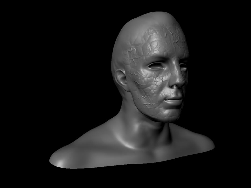

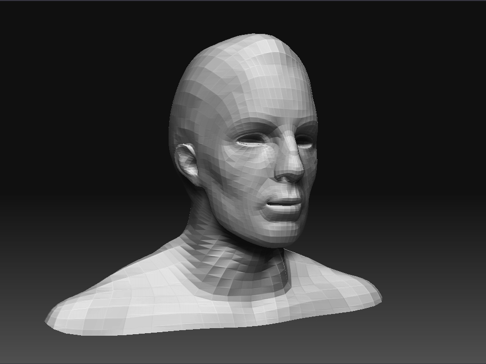

Here are the renders
The model after it was taken into Z2, had its subdiv level reconstructed, then rendered in maya with Alpha Gain = 2.2 and Alpha Offset = -1.1
A few things occured to me while doing the renders;
-The model from Z2 would not retain the exactly the same detail as in Z3.
-Multidisplacement exports RGB.tif and the default displacement from Z3 is indexed (which I could of changed in photoshop but I chose not to because the models I used originally had indexed maps)
-I am using the Demohead which I took into maya at its lowest level, gave it automatic UVs, postioned it, then exported to Z3 and subdivided it up to 6subdiv levels and applied a few simply stamps to.
When I get around to making a tut I will use one of my models. I posted the method because it worked for me and was a more organic (non linear) approach to using Z3 in a production environment.
I hope this helps you in acheving similar results.

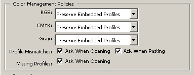

Convert a file only works well on RGB documents.
Follow these steps
  1. goto your color setting inside photoshop and put a check mark in the following boxes
    [step-1.jpg](javascript:zb_insimg(‘64768’,‘step-1.jpg’,1,0))
    2.open the document and choose leave color alone
  2. goto Image/Mode/RGB
  3. save as a tif
When you drag it on the convertfile.bat It will now convert correctly.
It worked good in Z2 because the Disp Exporter Plugin exports RGB Not Grayscale;)

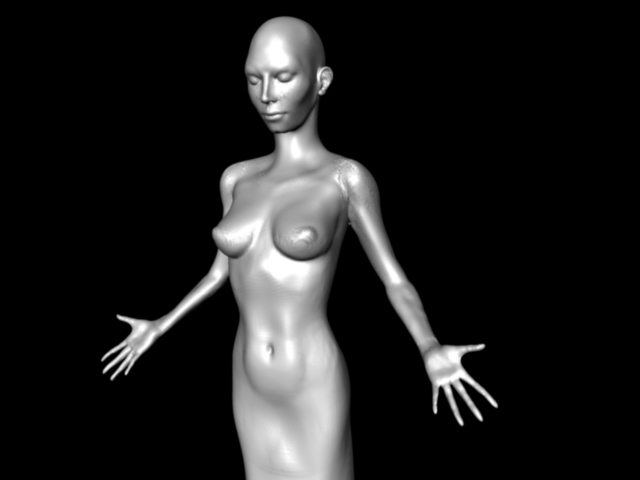

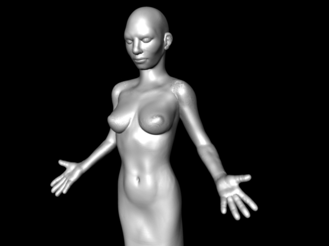

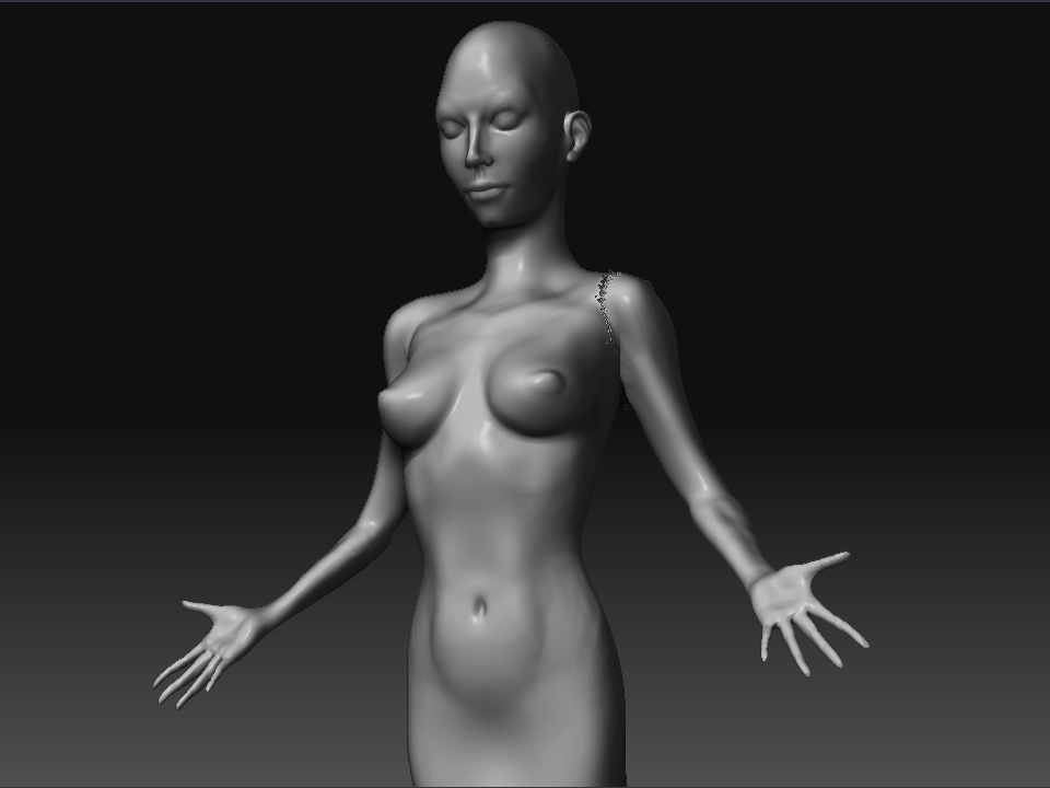

Here is a WIP model I have applied my workaround to using the same settings in Maya (mental ray) but changing the .map file from Grayscale 16bit (straight from Z3) and then converting to .map, and using the photoshop adjusted RGB then convert to .map technique.
The aim was to trial my method using the RGB photoshop trick.
The settings I used in photoshop were as “cannedmushrooms” provided but the results are a severe bloating in the render, where as the grayscale worked fine.
In the spirit of sportsmanship I will venture that my method does work with the RGB converted disp.map files.
However I will add using an RGB file for displacement in maya ( without the equivilant Dispexporter plugin for Z3 which Z2 had) has never in my opinion given satisfactory/accurate results and leads to a painful experience.
I answer to your question;
[i]“So, also you did not mention, If in fact I need to use both Types of Mentalray Subdiv Approx node. Displacement Tesselation and Subdivisions. Or is it only necessary to just use the Subdivision Attribute? Up until now I have been applying both. Is this not the right thing to do?”
[/i]You only need to use the Subdiv Approx node, which is what I use.
If you really want to use both you can, which may result in a higher quality displacement (render) but would be overkill considering for such fine detail a normal map would be fine and save you time and optimise CPU performance.
The first image is the Z3 high rez model
The second is a maya render using my method
The third is a maya render using my method but substituting the grayscale for the RGB
Note: The artifacts around the shoulders are due to the sculpt in Z3 (transpose tool) not related to maya, after all its a WIP.
Hope this helps and fuels more debate

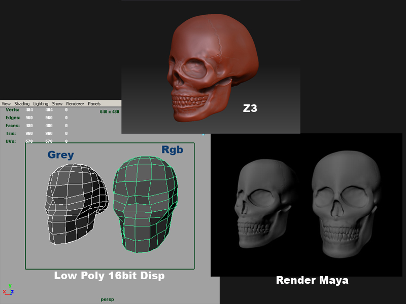

Also You only have to convert to a MAP if you have a 32bit 16 bit will render as a tif. But when it all comes down to it the less you fiddle with your maps in the conversion process the better they will turn out.
Only reason I had him do the photoshop trick was because he was having trouble with the convertfile.bat
lol guess I should have mentioned that gem huh;)
But I will post a couple really cool sample scenes that you can look at.
This one is sort of my prize collection
Link: Here
And this one has a Grey Scale and RGB 16bit Z3(which isnt the best at making disp) same settings for everything else, you will find no change with the rgb or grey. in the render.
