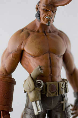

or if you really hate UV… you should let me make it in plastic for you and have it painted. i make figures in plastic the same price it costs to print on zcorp… cheaper sometimes.
[3418891398_8997b3b8c4.jpg]
Painting looks WAY better than the color 3D print…

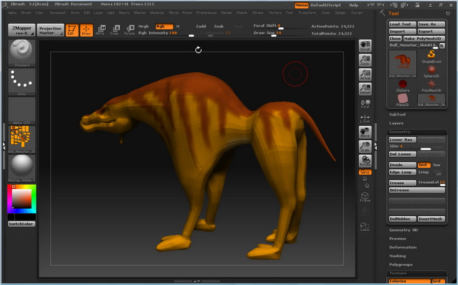

Okay, my coworkers have sunday off so I had to figure it out myself. It’s really easy, that’s why ZBrush is great.
  So.. to do UV's, Polypaint, and exporting for ZCorp printing, you need to first have UV's for your mesh.  I always do this in Maya because Maya and 3DSMax have a better interface for creating UV's.  But it's completely a waste of your time to use Maya or Max if you're only using ZBrush to 3D Print stuff.
  Since you're from a architecture background and used to point click interfaces, you need to understand that UV's are coordinates that tell a 3d program how to take a 2D picture (texture) and draw it onto a 3d object.  This is a lot like latitude and longitude used for locations on the earth, maps are 2D and the earth is a flattened sphere right?   So when 3d artists say "unwrapping UV", what they're talking about is how to cut up your 3d model into a flat piece of paper that you can draw your textures onto and glue back on.
  ZBrush makes creating UV's and exporting textures from Polypaint very easy.  You don't need maya or max.  First you need to create your mesh.  Do it with ZSpheres in ZBrush or boxmodel in Maya/Max.  Once you have your base mesh (I assume you know how to 'make polymesh3d'), you can start painting on your object.  Make sure 'colorize' is enabled in the texture menu, and paint away (with RGB turned on and ZADD/ZSUB turned off).
  When you're done painting.  Now its time to export to obj.  Here come the UV's.  Bring your mesh back down to subdivision level 1.  And in the texture menu, click GUVTiles.  This will automatically create good enough UV's on your model for 3d printing.
  The difference between GUVTiles and AUVTiles is that GUV puts UV's on your model that are all the same size.  AUV will put UV's on your model that are different sizes so maybe there are less artifacts.  GUV is simpler, so just go with that.  If you need UVp, UVs, UVc.. do it in maya/max.. zbrush is not good for that because the interface to fix and see your UV's isn't ready yet.<span class="font2">
  Now go back up to your highest SubD.  Make sure RGB intensity is 100.  Someone told me that your color should be black too.  Then hit the Col&gt;Txr button in the Texture menu.  This will create a texture from your Polypaint.
  Almost done, just need to save out.  Save your OBJ out with the export menu.  If you enable the Txr button, it will automatically save your texture out too.

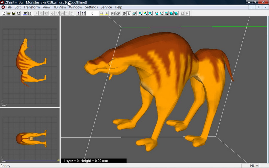

  Now all you need to do is open up the OBJ in Maya and convert to WRL for printing on ZCorp.  Don't forget to flip your texture image upside-down in photoshop because ZBrush writes alphas and textures out that way.  If you don't, your texture will be messed up in Maya.
  Summary:
  1) Polypaint your mesh in Zbrush by drawing directly on your mesh with only RGB turned on, make sure 'colorize' is enabled in Texture menu too.
  2) Create UV's in lowest subD by hitting GUVTiles in Texture Menu.
  3) To convert Polypaint to Texture, make sure RGB Intensity is 100 and color is black, go to the highest subD of your mesh, then hit Col&gt;Txr in Texture menu.
  4) Write your obj and texture out.  Flip the texture upsidedown in photoshop.
  5) Convert obj to wrl
  6) 3D Print!

u are an amazing man! I follow your step, paint my model and creat a .obj, a .mtl & a .bmp file using zbrush, then flip the bmp upside down in photoshop, remapping the bmp to the obj in rhino (not maya, because I am not familiar with maya), export it to a vrml file, and import it to ZPrint (a ZCorp’s printing software), it looks fine!!!

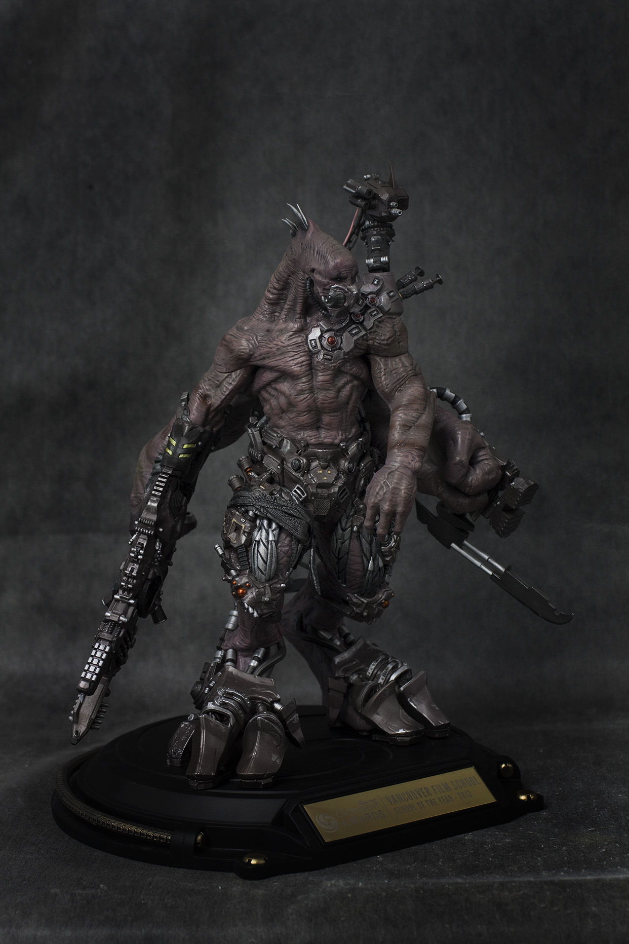

Something a 3d printer can’t do for the forseable feature is rival a good paint job with an airbrush/paintbrush. It’s because in toy art, it’s about a lot more than pigment at a certain spot. You have to consider gloss, texture, as well as pigment, and multiple transparent layers (as in subsurface scattering).
For instance, an oil painting is actually a 3d work. The way the artist puts the oils on the canvas and moves it around. The shape of the dried paint. Now compare that to a digital copy of the painting that is printed onto a canvas. If you see both in person there’s no comparison which one is better.
